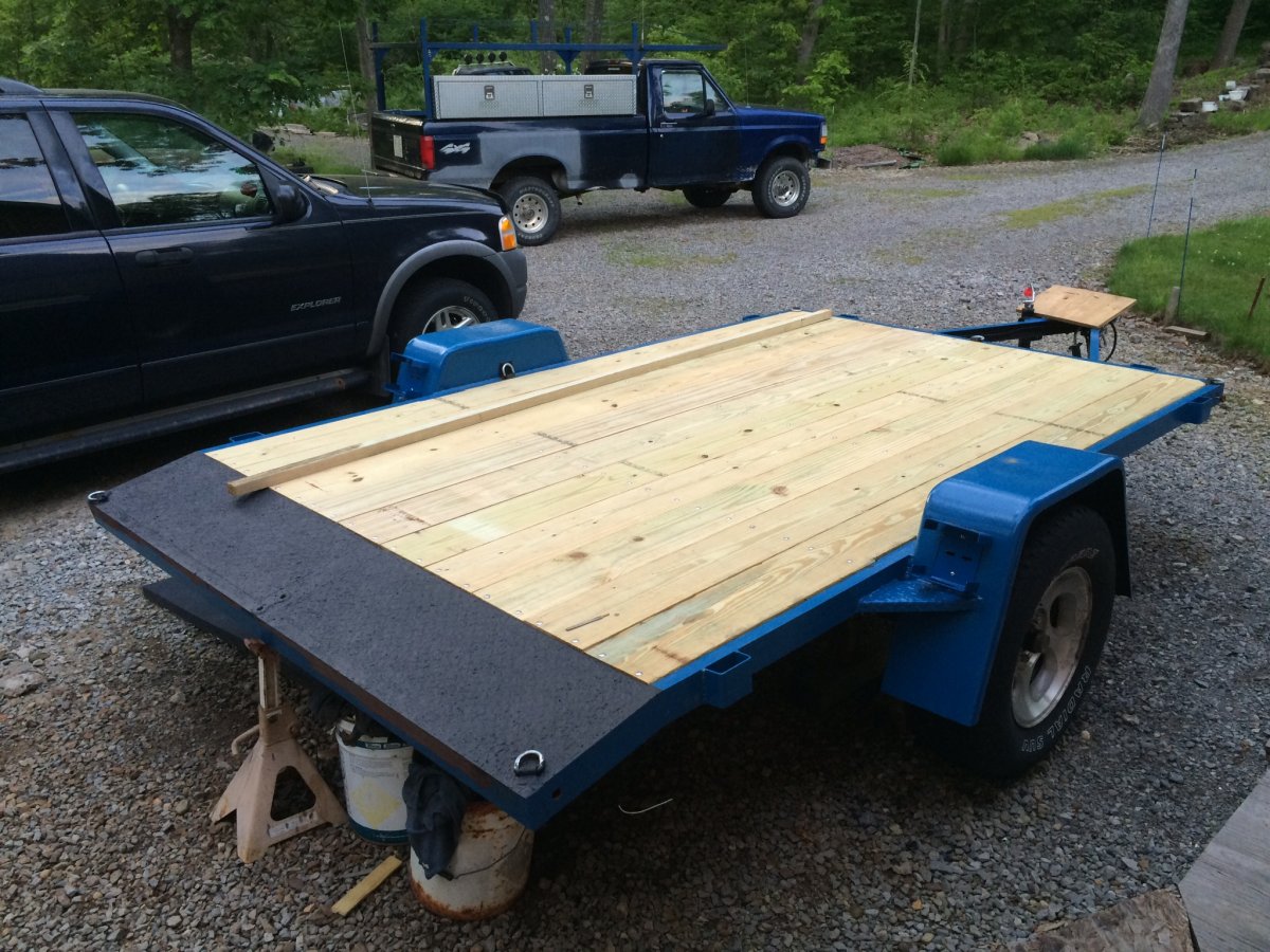

We (myself and my dad) bought a small home built trailer that was titled and all for cheap and we knew it needed a patch or two. When I got to poking at it after we got it home, the entire box frame was rotted to junk. Dad wanted to know what to do and if we got screwed but we paid less for it than the axle, springs and title would have cost and all of that was in good shape, it was just the frame.
I got a few sticks of steel, new fenders, LED lights, hitch and tongue jack and went to work. 6.5’x10’ deck (the original deck was like 6’3” but the axle was built for a 6’6” so that’s what it got) and I added a 1’ beaver tail to the end. So it’s pretty close to the original size. I used the big equipment trailer dad has as a rough guide for my design since it’s also a C channel frame. Set the fenders so they only poke up like 4 or 5” above the deck (really wanted to build a deck-over but that would have been really high), but I can build a platform with 2x6 or throw some 6x6 on the deck if I need to be able to clear the fenders for some reason. Put stake pockets down the sides and a bunch of D-rings. Put a ledge across the entire end of the trailer for hooking ramps on and made two ramps.
Tail lights went into protective metal boxes and all of the marker lights are flush mount LEDs. Still need to make something to store the ramps, a spare tire holder, tongue box and want to add some 2” winch straps.
I put an adjustable pintle ring on the front since I hate ball hitches. Mom’s Explorer had a Class 2 hitch from the factory though and nobody makes pintle mounts for those, so I also fabricated my own pintle mount for it.
