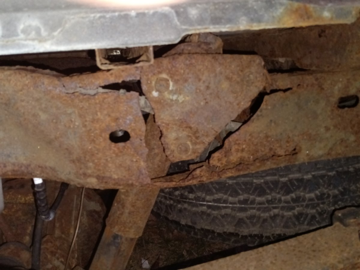

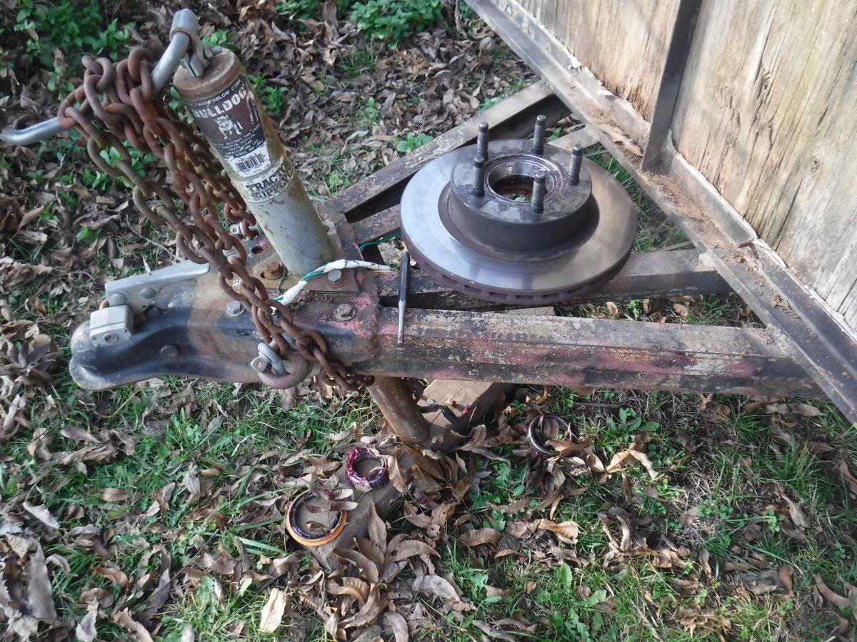

I have an opportunity to buy an '01 4X4 4.0L automatic Ranger with 170K for $400, however it has a cracked frame located right at the rear shock mount' drivers side. A friend who is an experienced body man said we could fix it by jacking it back in position and weld in some plates. I've attached a picture, I guess I'm looking for some feedback on feasibility , thanks in advance.
That is not just cracked, it's very rusted and thin. What does the rest of it look like? Nothing wrong with patching it, but how large is the patch going to have to be to get to solid metal?
I patched a f150 a long time ago. It had not cracked but was getting very thin in spots and the crossmembers were rusted through. I went to the junkyard and bought the rear half of a frame that was in good shape, they charged me $50. I took it home and drilled all those rivets and swapped the crossmembers, and while I was at it I cut about 24 inches of the frame rail off the good frame, and then cut the top off the frame rail. Originally the frame was a "C" I turned it into a "L" by cutting the top lip off. I then slipped this "L" piece of good frame into the thin "C" of the original frame. It fit perfectly in there since it was the same frame with the same bends. I didn't even have to weld it in place, I just had to ream all the rivet holes out a little bit, and when I bolted all the brackets and crossmembers back in place, that new piece was not going anywhere. That along with the rear receiver hitch bolts held it in place. After I painted it all up, you could hardly tell it was in there.
I don't see why you could not do the same to your truck, putting in a very long piece from a better frame to strengthen it up. You can paint it all up before you put it together with rustoleum if you are worried about rust getting inbetween the old frame and the new frame piece.
The rest of the frame isn't too bad, I'd probably have to weld in plates about 2 ft long. I thought about cutting a piece out of a parts truck I have but time might be an issue as I have no vehicle at the moment. We're pulling the bed off both trucks right now so mayby I'll check the parts truck frame out and replace the whole back end if it doesn't look too difficult. The parts truck is an 03 2wd 3.0 I'm not sure if the frame is the same.
If you go forward about 3', you will see where the front and rear sections of the frame were joined by 8 rivets per side. My recommendation - purchase a good rear section; remove box, springs, etc, remove rivets, install good new rear section using bolts (there is a Ford repair procedure that your body man should be aware of). Reinstall all the pieces.
Yes, more work and cost than welding some plates, but the right way to do it.
It takes me ~1/2 day to remove old section in wrecker's yard as some of the ideal tools aren't allowed (grinder). About the same to put back together - better tools, but I have to be more careful re-installing.​
@franklin2: Putting in "doubler" changes the strength of the frame over the section where you have multiple thickness, leading to stress concentrations. Stress concentrations can lead to unexpected failures, better to keep it the way Ford designed it. What you and I do on our trucks versus what we recommend to others are different - all that liability crap.
I would not touch that rusted out truck. Its only worth $400 if the engine and trans are good, and then only for the parts, imho.
FWIW the shock mount is kinda poorly designed to catch debris and moisture and hold it against the frame rail. Let it do that for 20 years and have a shock doing shock things to exert force against it...
That said yours isn't worth fixing, find a a better rear half.
I second the rear frame swap. I wouldn't think it would take much more time consuming then trying to rebuild that section of frame with patches. You are not going to simply glue some plate over that, there isn't enough meta to attach anything to. At the least I would think you would need to splice in a section of good frame rail, then weld it in with fish plates.
98+ Rangers had two piece frames. There were two rear sections that I’m aware of. Short bed (6’) and long bed (7’). They join at the front leaf spring hanger. Really not all that bad of a swap to do, I did it with my green 00 Ranger
BTW, there are certain things to pay attention to if welding a frame, like no sharp corners, they add stresses. Also pumping a lot of heat from welding at one time can start to warp a frame, so on bigger patches you really should take your time welding and cooling.
I didn't know the factory already had a splice, that would be the way to go.
Saying doubling up the frame to strengthen it where it's rusted and thin may cause "stress concentrations" is hogwash. Ford on their chassis/cab pickups "doubled up" the frame top and bottom on those trucks to strengthen the frame. Fish plating is also a frame doubling method used all the time for frame lengthening/shortening and frame repair.

Someone posted on here years ago a whole manual section on how to repair frames and I used that as a guide. Fish plating is the way to do it, or cap large sections.
