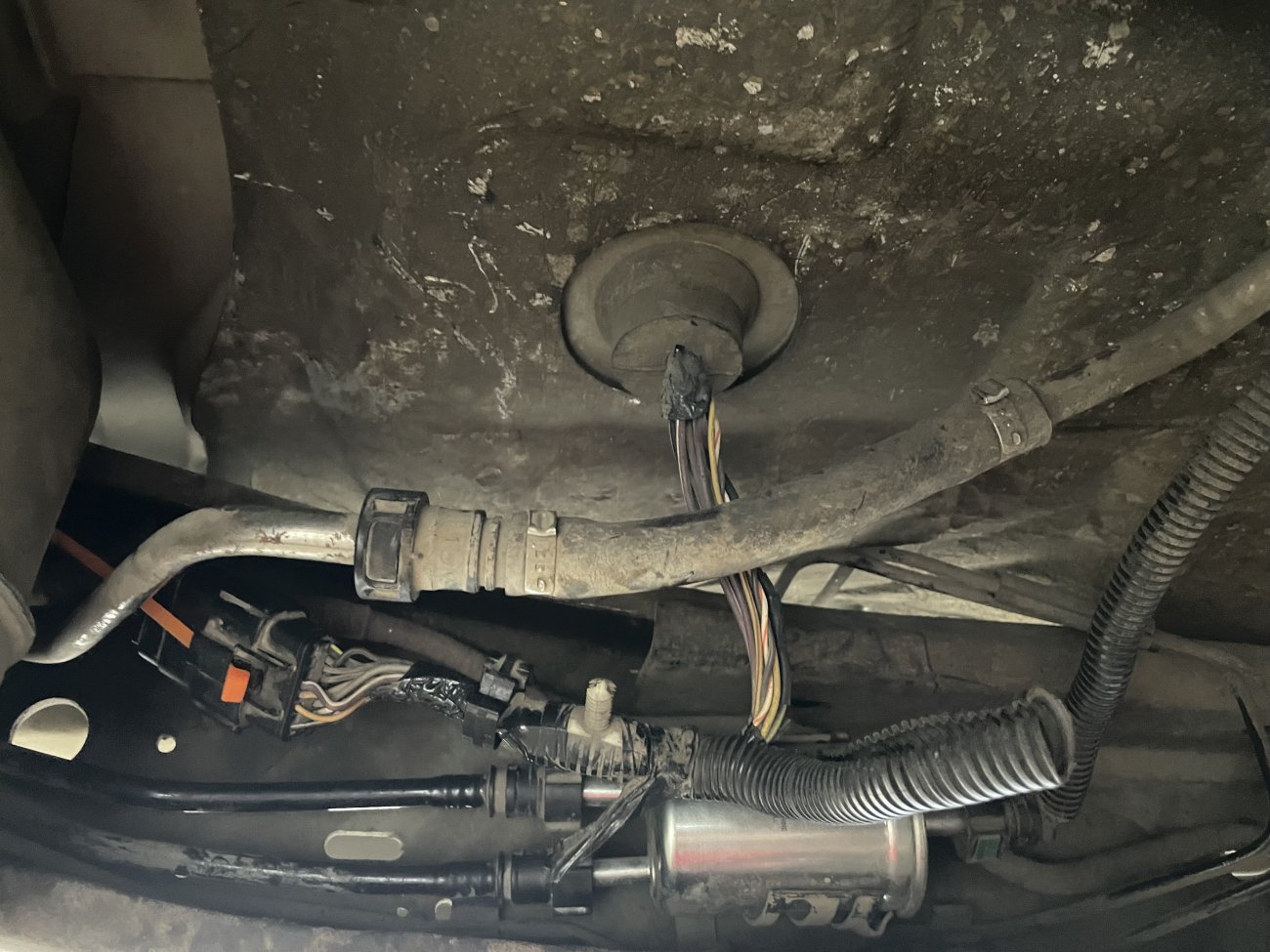

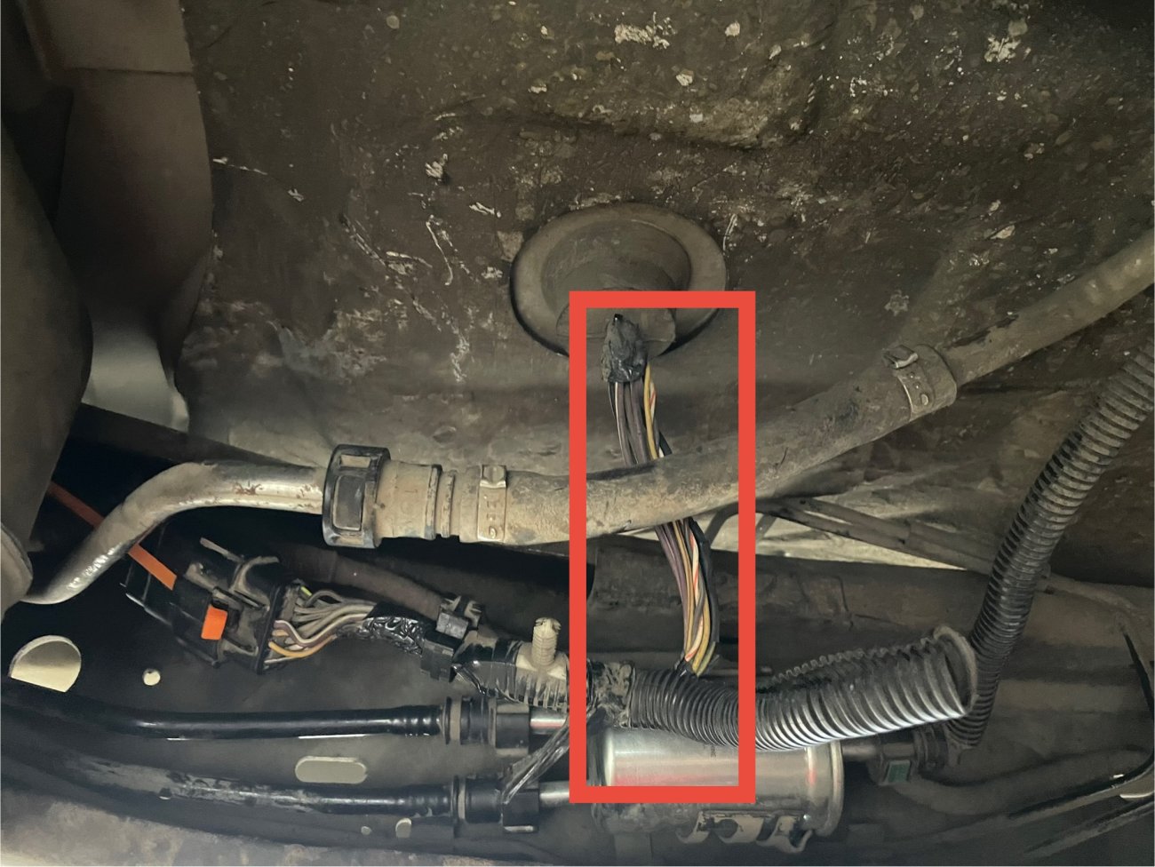

The picture shows where we replaced the ground wire. It’s black due to the heat shrink. Do you think it still could be a bad body or frame ground?

That... is not what I'm talking about. Other than the fact that if that ground was bad, the main grounds are probably bad.
The main grounds come off the negative battery post. There should be two or three. A big one (4 gauge) to the frame and to the block/starter plus a smaller one (usually about 10 gauge) to the body (usually the the core support right by the battery). Personally I use 4 gauge welding cable and make my own cables plus upgrade that smaller ground to 4 gauge welding cable. I make sure to clean where they attach well and use No-Alox (find it in the electrical section of a decent home improvement store) on the connections. No-Alox is electrically conductive and is used primarily to prevent corrosion where aluminum wires are terminated in electrical panels and outlets. Dielectric grease is not electrically conductive, but is good for insulating, preventing water intrusion and preventing corrosion.
Those main grounds are where all of the electric in the vehicle is returned to the battery, so they are very important and can cause all sorts of headaches when they're faulty. I've seen them corrode to junk inside the insulation to the point where outwardly the wire looks fine but it's really not passing much juice along.
