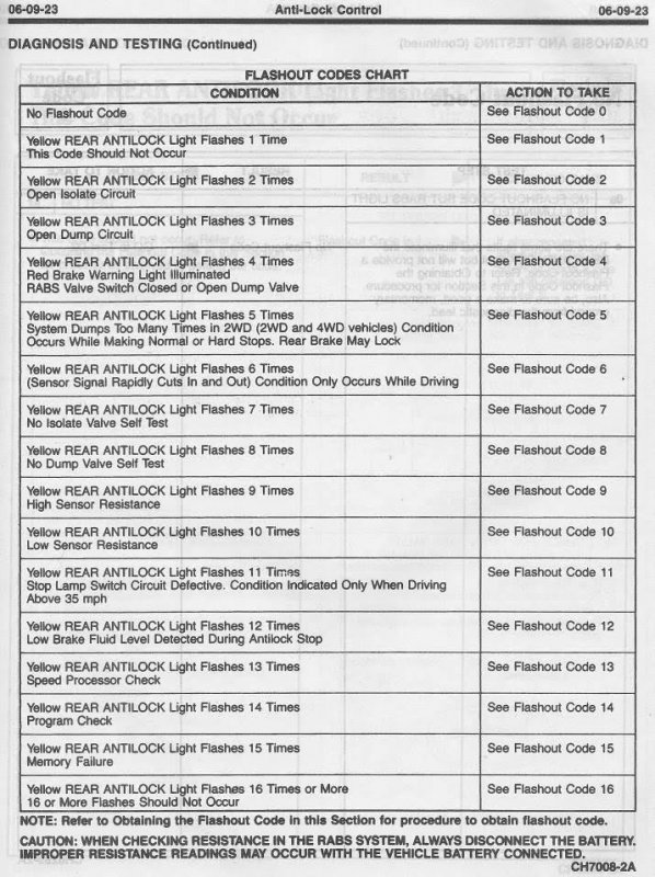

The fluid level switch and or the connector on the master cylinder is a big problem for parking brake and if I remember right the ABS light also. did you do the blink code?
No I haven't. I'll have to dig deep under the dash for the ABS test connector. How can I verify my master cylinder sensor went bad?

So i pulled a code 4, which relates to the abs hydraulic valve and the symptoms are also correct: brake light on and abs light on.
I recently put in a new remanufactured one from O'Reilly's but i read in the comments of the unit on their website that the wires had been switched. I measured the resistances between terminals and they weren't exactly the same as my original unit, but close. You think there's a way to reset the abs module to accept the new resistances?
