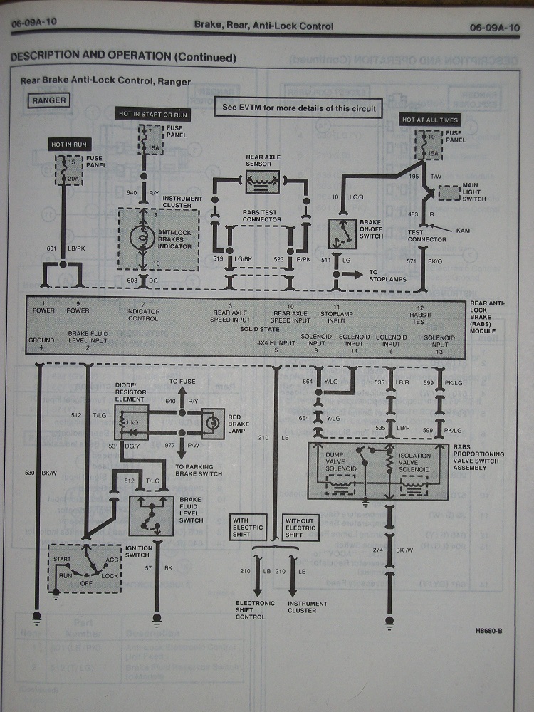

OK, honestly I think it's best if you start fresh on the diagnostics, especially after reviewing these first pages. This is from the Ford 1994 shop manual, so it's going to be the most accurate, in my opinion. What you're working from may, or may not, be correct for your model year.
That dim red brake light is bugging me. See the second page I've posted, where I've highlighted.

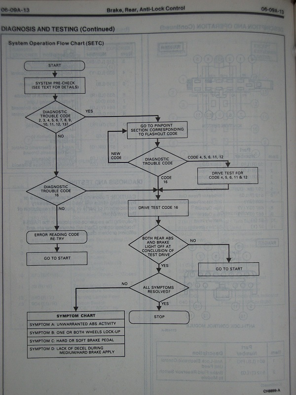

And if your truck is a '94, it should have RABS II. This is the troubleshooting flow chart:
68976
The best next step, is review all of this, ensure the RABS is working correctly enough for diagnosis, and then get to where you can get the diagnostic code(s). From that I can give you the correct pinpoint testing pages that specific code, as the entire manual RABS section is 64 pages.
Last page this post, is a wiring diagram (in case you don't have one, or don't have the correct one).
Just let me know, what sections will help next.
