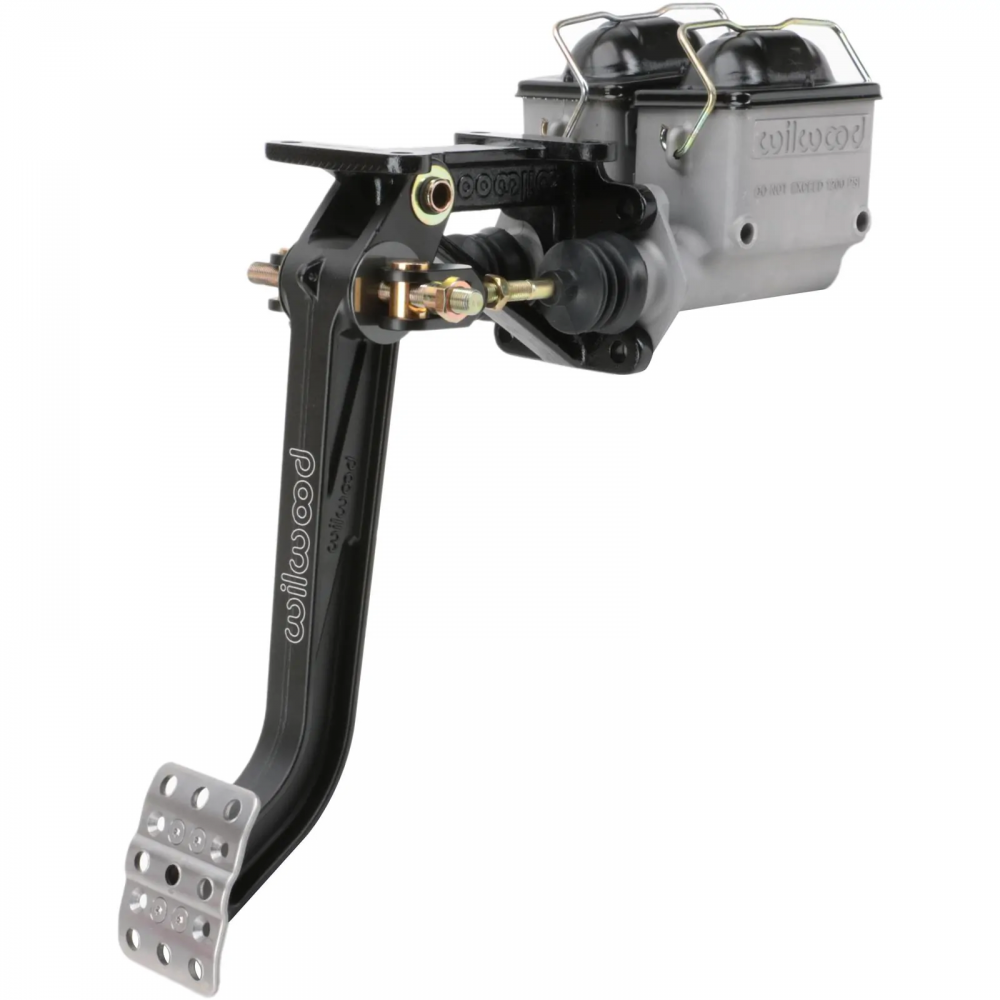

Hope this finds everybody healthy! Need to delete vacuum booster on my '95 non-abs Ranger. I've converted to a QA 1 K member and the strut towers now take up some of that space! So, I can weasel the master cylinder on to the firewall (barely) BUT I'm not comfortable with the pushrod from the pedal not having a guide to keep it's (the pushrod) travel true. When using the vacuum canister the pushrod travel was guided straight. No slop! Any suggestions?? Adapters, Brands, Options??? Thanks
45058
Thanks for that pic! Would you happen to know if that would mount on the existing bracket? I have a clutch too.
No it wouldn't.
There are other ways I'm sure. Find a manual brake master cylinder and you still have to make it work.

Thanks for all replies! What I've seen of the hydro boosts I don't think they'd work for me. I did tho , run with that wilwood setup and tho it's pretty damn costly, they have a neat tandem system with dual pedals and m/c's and w/ prop. valve that pretty much addresses all my needs. I've been trying to adapt a Ford hyd. m/c to a McCleod internal slave cyl. on my toploader trans and it's been a nightmare. So this might let me sleep at night, all I gotta do is remortgage the house!!!! 😂
