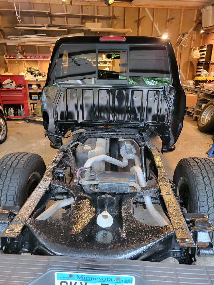

Mine had the common Ranger problem: two rust holes in the bed just above the exhaust pipe on the passenger's side. I felt a need to stop all the rust underneath so I removed the bed and media blasted the flakey rust away. Next I painted on a coat of POR 15.

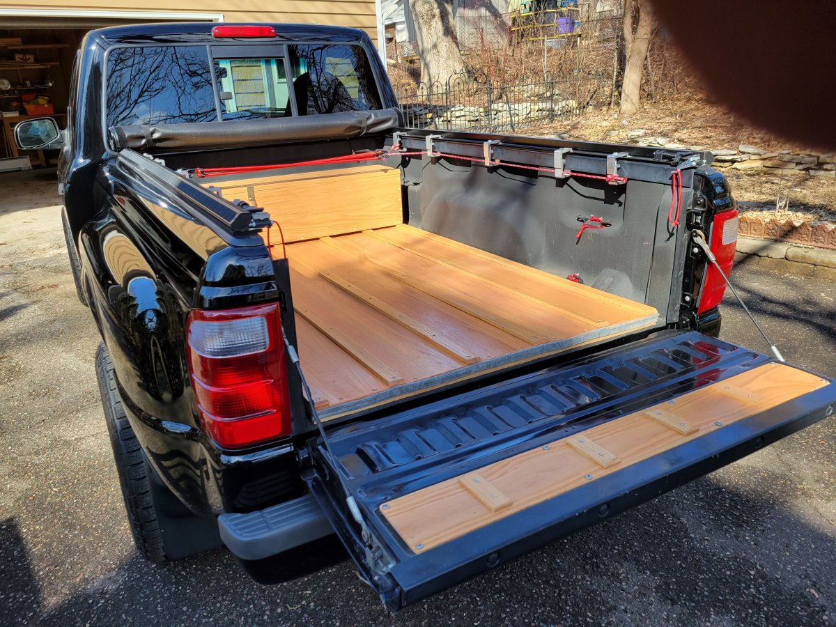

After that I decided go go strictly old school. Mine is a step side after all. I thought why not install an oak bed? I did exactly that and finished it with three coats of varnish. I had heard that some oil the wood with linseed oil. It's great stuff, but doesn't block UV rays which turn the wood gray in time.

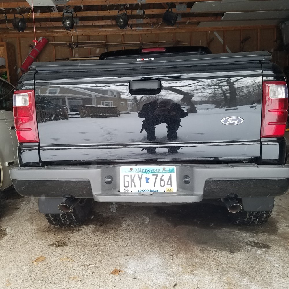

The exhaust is different two. I could be wrong but hope that twin pipes might resolve those hot spots underneath.
that wood bed looks sweet. reminds me of my 79 chevy stepside. does that horn work well there? i ask since its facing backwards?
I'm looking at the Ranger Reg Cab Stepside the last of a one hundred year old tradition. Those older step sides were once bedded with white oak. White oak is not at all prone to rot, wears like iron, will not rust. It made sense in those days when wood was cheap.
