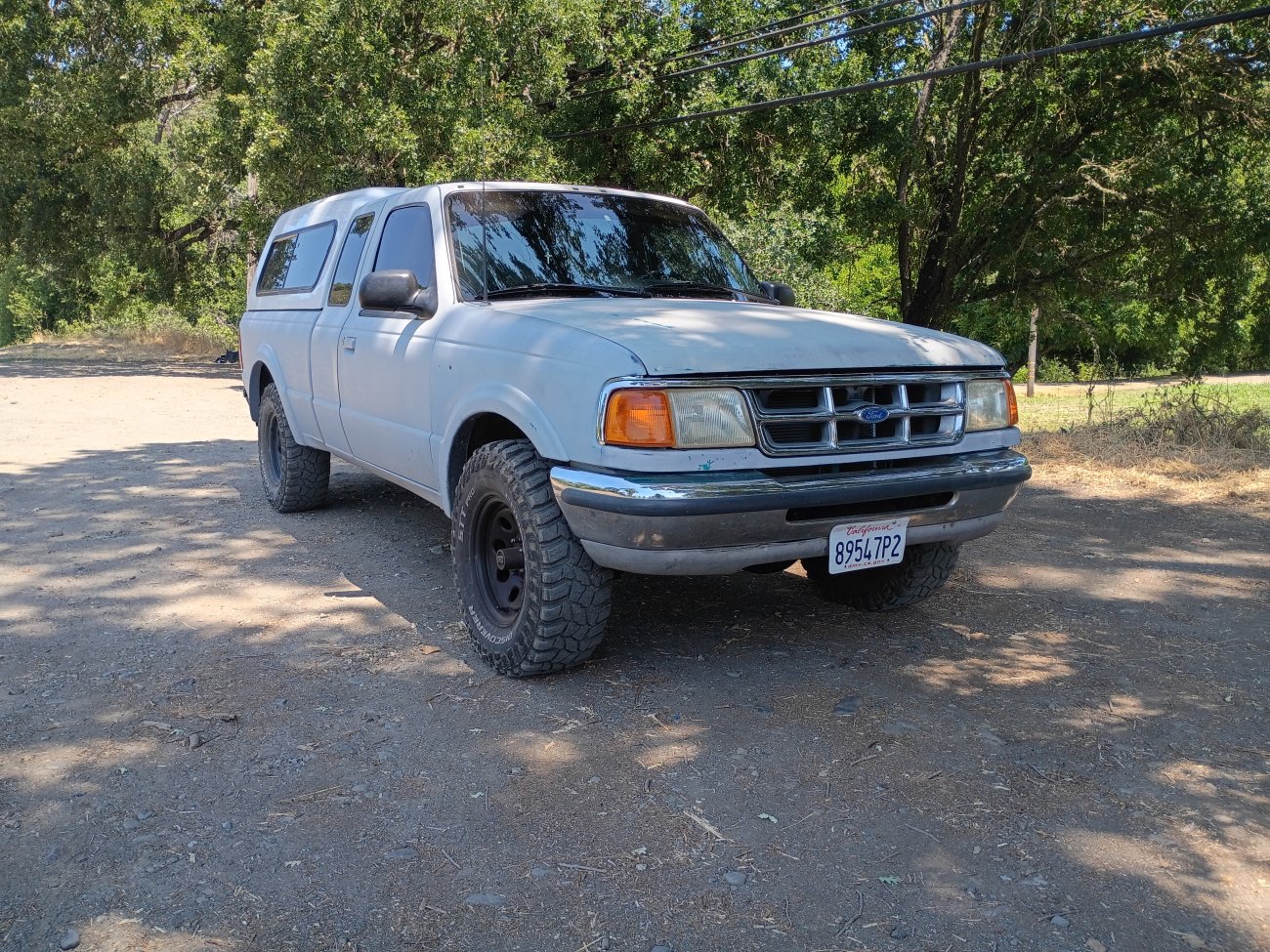

This is what she looks like .

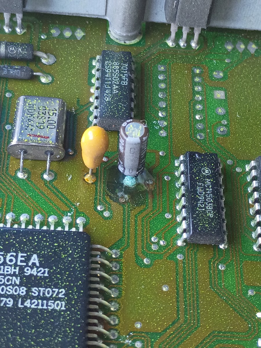

So I just want to point out the problem still occured after a couple of days of changing out the relay, I ended up replacing the capacitors on the ECU one of them leaked and another had some corrosion it's been a week since I did that and the truck hasn't had any issues Thanks
