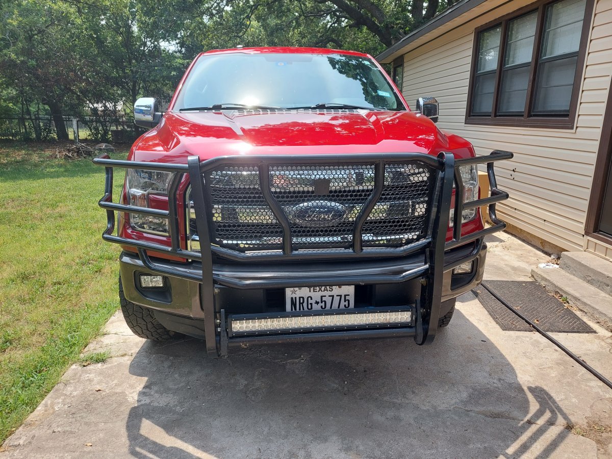

I have this grill guard that I bought off of Craigslist right after I got this truck. I was thinking about adding a winch mount to the front of it. I thought about a front receiver with a removable mount, but people complain that they hang low.

Now compare those mounting brackets to the flat plate bracket that my grill guard mounts to.
I wish I could incorporate one in to the other, but the winch plate is wider than the spacing of the grill guard. I could add a Westin grill guard to the Westin winch plate, but they're expensive.
So now I'm trying to figure out a direction.

They’ll work fine together... with a little cutting and welding v
Ya after looking at it I think I'd need to cut the ends off the winch plate, the bottom tube out of the grill guard, and then slide the grill guard over and weld them together.
I don't have the welder or the skill, but could probably find a shop that would weld them together after I cut and prepped them.
