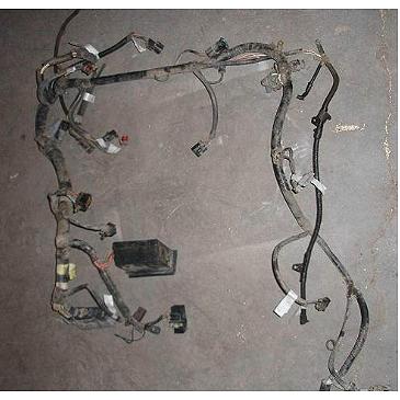

As for vehicle depends on what your expectations are for your build ... EFI or carb is the first question you need to answer.
If efi, go for a explorer V8 as you get all the wiring bits and bobs with it (hopefully)... any donor car will get you 1 of 2 things ... a good engine or someone's money pit.

Thank you for the response. I was thinking of going for EFI and pulling the comp and wiring from the donor. I was initially thinking explorer V8 but they are surprisingly hard to find in my area - the early to mid 90s mustang gts are really easy to find. I guess easy is the wrong term, I was just wondering if having a donor car simplified the process since you have the accessories already instead of searching for them somewhere else. I'll keep looking for some good pages here on mustang 5.0L swaps

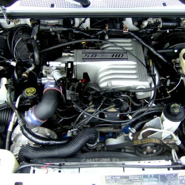

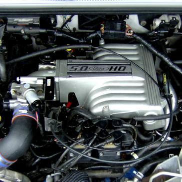

Boss 302's were only built in 69 and 70,are worth mega dollars now, and would be a poor choice for a street driven truck because their huge valves make them doggy at low revs. I'd use a 302 new enough to have a roller cam so you don't have to use a zinc additive and it opens up a lot more cam choices. A mustang engine with EFI will be a roller cam, as will an Explorer. 1986 Mustangs used unique pistons and heads, they ran fine but it makes modification more complicated. T Birds and Explorers also have shorter FEAD (front end accessory drive) systems to make fitting them in a Ranger easier. I found that out after hollowing out my core support and putting the radiator inside it to clear my Mustang pulleys and brackets.
