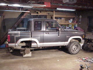

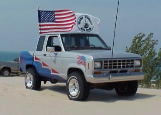

With some custom work anything is possible, here is an extended cab on a BII frame.
an ext cab is 12" longer then a reg cab and a short box is 12" shorter then a long box. i dont see the trouble?
ive been through this before, had a 86 ext cab and 86 reg cab and wanted to swap the reg cab on the ext cab frame and i measured it all out and thought it would work, then after i got down to the bare chassis on both trucks i found out the chassis on the ext cab one was longer
ok..i guess il see how much it would take to fix the 88 frame. thanks guys.
I would climb under there with a tablet tape measure and a friend to hold one end.Won't take long to know a lot more than now.
ok OP ws a std cab/lng bd & swap is a ext cab short bed. It seems to me that it should be the same length of frame.
Very nice ext cab onto bronco II frame by the way very cool looking.
