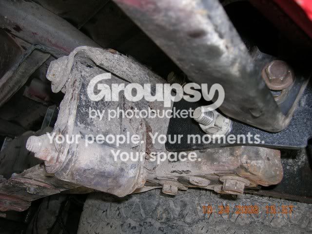

The first problem is that with the bumper relo kit on the rear, it now doesn't allow the rear hitch to be put on without either having it welded on the frame or heating up the mounting brackets on the hitch and flattening them out a little bit to makeup for the 1/4 inch or so that the bumper relo kit added to the width of the rear frame. Has any one had this problem also? Or did my mechanic just do something wrong?
Here is a pic of that to get an idea.

Maybe the hitch should be installed first and the bumper brackets on top of it?

Iasked the mechanic if he tried that with the hitch and he said he had. I am going to look at it further tonight when I cut out the holes in the valance so I can get my front tow hooks back on

You need to remove the rear bumper and install the hitch first. I modified my hitch by drilling the holes exactly 3 inches higher to compensate for the increased height so it remained tucked under the bumper. You will need to use washers to space out the brackets on the bumper side 1/4 inch on each side.
