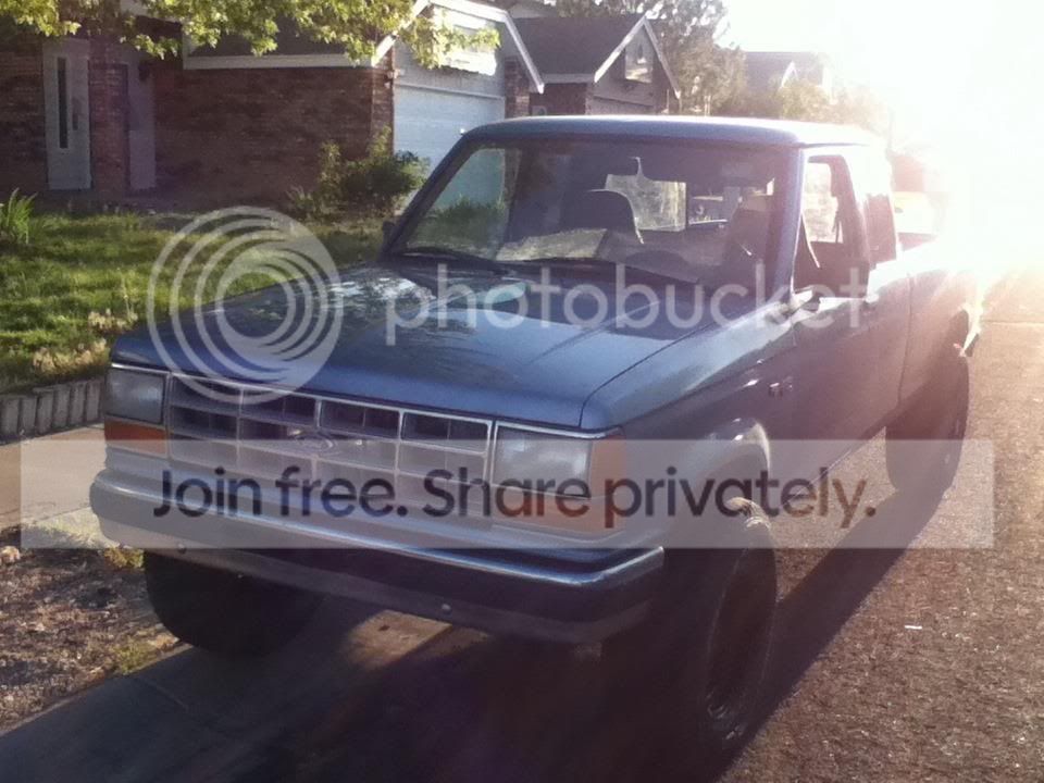

lets start the build.

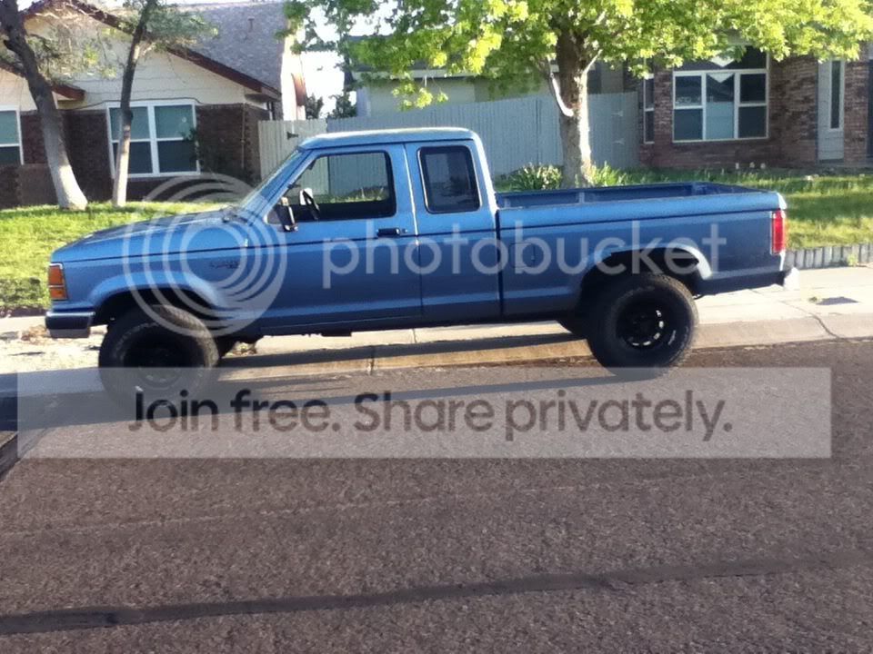

Yesterday i picked up a 1991 ford ranger 4x4 extended cab with the 2.9l for $1300.
The things i need to fix first is it needs a starter rear window, and front shocks.
it has a leaking steering box but not to bad and mild rust on bed and the mirrors are shot.
it runs good with no lag or vibrations for having 160,000 miles on it.
I have some parts that from a recent build that will go on it asap. this includes 2in coil spacers and an add a leave. and 31in tires on steelies.
i will have pictures of the progress soon!:icon_thumby:
here is a picture finaly
i also got the starter on and shocks it fires and runs really good. now its time to do some upgrades and see it run from there

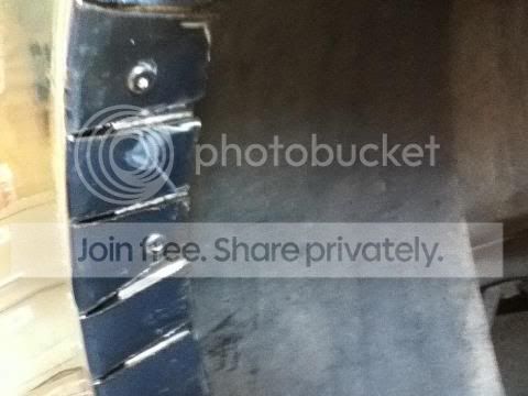

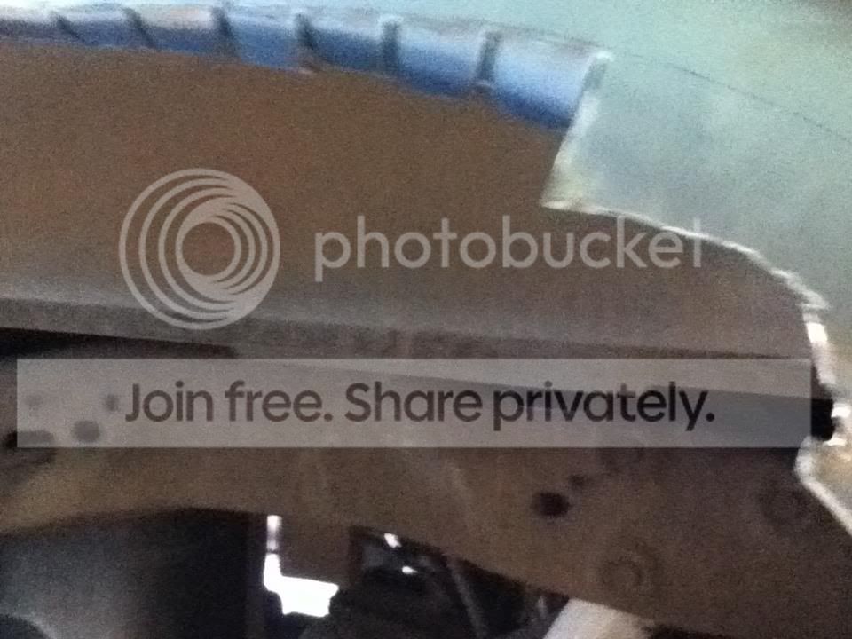

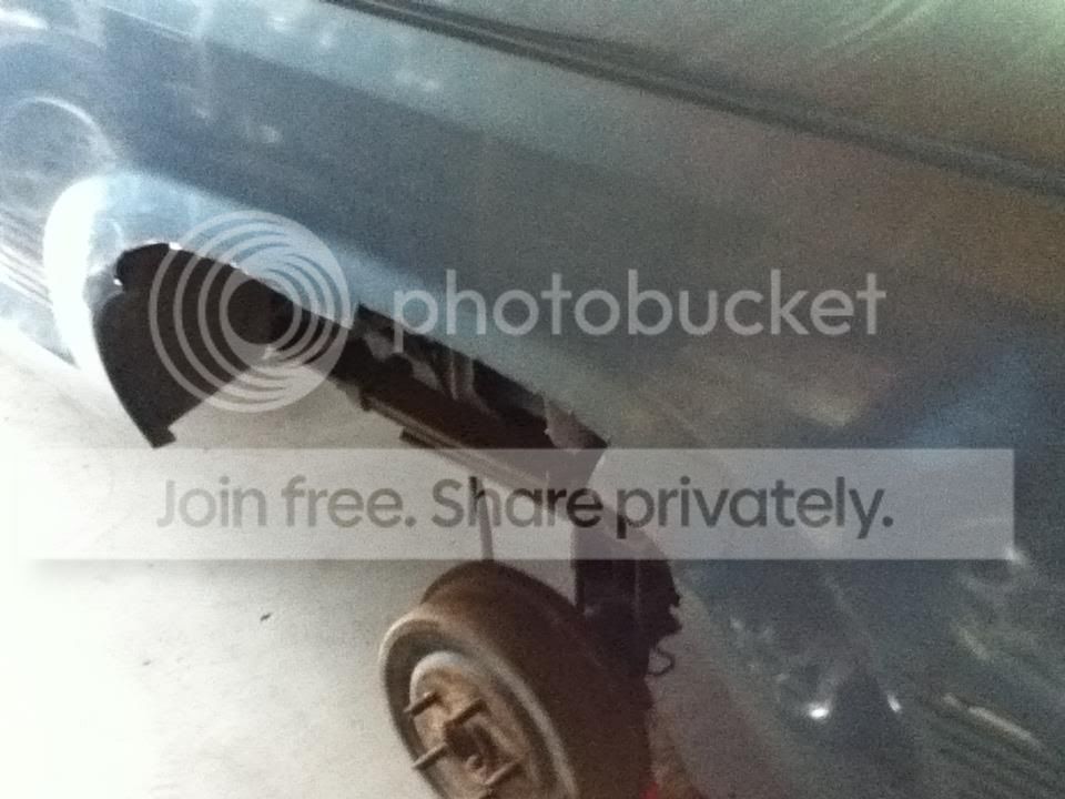

the rust that is on the bed is falling off i started to cut it out. for now im going to trim the fenders in the rear off. i like the look of the uncut fenders in the front so it will stay that way. im going to start drawing up ideas for the bed.

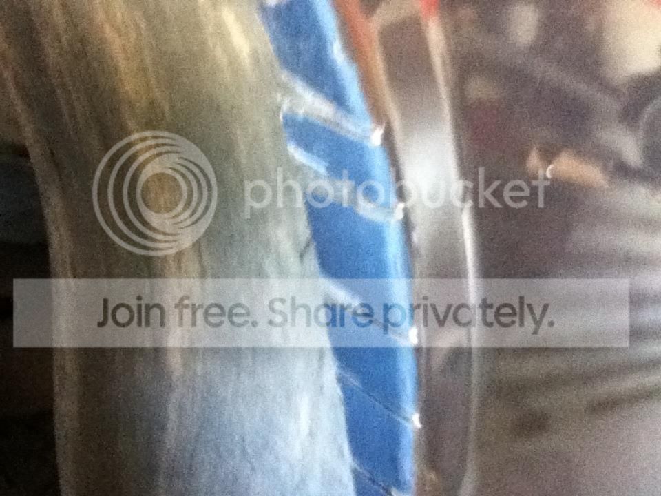

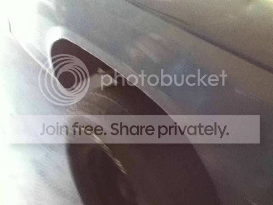

i decided to roll the fenders in the rear and i might cut up the front.:icon_welder:
