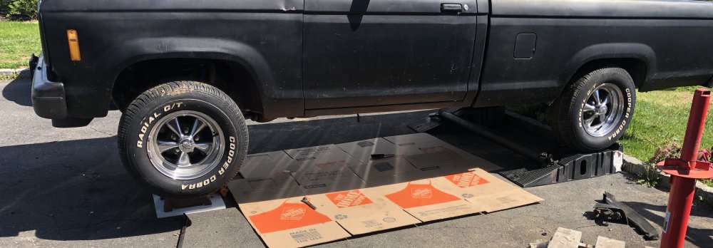

New 25-2800 stall converter is on its way. Going to pull the engine and transmission as a package. I’m not happy with the oil pump I used on the build. So now is a good time to change it out.
looking oh so good, Wow. get the dash mocked in there? how'd it turn out?
700r4 is out.
