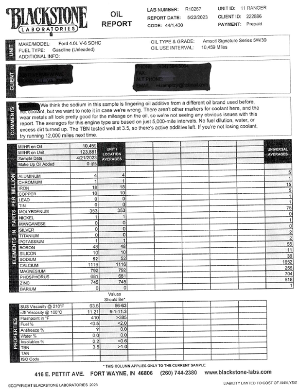

This was the third time I've changed the oil with this combination + Amsoil oil filter. Five quarts of Amsoil + 10 oz can of MolySlip with the Amsoil EaO11 filter puts the oil level right at the full mark on the dipstick, so it isn't overfull. Amsoil claims the oil is good for 25,000 miles, but also recommends an annual change, and this oil had been in the truck about a year.
The truck is not losing any coolant. See what you think of the comments about sodium, as the sample had no water. I think the results show the engine is basically healthy.
The prepayment was $45.00 enclosed with the sample, which is sent free with prepaid postage.

So this is my .02 cents on this. A year is a lot of time on an engine and doing only one oil sample at the time of the oil change once a year isn't going to help much for tracking the conduction of the engine. I would be sending in several oil samples a year. Unless you have the last oil sample from your last oil change how do you know what it was? You cant just go on what the oil analysis lab says, They are just people behind a desk. I'm not saying what they do isn't good. Oil samples can 100% tell you if you have a failure coming 100% but not if you don't have a way of looking at the elements overtime.
There was some interest here when I mentioned I was thinking of an oil analysis. I don't think getting one has come up here much. This was more about how the analysis looks for those who are unfamiliar with them.
I would not be worried about that result at all. And I would agree with them that you can run this oil longer than 10k miles if you want. (Although I limit mine to 10k, using Mobil1) The wear metals are all in normal range for that interval, and the sodium is not much elevated.

First, the dipstick isn't the final authority. If we got an oil use complaint, step one was an oil and filter change to verify the dipstick read correctly. Step 2 was having the customer drive the vehicle and return when it needed oil so we could document the mileage to justify a teardown under warranty. At least 90% of oil use complaints were fixed by correcting the dipstick- usually by cutting the tube. A pro would always check the oil level after an oil change, an amateur(like jiffy lube) would squirt in the oil and shut the hood.
Second, I would never go more than 5000 mile or 6 months on an oil change, analysis or not. Oil is cheap engines are not, but if you choose to go longer that's OK. I don't sell engines anymore but I have friends who do.
Third, almost every oil use complaint we got on vehicles running Amsoil was cured when we changed it with Motorcraft. I don't remember a single case where a teardown followed the consumption test. The Canaan Police used to run Amalie in their cruisers and they used oil. We changed them with Motorcraft and the oil use stopped- until they changed it again and put the Amalie back in. The chief was a friend so I didn't mince words explaining why the oil was being used again.

Zero added. Over 10,000 miles the dipstick level went down only a small amount, maybe about a quarter of the way between "full" and "add". If the difference between "full" and "add" is a quart, then the consumption/loss was only about half a pint. That would work out to a quart about every 40,000 miles. For a truck with 125K miles, I can't complain.

Broadly agree with most of your points, but extended changes using the appropriate full-synthetic oil have been the norm in Europe for years. That said, 10K is about my absolute limit, and I'm not going to push it to the 25K Amsoil claims its premium Signature Series oil can go. The time limit was a year anyway, and I had reached that at about 10K. Amsoil has cheaper grades of oil that I would not use for 10K. The analysis was out of curiosity and not because of any perceived problem. My Ranger runs like a champ (knock on wood) and does a lot of highway trips, so that helps.

The oil analysis looks good. It’s your call if you want to go longer on the change interval. I wouldn’t but I’m also not using Amsoil.

I just noticed you're in Va., that means no sub zero weather to condense moisture into the oil and much quicker warm ups so far less combustion byproducts are blown by the rings. I'm glad it's working for you but I still wouldn't do it. Europe isn't a good example to cite, they keep starting wars at home and losing.
