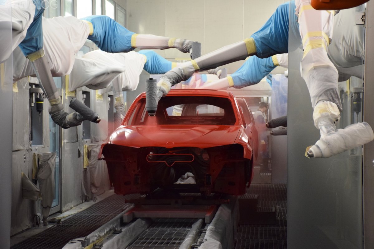

I've got a couple paint booths at work. It's not all fun and games to take care of.
the cheap masking tape is a nice touch.

We go through miles of masking tape. The smaller covers near the applicators (sprayers) get replaced 2-3 times per shift. The larger robot covers are replaced weekly. Cleaning is a big part of the production operator's jobs. If we go in the booth to work on a robot, the covers have to be untaped and moved, then put back or replaced and retaped when we finish. That cheap tape does the job fine.

That's a lot of materials to go through! Craziness. That's how you get dust free paint though I imagine.

Yes. If the paint builds up and stays on the cloth covers long enough, it starts to flake off as tiny particles and float in the air when the robots move. If it’s in the air, it will get on the car. Then we have to fix it and repaint. :( Painting here at the factory is definitely crazy.

I think we limit the number of times a car can be repainted. Pretty sure if it’s bad after the third time we scrap it and start over.

Yeah. I got that. It’s different now, at least for us. Everything gets a lot more regular cleaning. Plus, there is less overspray in the air. We charge the paint to a positive 50k volts or so and the car is grounded. So the car attracts the paint as it comes out of the applicator. That would have been just a bit dangerous with people hand spraying.
One place where we get buildup like that is on parts cars. Those are scrap bodies we use that we can install a new replacement door, hood or hatch on and run them through the booth to get painted. Those bodies end up with really thick paint before they get retired. Parts bodies allow us to paint replacement removable parts instead of repainting a whole car just because a door or hood gets messed up.

I'm not sure. The base coat (color) is a water based paint. Our clear is a two part system. Manufacturer varies from time to time for various reasons. (PPG, BASF, and others)
