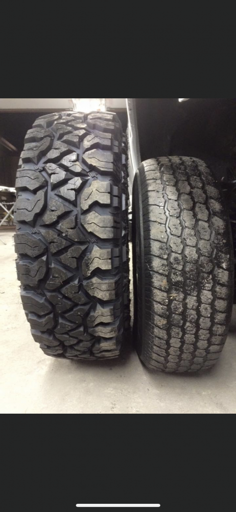

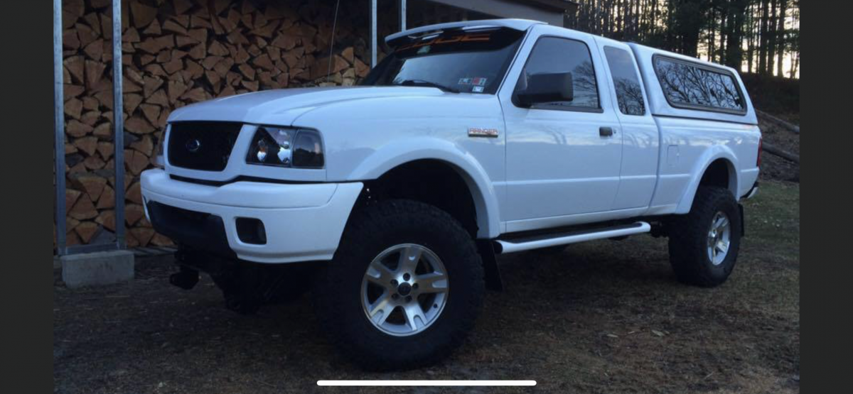

Simple answer is NO. I am running 285s with the torsion bar delete and 800lb coilOver Shocks AND a 3" body lift. My tires contact the flares under a hard bump turning a corner(like pulling into a driveway)
Here is a pic of stock 245s vs the 285s just to give you an idea of the size difference and why they don’t clear. Also a pic of my truck w the coilovers and 3” body lift w 285s
