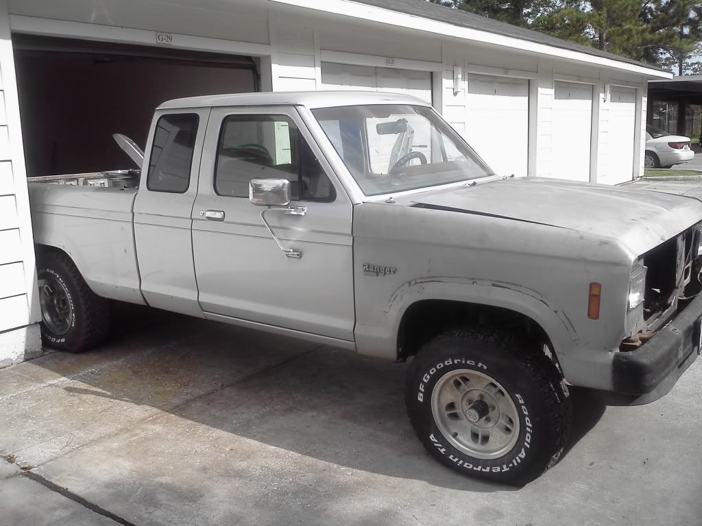

Here's the 86 when I bought it. Only paid 300 for the truck

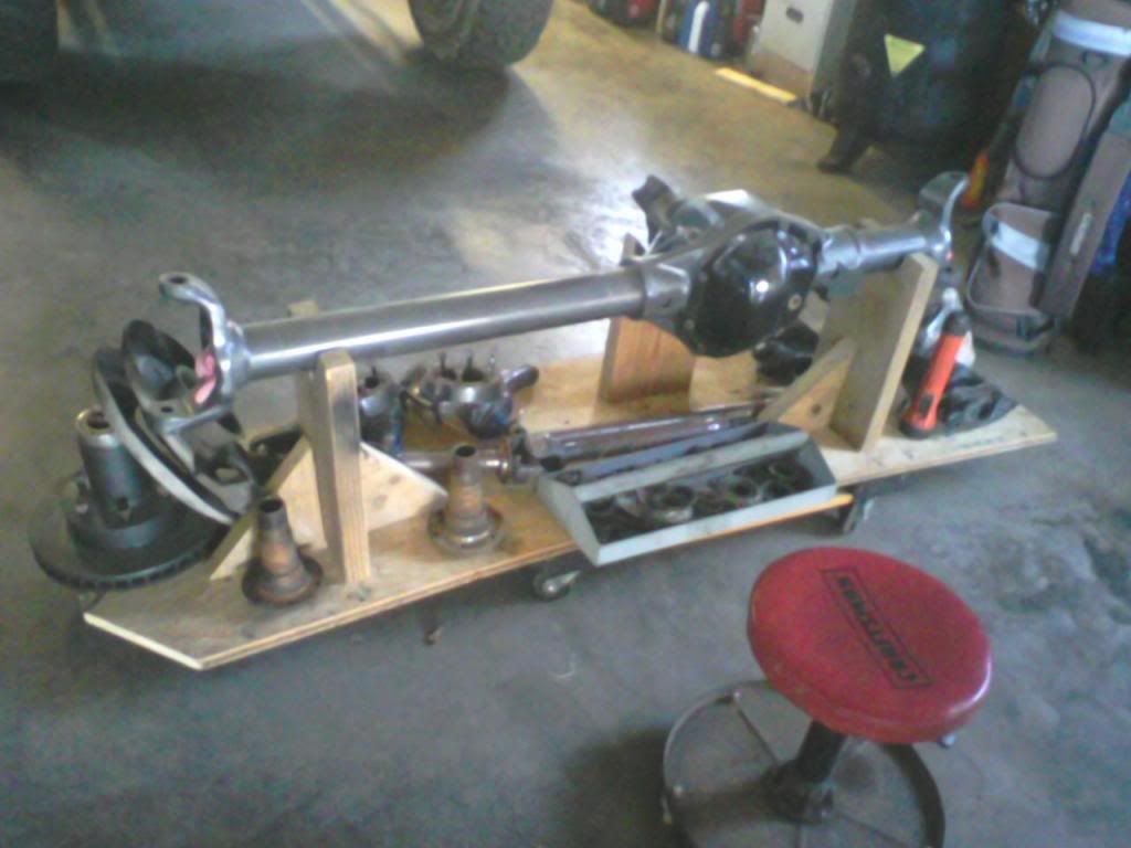

Brought it home and bought a Dana 44
And cleaned/ rebuilt it with chromo axles and 373s

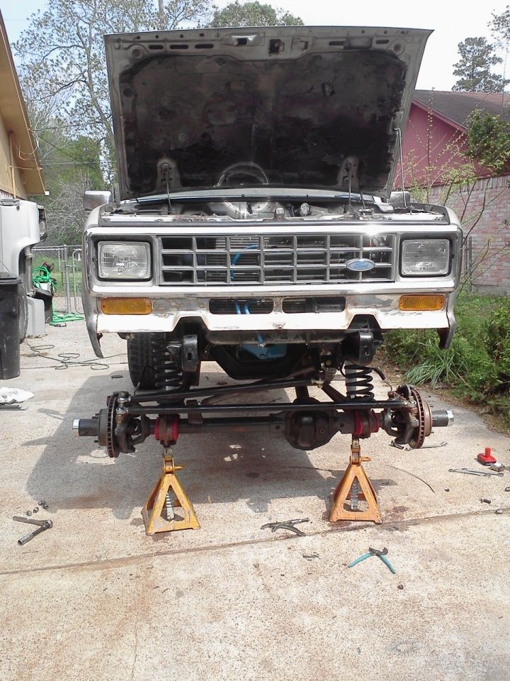

Bought a pair of flat top knuckles and a high steer kit

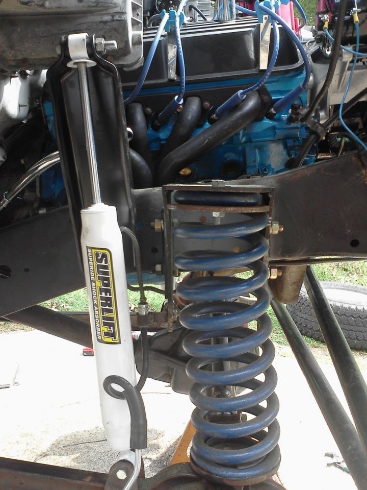

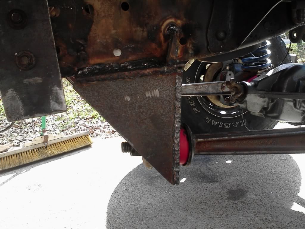

Bought some EB 4" coils and some ballistic fab coil buckets

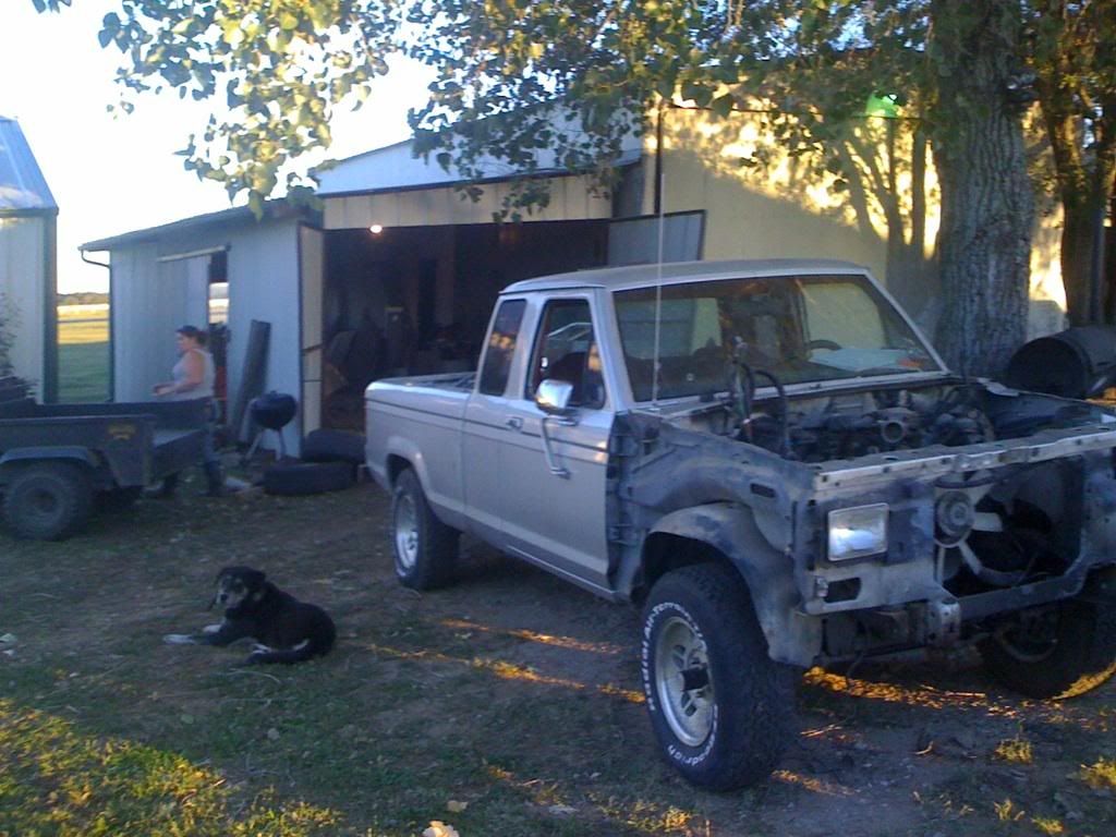

Truck before the SAS

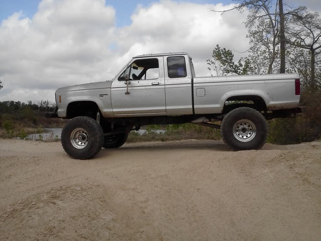

After

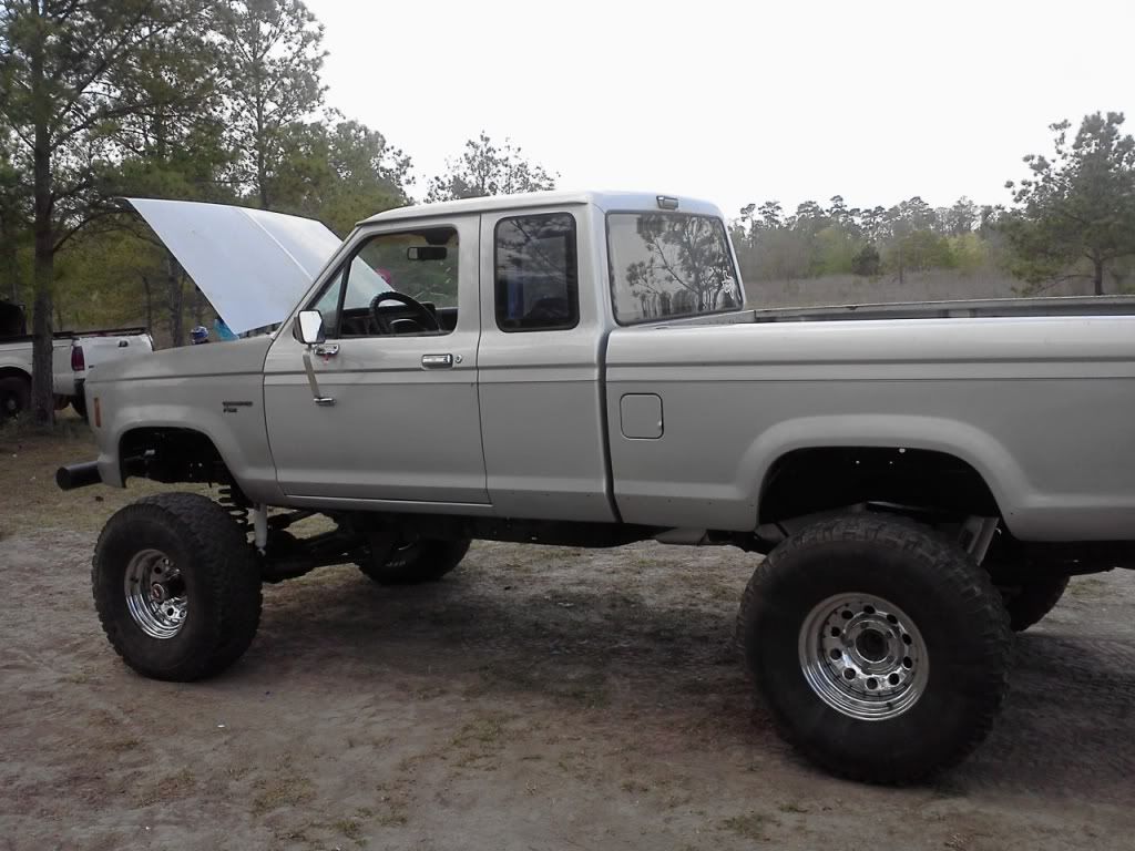

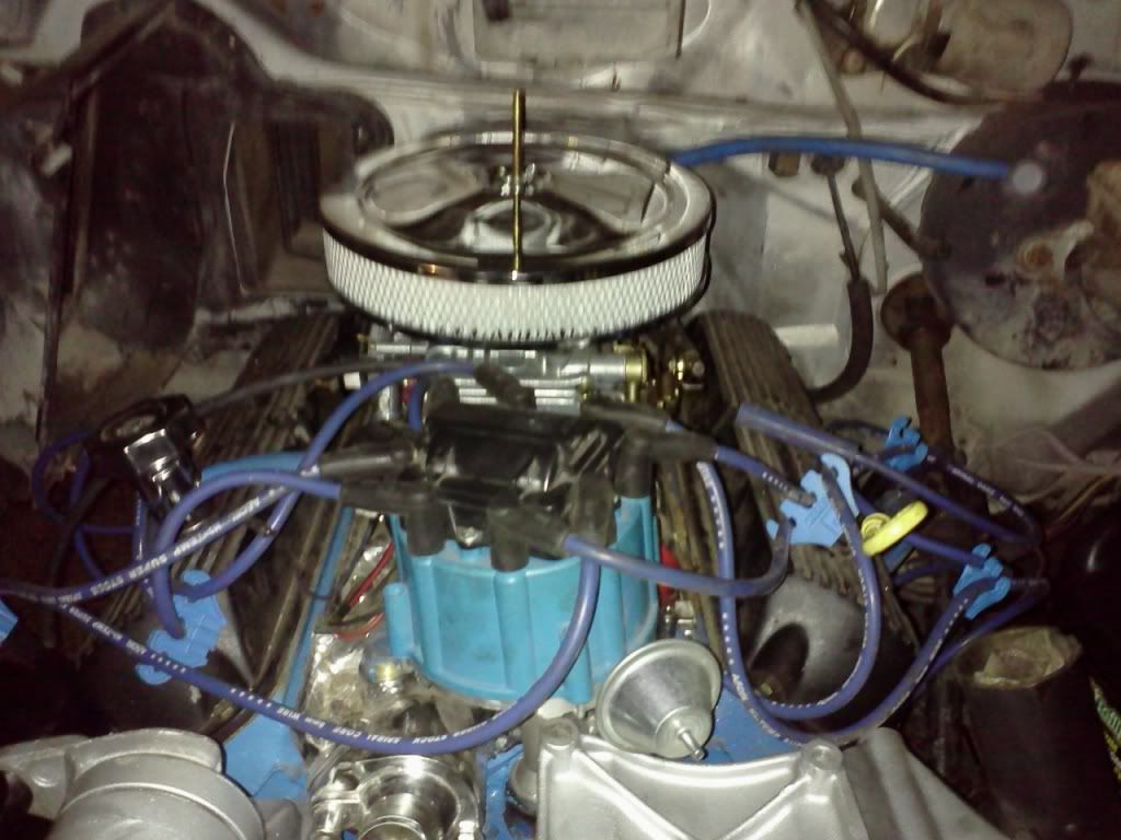

Motor installed decided to convert to carb.

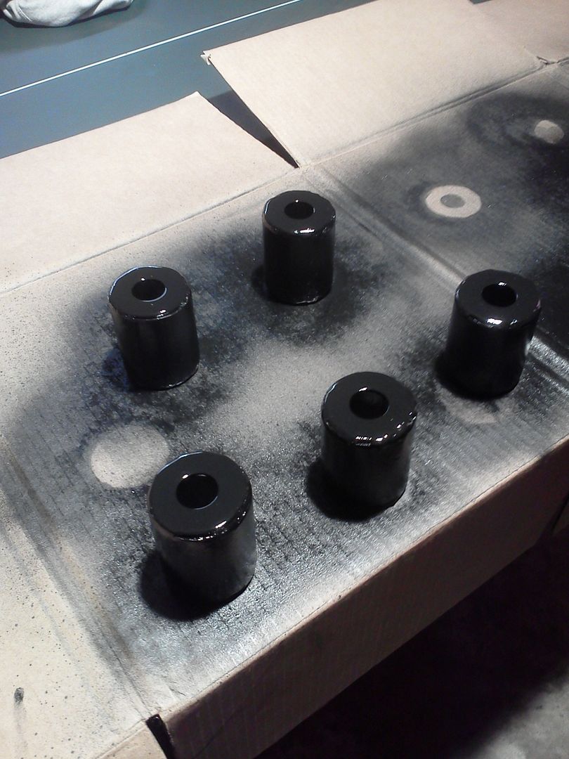

Made a 3" body lift
Truck done as of 04-03-13

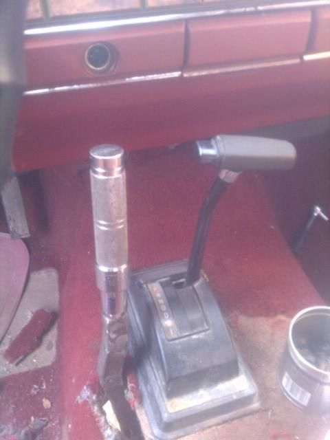

Torque wrench tcase shifter

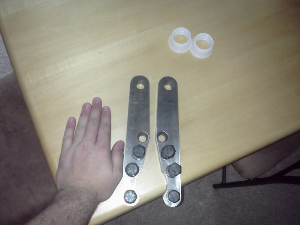

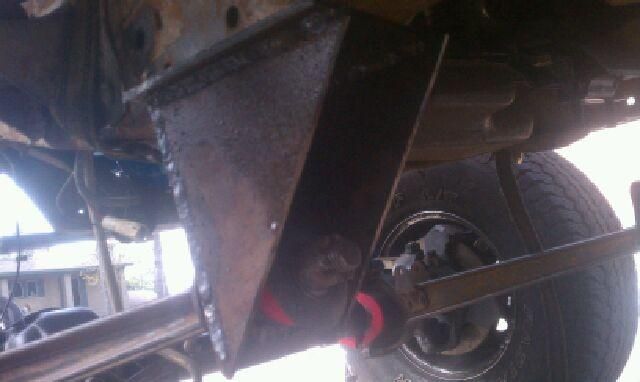

Custom Ra drop brackets
Tranny cross member
