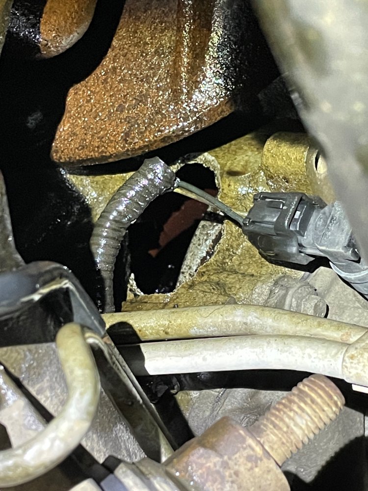

I recently picked up a 2005 Ranger (2.3L auto) knowing it didn't run, but the body and all is in pretty good shape. The guy said it died on the highway, didn't make any weird sounds, just sputtered and died (Whatever you say, pal). It smelled strongly of fuel when cranked (though it did sound low on compression on a cylinder or two), so I figured it was a simple fuel line leak. Sure enough, a mouse had chewed through the fuel fitting right above the gas tank, and it was spraying fuel out. I swapped the fitting, and was fairly confident it would start right up.
It didn't really want to start, but it did get going with some encouragement. Barely. There was a real bad misfire and wouldn't stay running. A quick investigation revealed a lot of oil coming out from somewhere, and after I got up under it I noticed a hole in the block. I guess the fuel line was just a lucky coincidence. Not sure what happened to the poor thing but there's no bringing it back now.
I'm on the hunt for an engine now. Local junkyard had a 2007 but someone beat me to the engine. There's a 2010 there too, but it has 230k miles and a suspicious hole in the valve cover, so I think I might have to pass on that one. Calling a few other places local, either nobody has one or they want some crazy number for it (>$2000??). I'm just looking for a beater truck, I don't want to throw too many pesos at it.
So, after that long winded way of getting to it, here's my question. Will any other engines just bolt right in, or am I stuck hunting for a 2.3l? If so, any ideas of where to get a decent 2.3l near Virginia for less than $500 or so? I might just put the truck right back up for sale and try to get my money back, I don't know. Thanks for any help.
P.S. First post and all, but no stranger to a Ranger. I also have a 1984 4WD V6 and a couple of early Couriers. Just not super familiar with the newer stuff.

2004 to 2011 2.3l Duratec will work, plug and play, 2001-2003 had a different intake, but you could swap yours over if one in these years is available
No, the bolt pattern for transmission is unique so would would have to swap out engine and trans to change engine model and of course computer and Cluster, so not a cost effective swap

try 2007 Escape. block & head probably the same, swap the accessories. will need a front engine cover, Escape doesn't have a mechanical fan.
Virginia is pretty big, but the one u-pull-it I'm familiar with in Fredericksburg (we have the same company here) charges ~$350 for an engine. Newer Rangers are not rare, and they don't really care if you use cutting tools. The Duratec apparently weighs 2-300lbs, depending on what's bolted on. On a budget I'd grab a buddy or two and go pull one myself.
Downside: likely no warranty. They do, however, keep track of known bad motors, and will tell you if the truck drove in under its own power.
If you owned 2 Couriers and survived a Ranger with a hole in the block won't hurt you. Before buying an Escape engine make sure it will work. I'm sure you could handle swapping externals but Ford has never been good at "they're all the same". We ran into a case where the same basic engine from 2 different models wouldn't interchange- and I think it was a 2.0 from a Focus vs one for an Escape. The vehicle we were fixing had- and needed- an axle support bracket on the block but the donor didn't have one. The owner of the Escape bumped the shifter into low by accident then headed down the road towing it behind his camper. The hole in his block was bigger than the hole in yours, too.
I'll just keep an eye out at the junkyard for the next couple weeks, and if if no Rangers turn up I'll expand the search to include an Escape Thanks.
