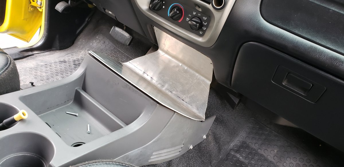

I'm currently attempting to install a exploder center console in my 4 door FX4. So far OK I guess, Just got it screwed down & solid. I'm looking around for a hot wire to run a few things. A 20 amp circuit would be nice. I have been sniffing around the fuse panel at the passenger kick panel & did find a red #16 wire. There is also an overhead console too at some point, but I don't think it will look like this.

The aluminum piece will be upholstered? Who knows? This is a whole lot of space to plug up. Looking to discover the different ways to go about doing this, but the arm rest is way nice. It had to be rebuilt & will be receiving a swatch of suede. The console will be painted black as the whole interior is black. To contour everything, I first need to establish what the heck will be the final design. The Econoline 60s Ford van style with the big flat area would be nice. Looking to modify only the area left open. Also some front panel area for some flip switches will be needed for lights, winch, ect.

Thanks Eric. Good idea about the ready distb block off ebay. The big hole? hummm. The console is slid as far as I can think reasonable seeing that the arm rest has to be in the correct place which it is. Where is my stash of big pieces of cardboard?
Could add some more material on the sides of your plate so it goes all the way to the floor.

This is true about the ciggy lighter circuit, if I could only figure out how to bust open that front panel surround. There are 2 screws underneath the radio. But when removed, everything is still intact. Don't want to break anything I cant replace. As far as the open hole goes, I did find some large flat sections of cardboard that will help out in modeling that forward hole.
This is fairly overwhelming. I want it to look not like a hacked up job, and this whole deal is challenging to make something effective, nice looking and not looking like a unskilled afternoon job, however there are some of us that could knock it out quickly.
Those forward tabs need extending. All the way up to the HAVC duct. I am a fabricator. So now I am challenged again. Roadworthy will determine the rough duty and utilitarian design. Now where is my cardboard & spatula. - Doug
