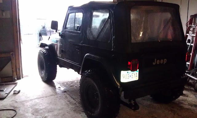

I went down to Denver last weekend and helped my buddy stretch his TJ jeep. We threw in a YJ dana 44 and XJ leafs. We got about 5 inches of stretch.

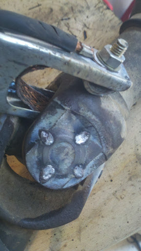

As for me, the guy who did my buddy's gears had a Ranger TTB so I got some shafts and also some extra locking hubs. With those shafts I tacked on the caps so I wouldn't have another incident like the one a few weeks ago... Now yesterday I read that you shouldn't weld the very end of the shaft because it weakens it and you shouldn't weld the sides because you cannot fit the shaft in BUT I did. The tacks are not very big and I doubt they will effect strength very much. The needle bearings didn't heat up and no grease boiled out.

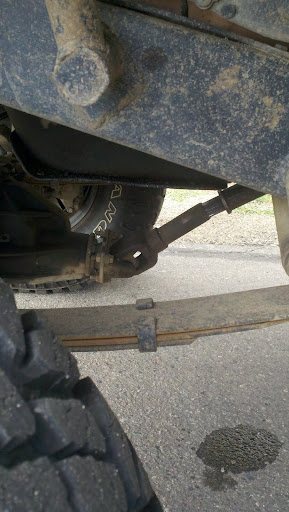

There is a kid at my college with an older lifted land cruiser. The rig is cool but and check out his pinion angle:
We also got some snow... I want to be there when that dude throws his land cruiser throws it in 4wheel drive.
thats a nice ranger that you got.
holy that is some pinion lol

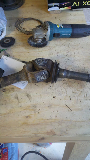

After I backed off the side of the axle one of the caps came off the ujoint on the axle shaft that I did not weld yet. Its odd that the caps on both sides come off now but not earlier. I welded my spare axle shaft's caps on and threw it in... I need to either get new ujoints for the spares or just pick up a new set of shafts, It might be cheaper and more beneficial to just get a new set of shafts from a TRS member (PM me if you have a set you'll sell).
My buddys jeep with the stretch and rear leafs:

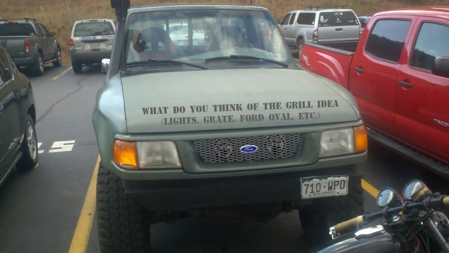

Heres an idea, what do you think?
I'd skip on putting lettering on my hood :thefinger:[/QUOTE]
Ive been debating on this for some time now...jk :icon_cheers:

Heres a pic from my dorm window... Ill get a better pic later but do you guys think I should add mesh/expanded metal or leave it?
I also was having a CB radio issue that I resolved (antenna was grounding itself out) and I bought a 60" highjack for 66 bucks shipped and am going to do a custom-ish bed mount.
Thats all for now!
I would try to find some kind of mesh or something for it..
I like it without mesh.. if you put mesh in itd just look like every other billet grille out there
