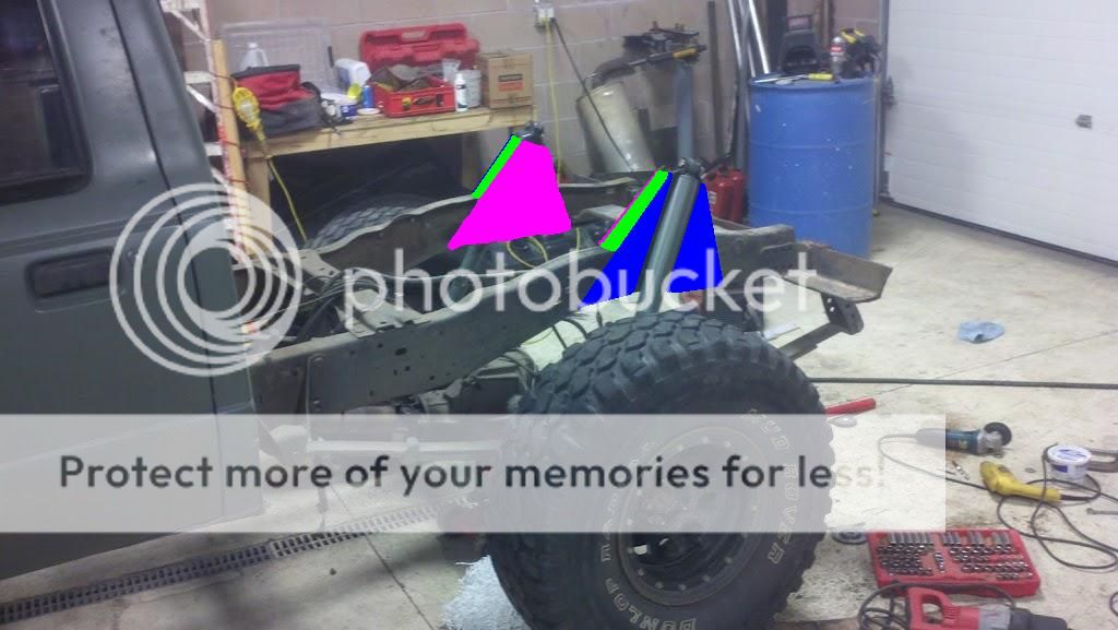

At least on a TJ, the frame is boxed, and they only cut about halfway through the frame to put the towers in those. Here, he has pretty much cut through the entire frame.
I do like the idea of this, but if it were my truck (and I know it's not) I would do something like this. The pic is pretty self explanatory, but I feel like explaining it anyways. :icon_twisted: The blue would be outside the frame rails on both sides, in front of and behind the open area for the shock to pass through, the purple would be inside the frame rails on bothsides, and the green piece would be to cap off the area in between. This might be overkill, but better overkill than not enough.

you have just changed it from being and open c in one direction to the other..
Where-as the c-frame shown above that's not reinforced is having all that force put on it by the leaf springs, it could really just snap at any moment on the trail/road. I would brace that frame before putting it back on the road IMO.
Right idea, wrong way of putting it into action
Lol well like Kage said I, in no way, am going to lose sleep over this. I have out boarded my friends TJ and they do have fully boxed frames. I will add a bit of reinforcement because if I want to tow something large I wont have any issues. Am I going to do a huge gusset and change all my work? No not a chance. I do appreciate your concerns however but I feel they are un needed. lol!
i dont forsee any Huge issues. i think it would start bending and crushing the shock tower before it just up and snaped in half and then what. it pushes the box into the cab cant go to to far from there, that is until the bolts rip thru the box in which case i hope your either pulled over by then or have taken appropriate driving measure to limp home
just dont go out and race any desert series races as it's not the STRONGEST design but not horrid either
