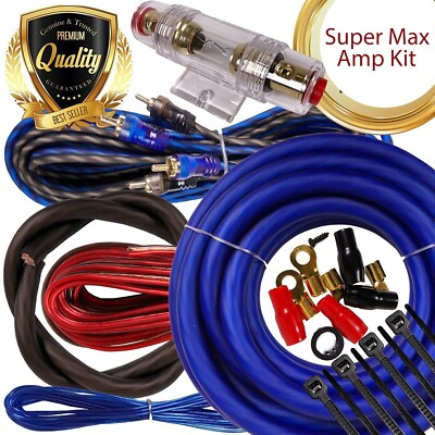

You will be just fine with 130 amp alternator. I only had the 95 amp and it never acted up. Biggest issue was lights slightly dimming whenever the bass was bumping hard, but that can be fixed with the 130 amp alternator and a farad capacitor. You can buy nice wiring kits for your amp and speakers for pretty cheap online, I got my last kit for $20 and it was all 4g wiring with rca's and nice big fuses. A lot better than the cheap ass kits at Walmart that sell for the same price.

I been looking at kits on ebay, and they are either spendy or super junky lookin no name brand. Please share if you got a good source for a wiring kit.
