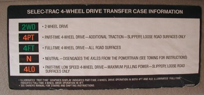

My 5.0 Ranger has a NP242 which has 2WD, AWD, 4WD, N and 4WD lo.​

In AWD mode, NP242 has 48/52 f/r split for torque in AWD mode. But you can lock the differential when going gets bad.
Man that NP242 sure sounds like the cat's meow. 2wd for everyday in-town, AWD in town if it's rain/snow, 4wd/lo for off-road or extreme snow/ice intown. It covers all the bases. Any downside, besides cost and work to install?

242 sounds like from a grand cherokee. The full time 4x4 tcase used on the laredo models from 93 onwards
242 uses similar concept as an OPEN differential, so it does have its drawbacks, in AWD, vs 4WD
In AWD 40% power to front 60% to rear, but if front or rear drive shaft becomes easier to turn(slipping) then it gets MORE power, so opposite of a limited slip
But this does allow AWD on dry pavement, which was/is the point of differential based transfer cases
With transfer case differential locked both drive shafts get equal power regardless of traction, so 4WD
Yes, 242 has a differential, I've had it apart and counted the teeth on the gears; it is 48/52% split when differential is open in AWD (known as 4PT on Jeep shift pattern). With one wheel jacked up, it would sit on spot without moving. But in slippery conditions, i.e. those 1st couple snowflakes in September, it improves truck acceleration markedly.
The differential is a spur gear design, so slightly different than OEM one in Ford/Dana differentials/not quite identical to helical gears in Detroit Truetrac (side gears in TrueTrac are also same size so no left/right bias)​
The differential can be locked by pulling into next position (known as 4FT on the Jeep shift pattern)
When the differential is locked, the front and rear driveshafts turn at same speed, regardless of traction at wheels corners, etc.​
With the Torsen differentials, I always have at least 1 front and 1 rear turning and usually all 4.​
The only time it is in low range is maneuvering the 5th wheel in the quonset as space is...tight and going a little slower is handy.
The one I have was pulled out of a Cherokee XJ. Jeeps with 242 are known as having Selec-Trac.
