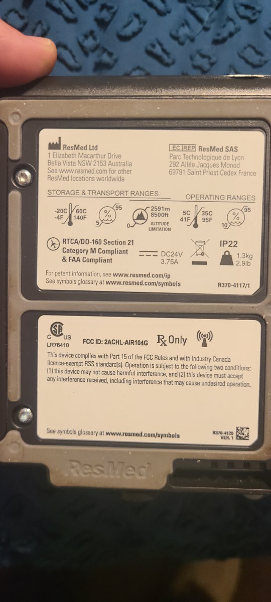

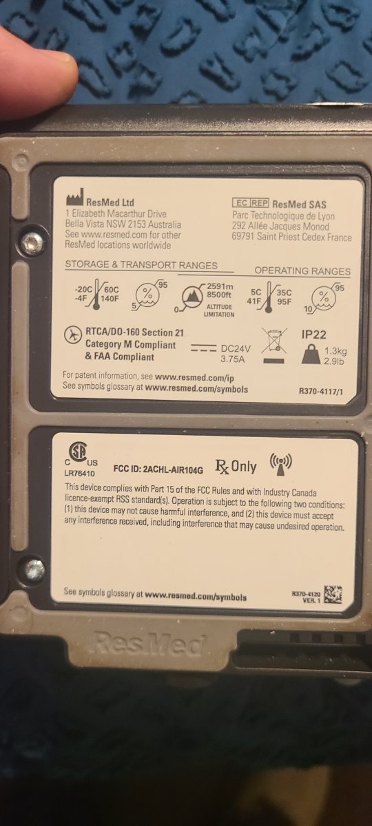

And yes, jist the cpap. Its a resmed airsense 10.
It says:
dv24v and 3.75a
On the tag on the bottom

It says:
dv24v and 3.75a
There should be another label on the power supply that you plug into the wall. That will be the info you want. It will probably be the numbers I mentioned above.

Just looked again. Mine is a ResMed Air10. Same DC ratings on the base unit.

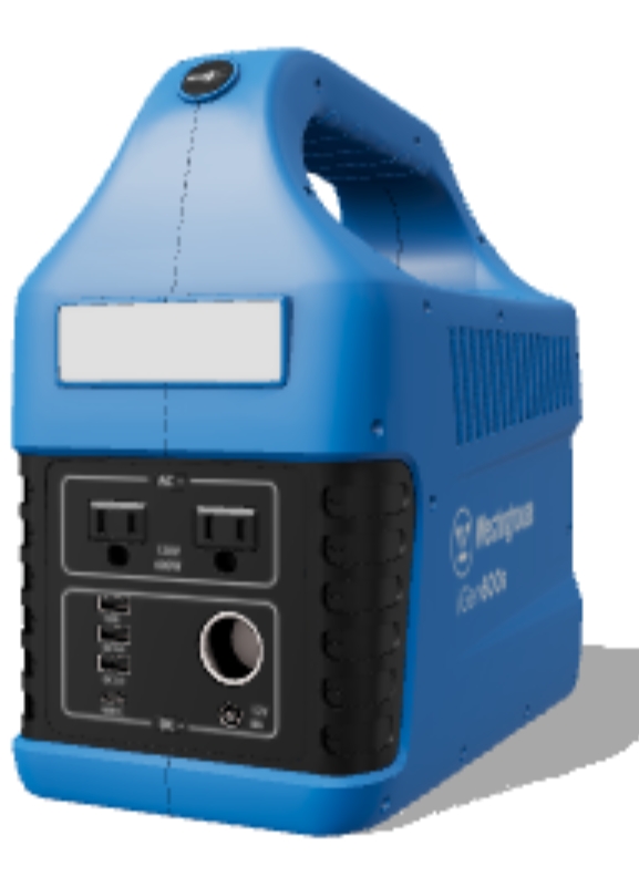

Those "solar generators" are great! I got one for my BIL who works storm outages. His wife liked it so much she took it from him! 🤣 Those will charge off of a 12v source, too, in case solar fails you.

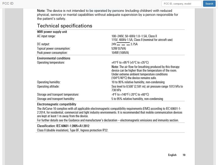

@superj : If you need a manual for the machine, as long as you have an FCC ID number, you can get manuals and other information from the FCC website. Just google "FCC ID lookup" to find their website. If they got it, you can download it as a .pdf.
I just checked if there was a manual for your CPAP machine at the FCC, and this is a screen shot I made of the manual page for specifications showing your power supply's AC voltage input:
Best way to run cpap while camping?
HTH
The AC power supply will often be a bit oversized for the device it's powering, especially on a medical device. What the actual device needs is 90 watts (24v x 3.75a). The power supply won't be 100% efficient, but it'll be well over 80%, so given that that spec sheet claims 104 watts MAX, I think you could plan your power budget for 120 watts and be pretty safe.

For a one-off trip, it might be just as easy (although I don't know about price) going with one of those big charge banks/"solar generators" (as some companies call them and as mentioned above) that can accept solar panel inputs for charging as well as other charging methods, wall power, cigar lighter etc.

This is a step above the one I bought my BIL. However, the one I got him looks like it may only barely meet your needs.
