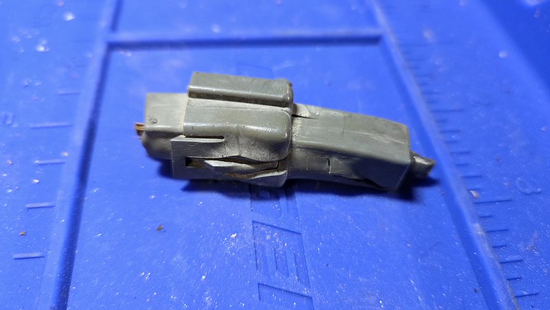

Be aware, the wiring system in your truck isn't really rated for much more than what your stock alternator made. I melted a connector on the DS inner fender for the wire that IIRC goes to the battery and it bricked my truck. No power to anything.

That was with a 135A Explorer alternator.
