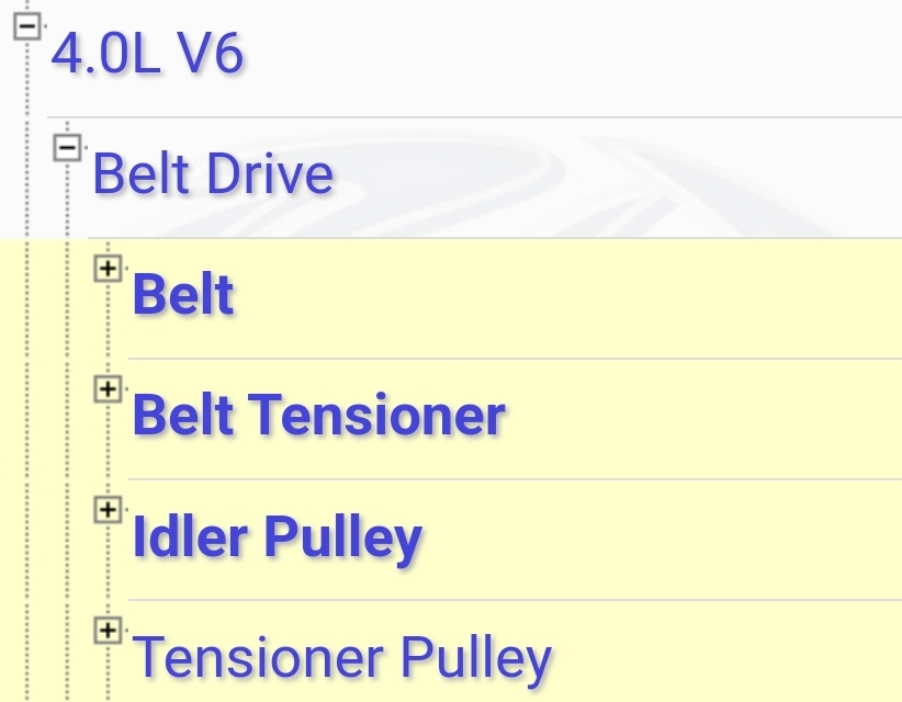

Yeah, Methinks it's the Idler pulley bearings or the actual alternator bearings. I appreciate the input. I'll keep it monitored and to be proactive, I'll just go ahead and order the idler pulley on Rock Auto. There probably cheap enough anyways. It's good to have on hand regardless
Facing the front of the 4.0l OHV engine the tensioner pulley is below the Alternator and the idler pulley is to the right of alternator
Question- Would I just order the whole belt tensioner unit or the individual bearing pulleys. They sell them separately. Maybe I'll just get both the idler pulley and the tensioner pulley.

I geenrally order the idler pulley and the tensioner pulley. If you are in a rust belt area, it might be wise to order the entire tensioner assembly so that you know there isn't any binding preventing it from properly tensioning the belt.
