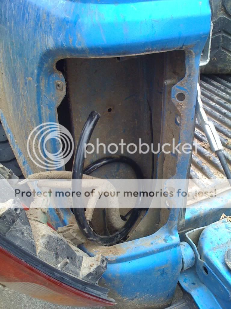

Relocated the rear axle breather tube, still need to do the front. And I got all of the parts for my snorkel to be finished.

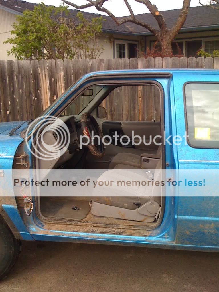

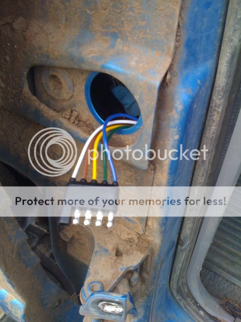

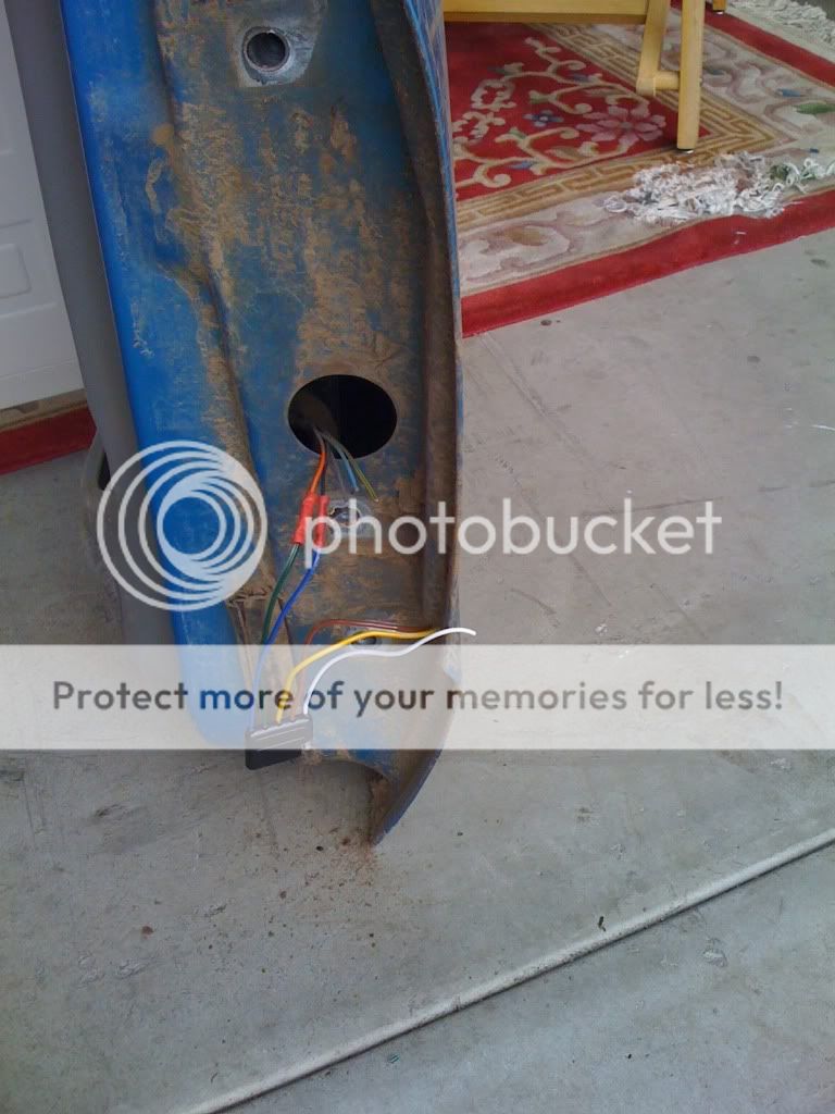

Did a little work today, made my driver door removable, used a 5 wire trailer plug set up for the wiring. And I need to replace the pins with ones with cotter pins.

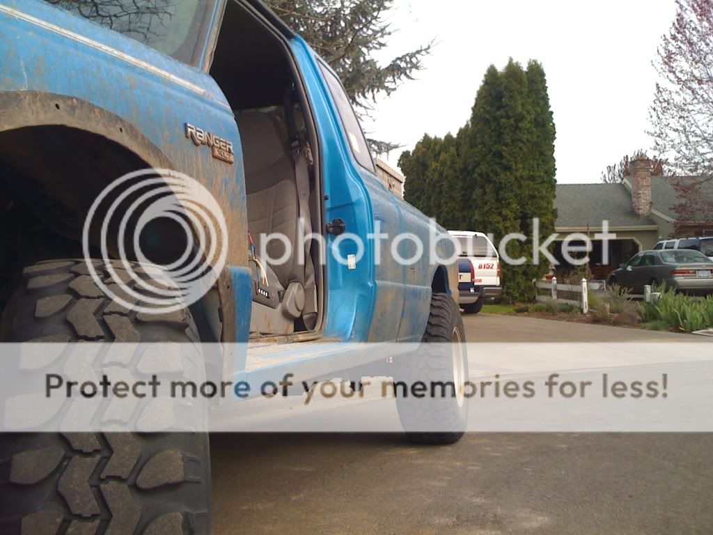

sweet sweet.
Doorless wheelin fun.
Doorless muddin miserable.
funny to see the jeep guy's on some of the snotier trail's with their duct tape out tryin to seal em up
Haha, yea I'm not planning on running it doorless till the summer when it completely dries out
