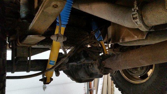

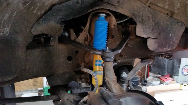

The truck has been riding worse and worse lately, so I decided it was time for a mild suspension refresh. New bilstein shocks, sway bar links, and upper control arms as the ball joints were a touch sloppy. Worlds better now!

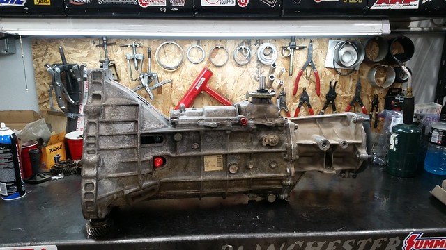

I've decided that for what I do with the truck on a daily basis, the M5OD/1354 gearing just doesn't work for me and I want to change it. Going any shorter in the rear end gears or putting in a crawl box just aren't the correct answers either. I've decided to swap to a Jeep NSG370 6 speed and Rubicon 4:1 transfer case. That will give me a 4.46:1 first gear vs the current 3.4:1.
So my whole adapter kit, starter, clutch, flywheel, 4.0L transmission, FX4 boots/shifters, complete spare good m5od guts, spare electric shift 1354, and manual 1354 transfer case with CV front output are for sale. I figure about $2200 is a fair price for all the items together. Trans and tcase shift smoothly with no scary noises.

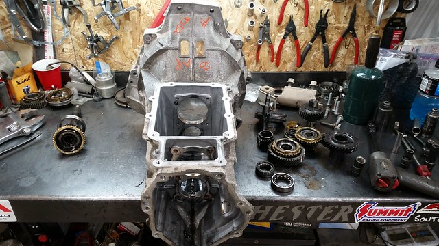

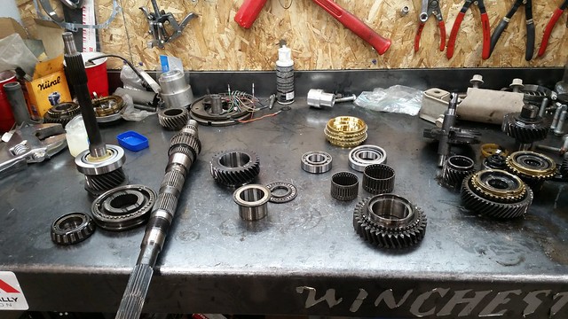

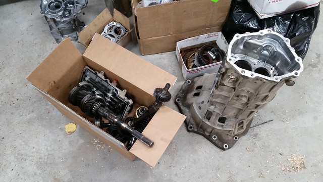

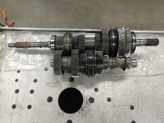

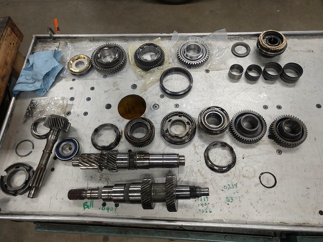

Finally collected all the pieces to rebuild my nsg370 for the ranger. My "good condition" core turned out to be total junk, but it's brand new now basically. New reverse, 1st, and 2nd gears, new reverse syncro hub/sleeve, new 1-2 sleeve, new shaft bearings, and carbon tech full syncro kit. Now I just need to finish designing the parts to fix the internal shift linkage to get rid of all the plastic in dumb places.
I just swapped in my spare nv3500 last week. If only there was a fifth gear swap available for them. Looks like the ratios of the NSG370 is my next best bet if and when this one dies.

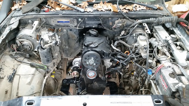

Lots of progress now!

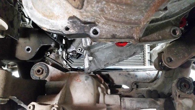

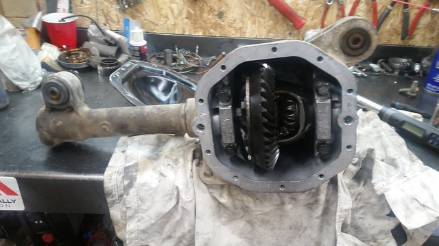

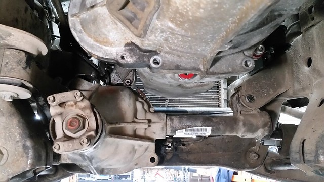

Since you have to drop the front diff to get to the driver side motor mount bolt anyway, figured it was a good time to clean up the 4.10 junkyard front end and put it in.

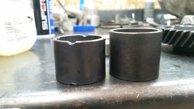

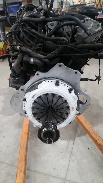

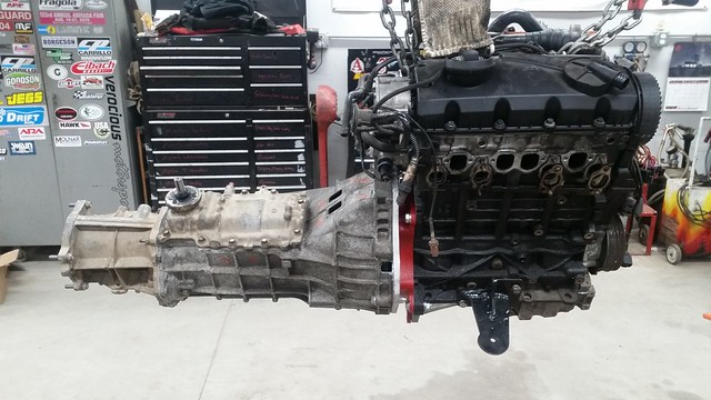

The adapter kit is set up to use a 4.0L clutch, flywheel, and trans. So I snagged a 2010 4.0L 5 speed trans as my truck was a 3.0L. I pulled both transmissions down to install my shorter 3.0L 1st-3rd gear in the 4.0L trans with all new syncros, bearings, and swapped over my tailhousing with t case linkage mounts. I use this as a work truck out in the woods, so I wanted the lower first gear (3.7 vs 3.4). The only difference I found between the two transmission is the spacer that goes between 5th and reverse. Otherwise, everything was identical.
Adapter kit mounted up perfectly!

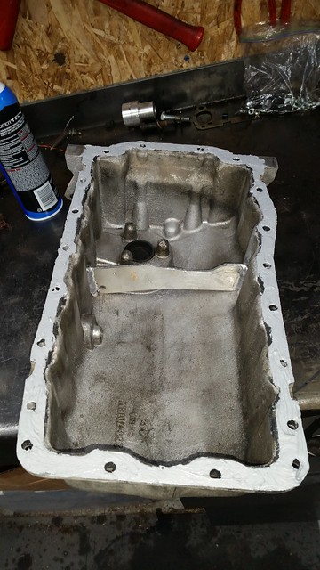

Had a slight interference issue between the front diff and the passat oil pan, so off to the parts stash for a jetta oil pickup and pan!
Quick baffle
Much more betterer!
Looks so little in there :D
I’m assuming you have to cut some of the transmission was to clear the new starter location? I’m custom making my own adapter plate and the starter location is my biggest problem currently. I don’t want to weaken the transmission overly, but that starter location is the only option.
