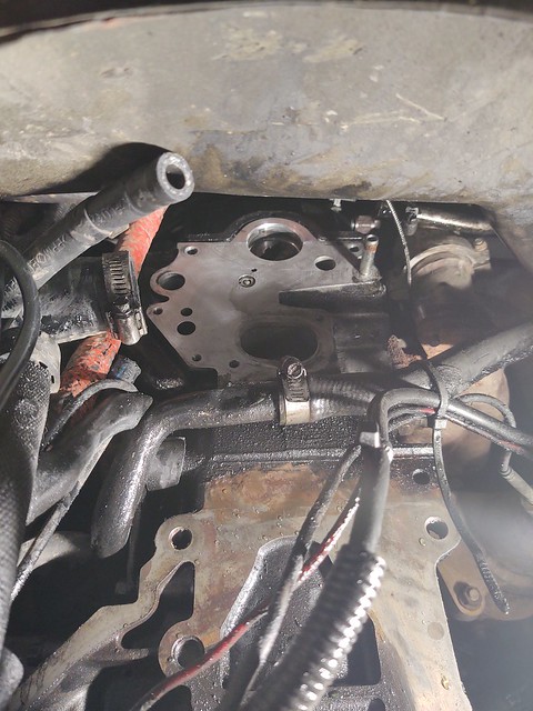

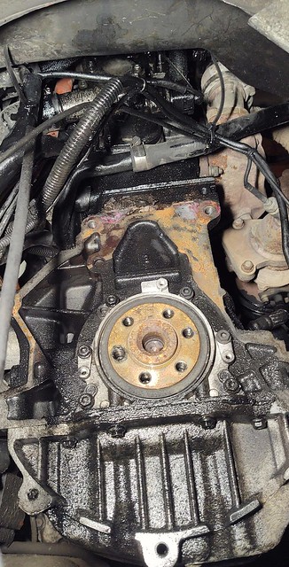

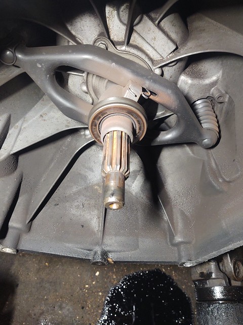

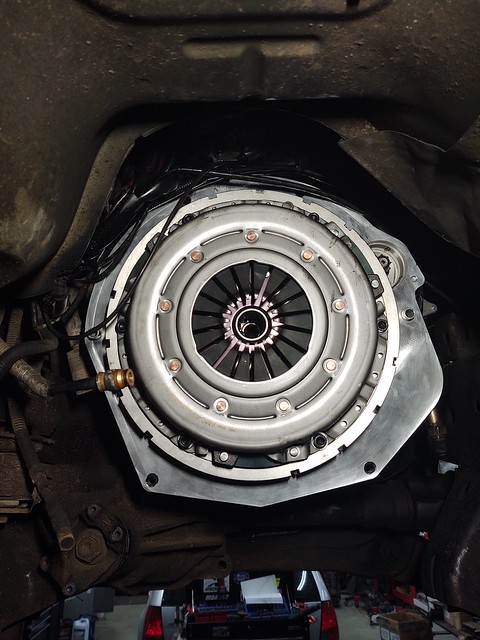

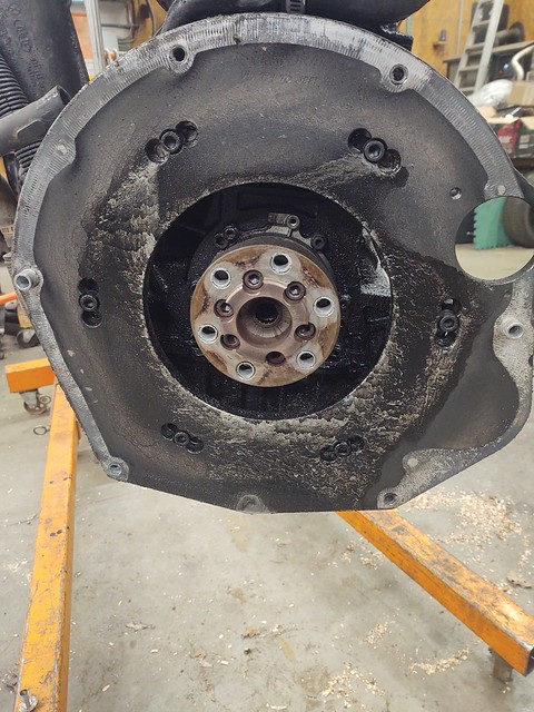

I’m assuming you have to cut some of the transmission was to clear the new starter location? I’m custom making my own adapter plate and the starter location is my biggest problem currently. I don’t want to weaken the transmission overly, but that starter location is the only option.
Yes, if you look closely, the bellhousing is notched for the starter pinion. No problems since.

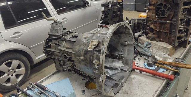

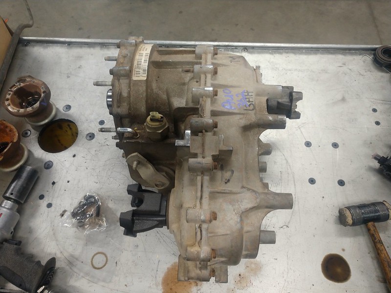

All the parts are ready to swap the nsg370/241OR in the ranger! I sold the ranger transmission/tcase and ford 4L adapter kit off with all the spare parts so it's time to get busy.

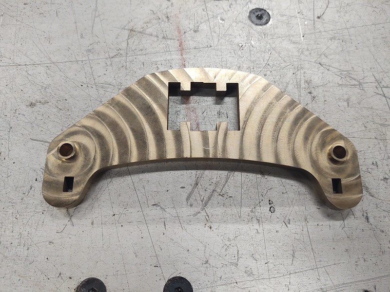

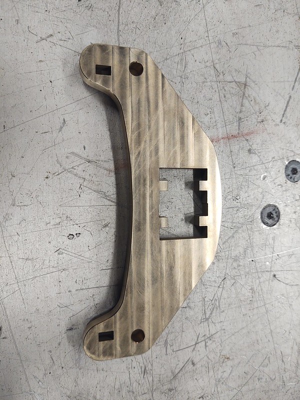

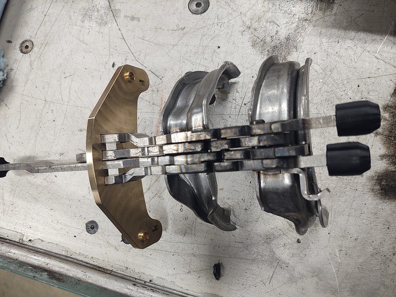

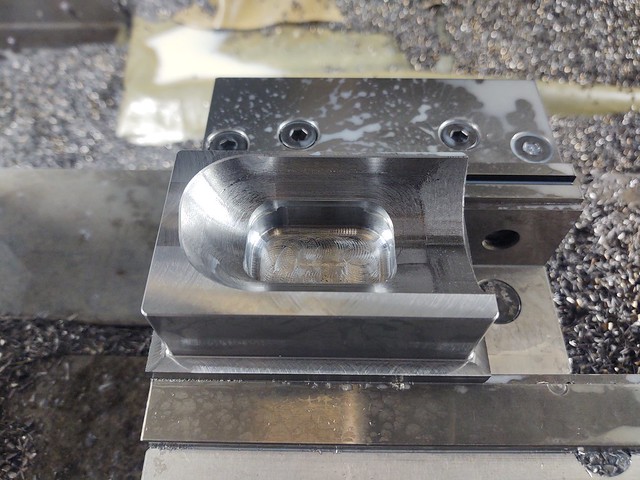

The last part I had to make was the shift rail support for the jeep trans. The factory setup has molded plastic on a thin piece of stamped steel that guides the 4 shift rails. When the plastic breaks, the rails fall out of alignment and cause all partial engagement/popping out of gear issues that nsg370's have a reputation for. This is cnc'ed out of 954 bronze and double the thickness of the oem plastic part.
Broken oem shift rail support
New shiny parts

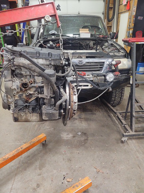

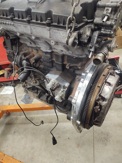

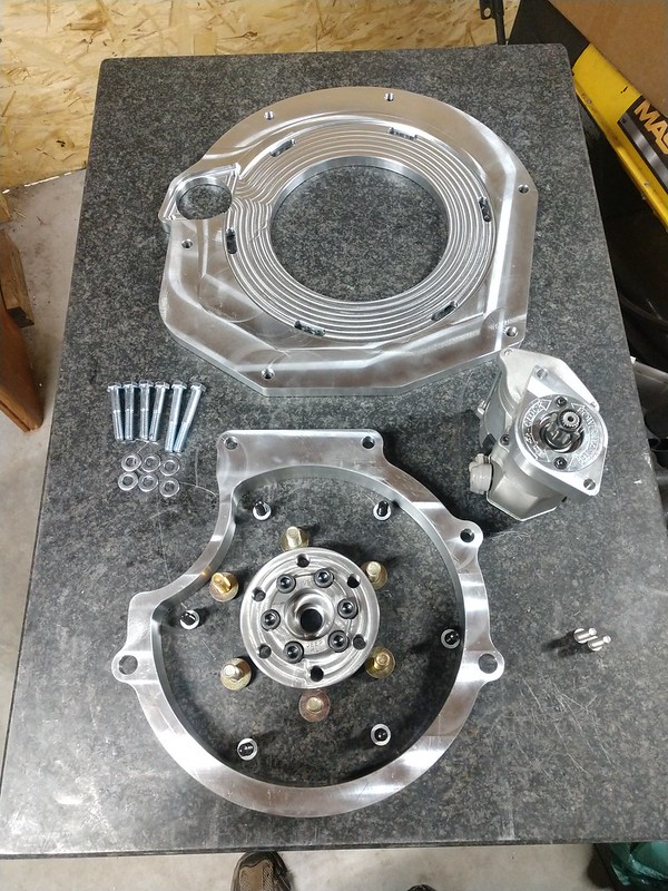

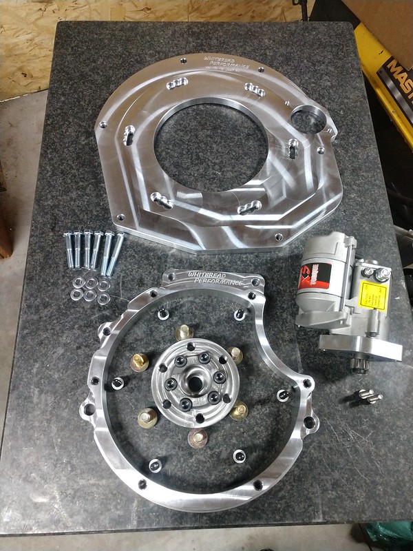

A few weeks back I finished development of my tdi to 4L jeep adapter kit, will hopefully bolt it on on sunday!
:iamwithstupid:
Very nice work.
Thanks for the kind words guys! I didn't quite get the trans in today, but I did get the leaking vacuum/fuel pump resealed, leaking water neck o ring changed, and adapter kit/starter all installed and torqued up. Trans is going in first thing in the morning!
The black hole
Resealed vac/fuel pump
It all fits!

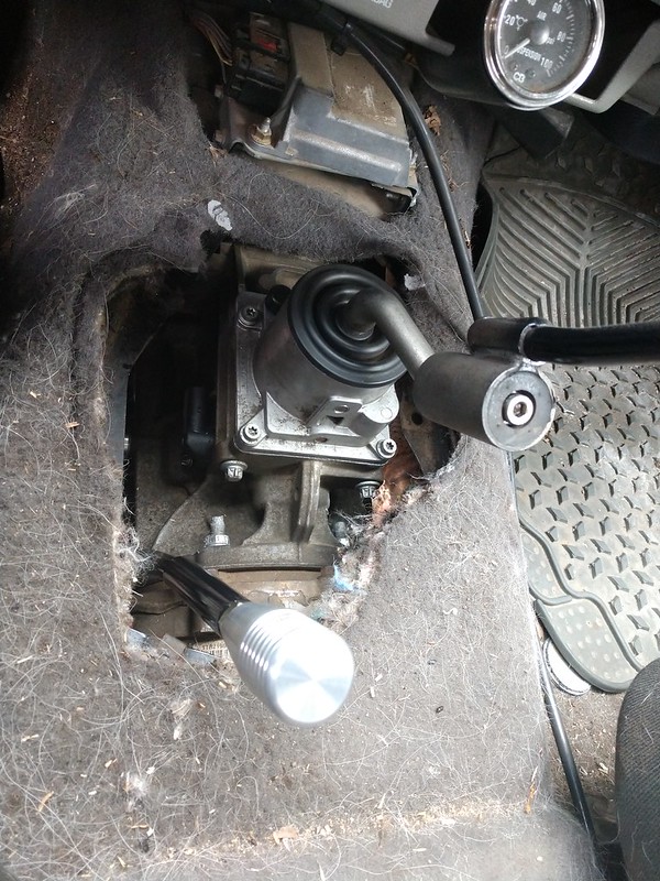

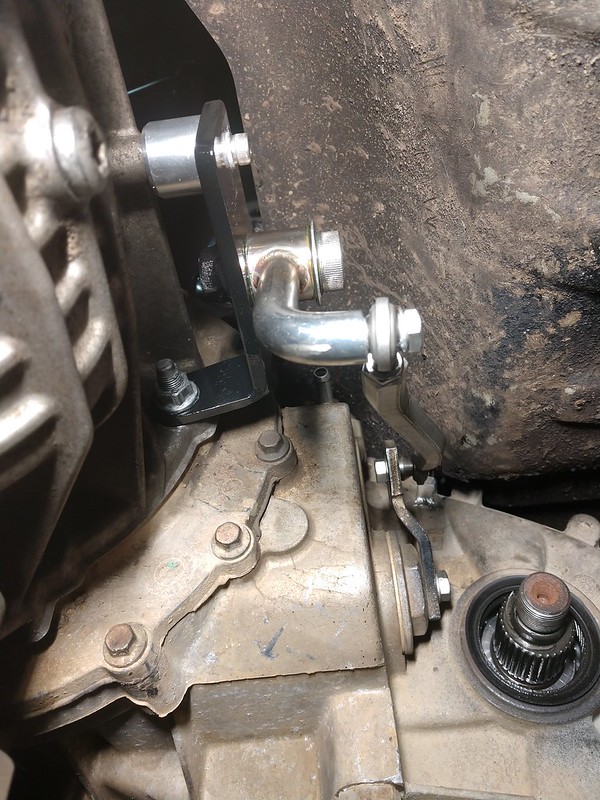

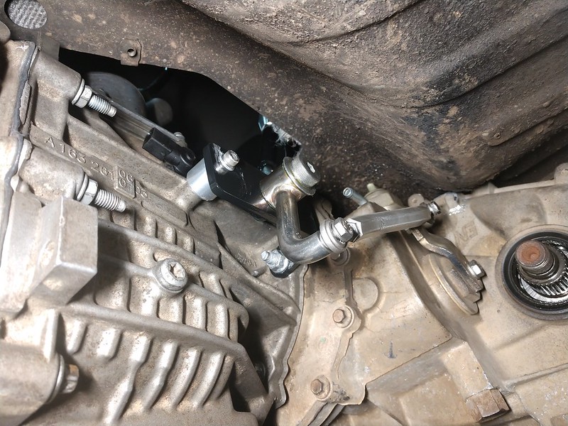

For the transfer case shifter, I whipped up a linkage using some 1/4" rod ends and other bits laying around the shop. Rummaging in the scrap bin, I found a nice 1.25" chunk of round that made a perfect shift knob. The pivot has a teflon bushing pressed in riding on a stainless shoulder bolt and it works very smoothly without being floppy. Last things to do are connect the reverse lights, cut holes in the 2wd auto floor plate, install junkyard sourced 2wd auto rubber floor mat in place of nasty carpet, and install the chevy squarebody shiftboots. Just happy to have my truck back!
2 Hi shifter position
4 low shifter position

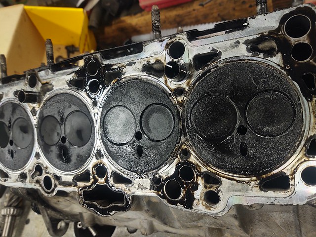

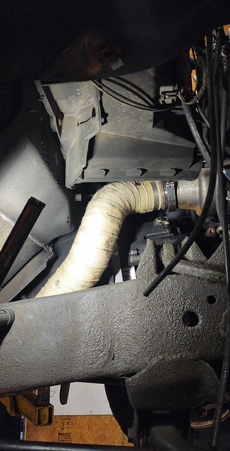

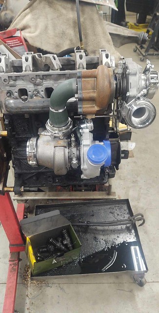

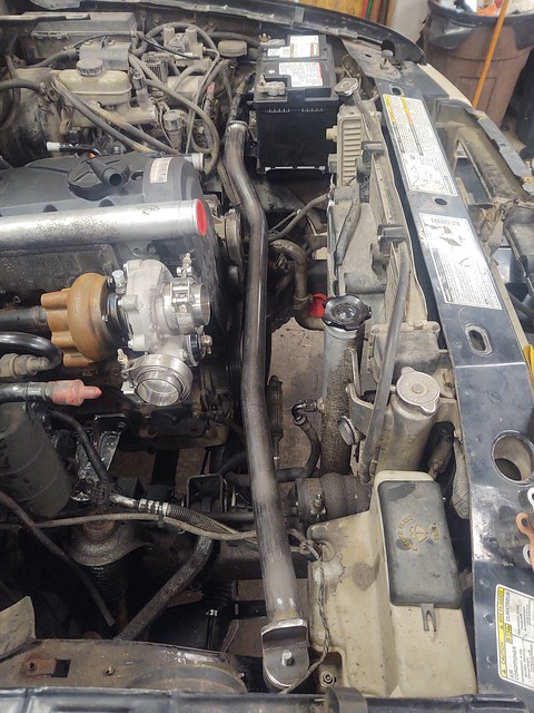

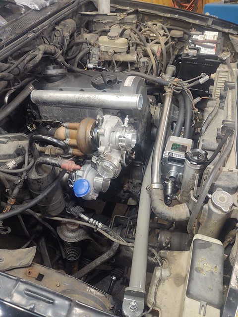

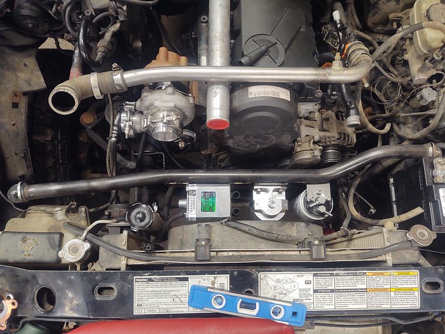

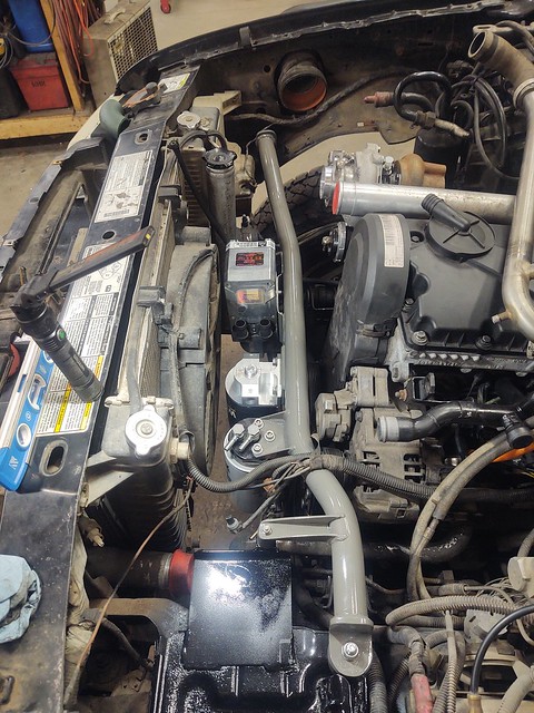

Sooooo a lot has happened since I last posted here. Truck was getting used and abused and having buckets of fun with. About 9 months ago, the original junkyard sourced unopened engine started pressurizing coolant. I was already putting together a fresh built motor as oil usage was increasing and cold starts were getting rough. Zero complaints as that motor had unknown miles to start with and lived through 5 years of 55psi being shoved into it. Pulled it out of the shop tonight on it's own power with the fresh engine for the first time!

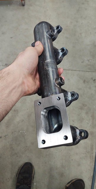

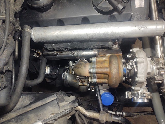

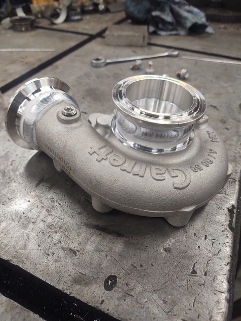

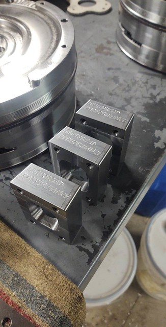

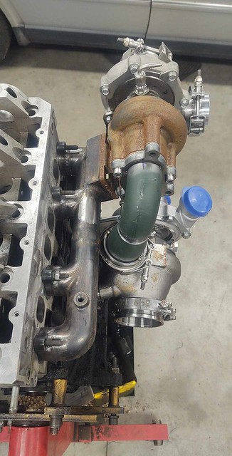

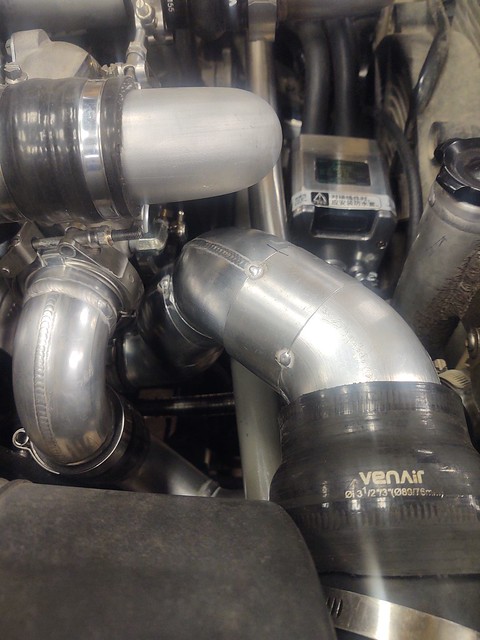

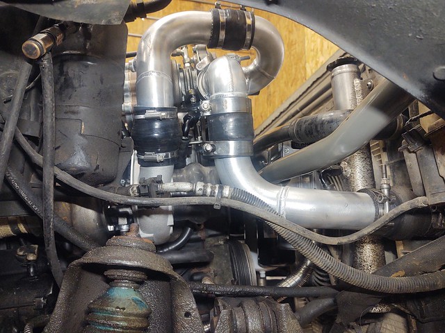

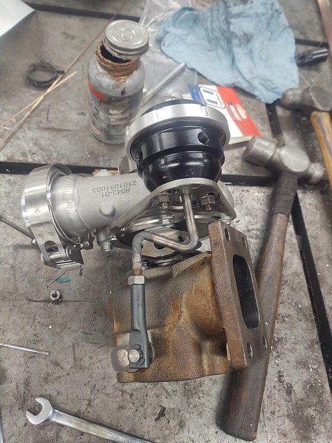

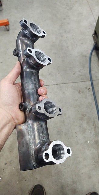

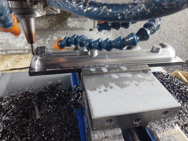

The new motor is the same BHW code engine, but it has Molnar connecting rods, 16.8:1 compression pistons, valve springs, head studs, and now 80% over injectors instead of 40%. Obviously cam, bearings, etc are all fresh and block/head were fully machined. Turbos are a Garrett GBC20-300 and a PSR 3076R. Since I now manufacture remote oil filter plates, I went to a remote filter and air/oil cooler out front for more room next to the engine. Also added a chinese diesel fired coolant heater because they're too cheap not to now.
I tried to find most of the random pictures I took along the way, but there's a photo dump to give a rough idea. Obviously some holes in the timeline haha.
Very first start with no downpipe on https://youtube.com/shorts/p4id16XcWRo?feature=shared
Ignore temporary turbo oil lines, waiting on crimp fittings to arrive.
