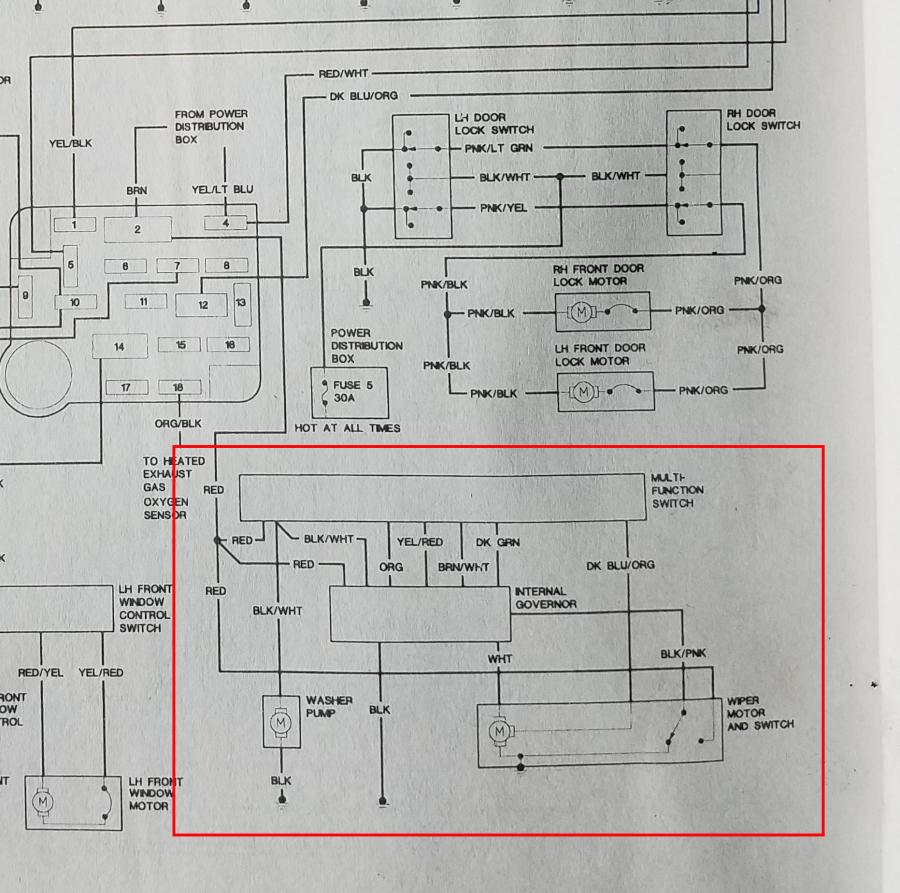

I was originally looking in the "Ford pick-ups and Bronco Haynes Repair manual" which should not be confused with the "Ford Ranger Pick-ups Haynes Repair Manual". In t he diagrams of the correct manual section 12-28 I found the diagram labeled "1994 Body Wiring".
I confirmed the color of wires from the the MFS as in the diagram. The corresponding BLK/PNK is just BLK on the motor, BLU/ORG is just BLU, YEL/RED is just RED.

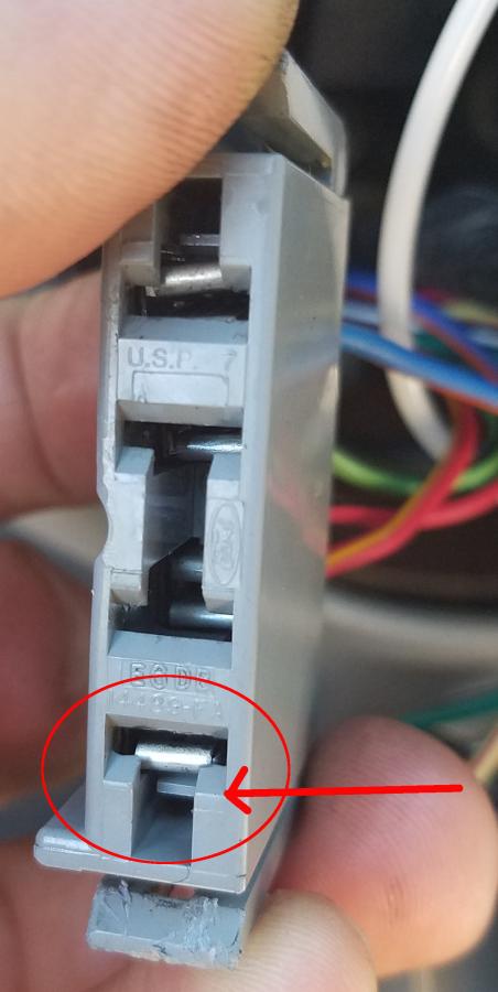

Some of the wires that I think are associated with wiper functionality are not properly seated in the larger grey plastic wire-holder that connects directly to the MFS. It appears there are plastic tabs inside this grey wire-holder that keeps the wire terminals in place that have broken off. Should I replace this? What do I replace it with? I have manually pushed in these wires from the back of the grey plastic wire-holder, but have not done a continuity test to the Wiper Control Module. See attached photo.

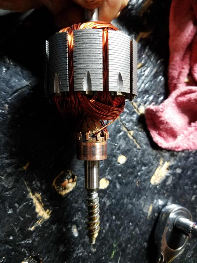

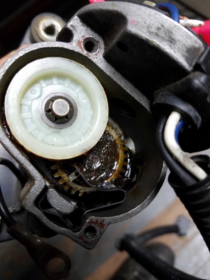

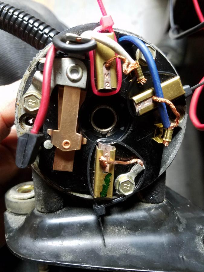

I looked over some other notes from the internet on cleaning electrical motors. After disassembling the slip rings look a little worn, but are still making contact with the commutator. I had a bit of a hard time getting it back together, and it does not rotate after re-assembly so I am going to work on that a bit more. Do you see anything here I should take note of? I visually confirmed functional operation of the internal park switch while rotating the motor.
I also traced the 4 wires leading to the wiper motor and there does not appear to be a short of the Red or DB/O wires coming from the MFS or either of the RED of WHT wires coming from the Internal Governor.
Now that all of the lines are taced to the motor, can anyone recommend the next thing to test? Does anyone have anything to add?
Notes on photos:
I believe these are in the internals referred to by ericbphoto. I dont see anything the matter here.
The stator assembly looks fine to me too.
The slip rings are really worn, but they make contact. I cleaned then and the commutator with Electronic Cleaner.

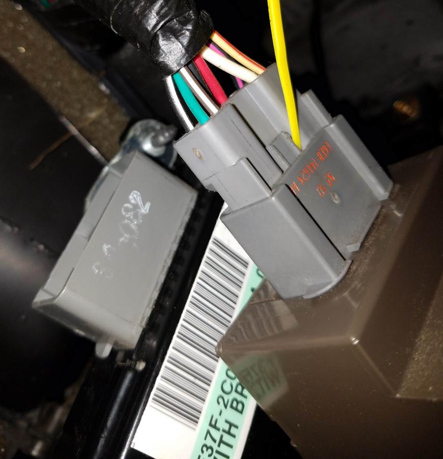

The Internal Governor is the brown box behind the ashtray. You can get to it without removing any of the dash. There is a small clip you have to press in when removing.

I spent a little time studying the diagram today. Here is what I have figured out. From what you are saying, it sounds like your internal governor module is faulty, unless you can find some wiring shorted to ground somewhere.
I took some voltage readings at the motor plug on mine this morning. I verified that in Hi speed, there is 12v going to both Hi and Lo connections on the motor.
