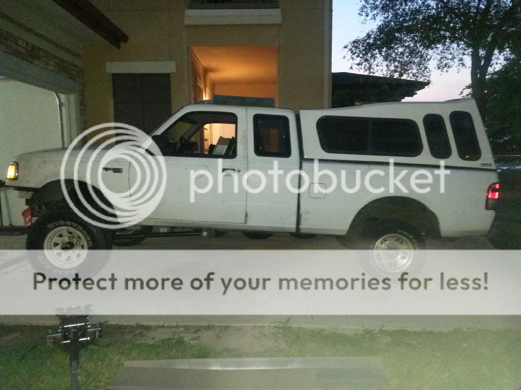

At ride height, my drag link AND track bar are at exactly 8.5*.

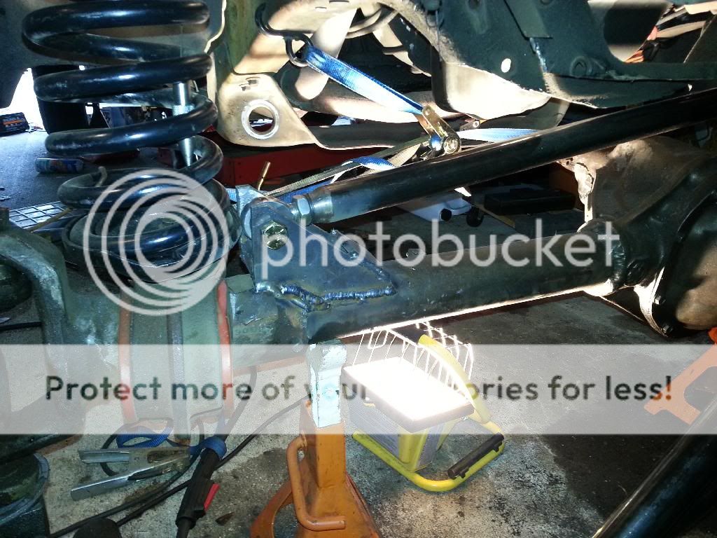

Anyway, here's the completed lower track bar bracket.

I like your trackbar bracket. Looks good.
My welds were good but didn't look pretty, and my overhead and vertical welds were crap. I was using the wrong technique and now all my welds are beautiful.

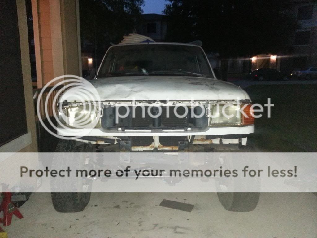

This thing is going to look goofy as fawk once I put these tires on it. I don't have the rear axle in yet so I'm going to have a huge baja rake up front with large tires and an itty bitty rearend with small tires.
Still not finished with the rear axle. The tires up front are some shitty 32" rollers. I still have silly little stock tires in the rear. :)

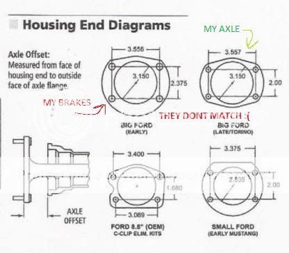

Found another obstacle. I went and picked up the drum brake assemblies long ago from the junkyard. After cleaning them up I discovered to my dismay that the bolt pattern for attaching them to the axles is wrong! Nooooo!
I think I'm going to use my drill press and try to correct the matter, but it's definitely a pain.
Armadillon's FW Ranger D44/Ford 9"
UPDATE: Fawk this. Drilling holes and trying to mount it was a terrible idea. I do not recommend. I'm going to the junkyard to just find the right mounting plates.
