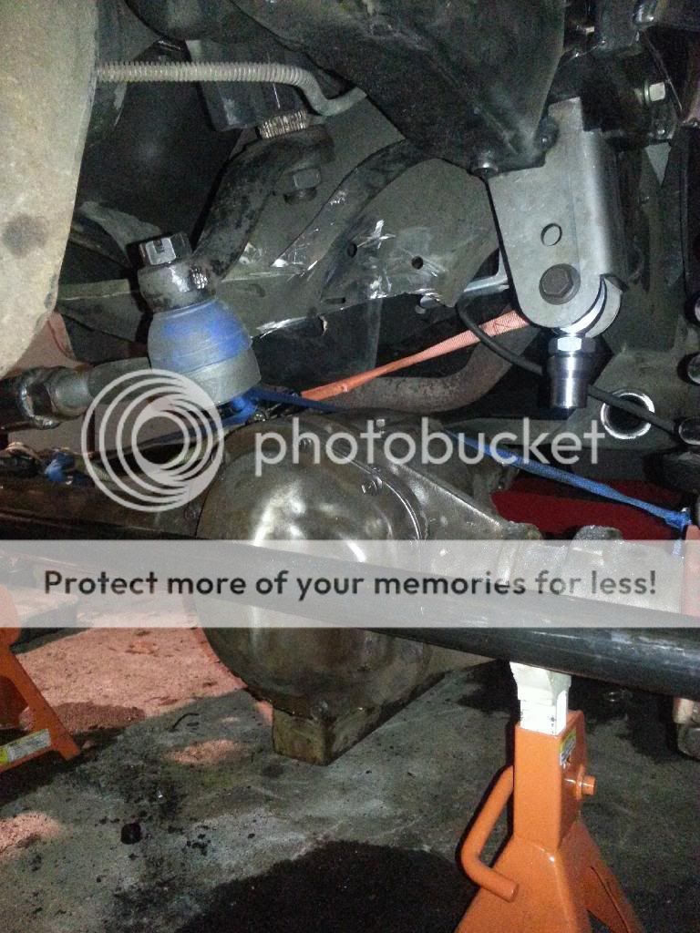

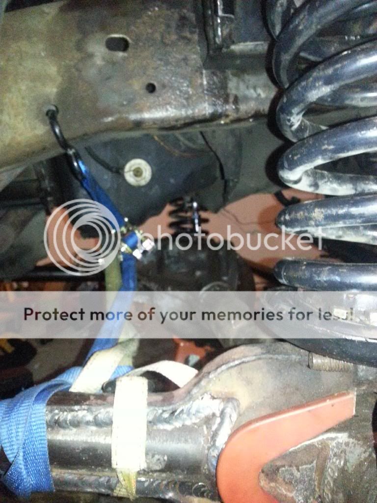

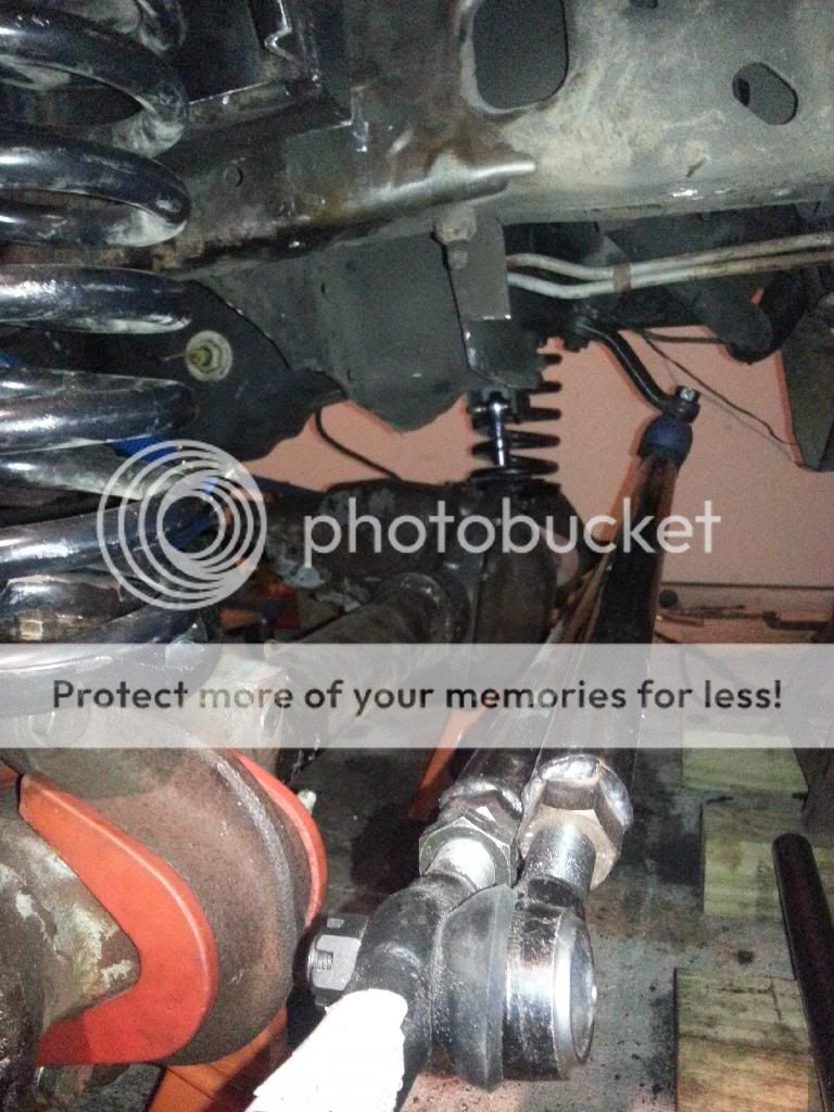

Trackbar mount time. Now that it's on it's own weight, I'm a little worried about clearance. I'm using 3.5" EB coils and I feel it's pretty tight under there. In the third picture you can see the heim joint hanging down from where the mount is. I'll be replacing the crossmember with something more sturdy eventually.
What do y'all think? Enough clearance?

After you get your engine cm fixed I think you will have enough clearance. You'll only have roughly 4" of up travel so you shouldn't hit the diff on the TA. You could build a new lower TA bracket and weld it to the axle tube. Probably oughta put a bump stop in to keep the axel from makin contact with the upper TA bracket when you hit a bad bump.

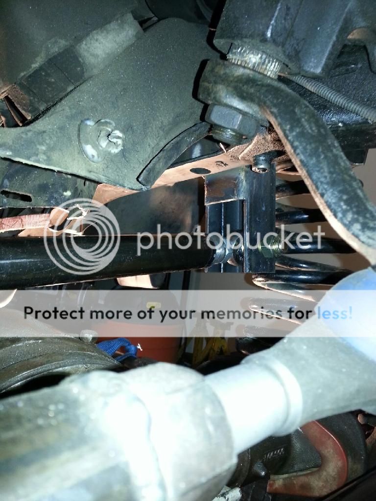

Sounds good. I'll be doing the trackbar and axle side mount this evening. I was going to order one from RuffStuff but I don't need one that tall. Glad I have a bunch of .25 plate lying around.

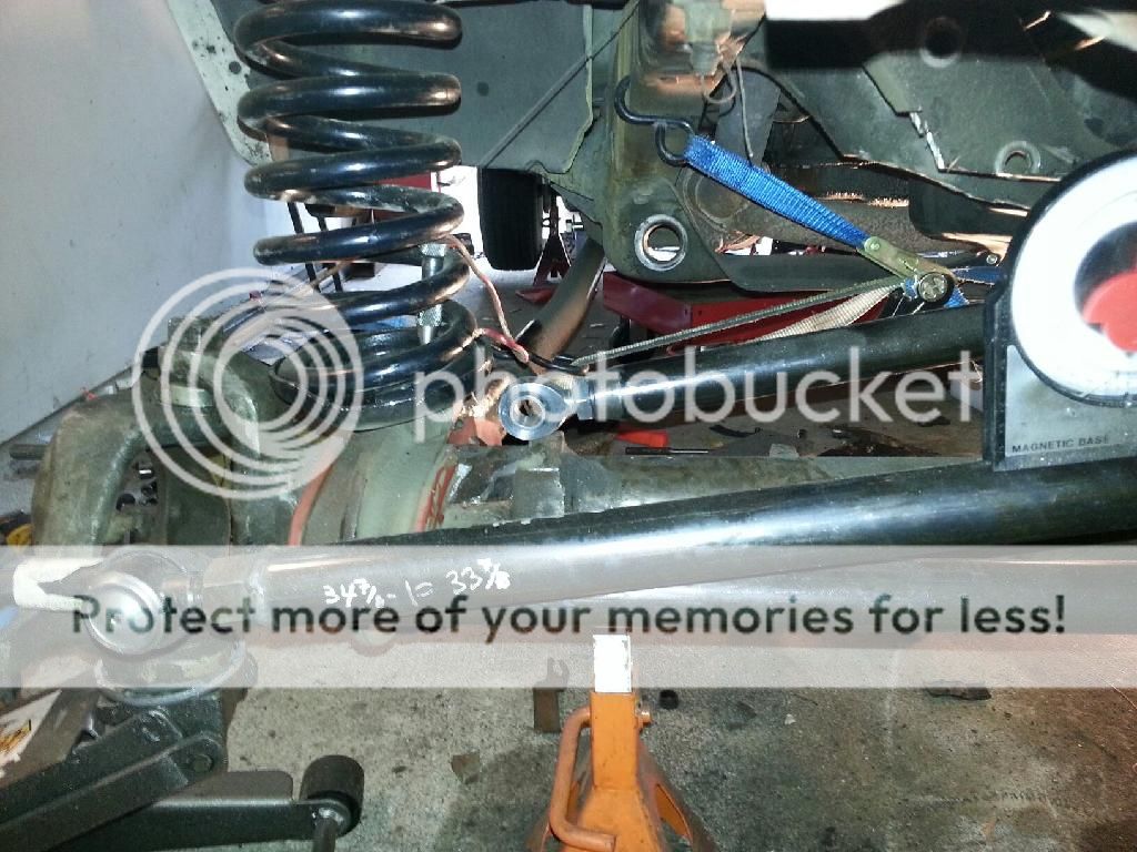

I'm attempting to finish my track bar, and I realized my axle side trackbar mount may be right on top of where the wedge is. In the first picture of my last post, you can see where I cut off the bolt for the original track bar mount. I can reuse it, but I don't like the idea of it being in single shear. I've noticed a few other builds where the track bar was bolted directly to the original axle side mount but not one person braced it.
Am I not searching hard enough?
I recommend to always brace whatever you build. It's the "just incase" factor. All it would take is slipping off one rock and sliding sideways into another rock to bust stuff.
Right. I'll see if there is a way to brace it.
Rowdy, have you ever welded to the actual wedge itself?
There's been a couple that have used the original axle tracbar mount, and double sheared it. Ford designed it to last, I doubt it would fail, havent heard of one failing...

Here is the issue I ran into. My track bar from eye to eye is exactly the same length as my draglink. The end of my draglink is right above my wedge, but I couldn't use the OEM mount point because it was too low. In hindsight, I could have used it and just lowered my axleside mount, but I wasn't comfortable with it.

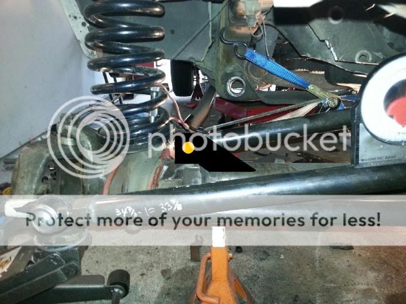

This was my idea for the lower mount. I want the strongest point to be welded to the axle tube since I haven't heard the greatest things about welding to the wedge (which is apparently cast steel?
I would weld to the wedge anyway, but this way the weld on the tube would be the strongest point and any strength from the welds on the wedge would be extra.

That looks like a pretty good idea to me!
I surprisingly did not have any problem welding to wedge and I did not even have to heat it up (probably got lucky..... lol). But I would differently go with your drawing. :icon_thumby:
