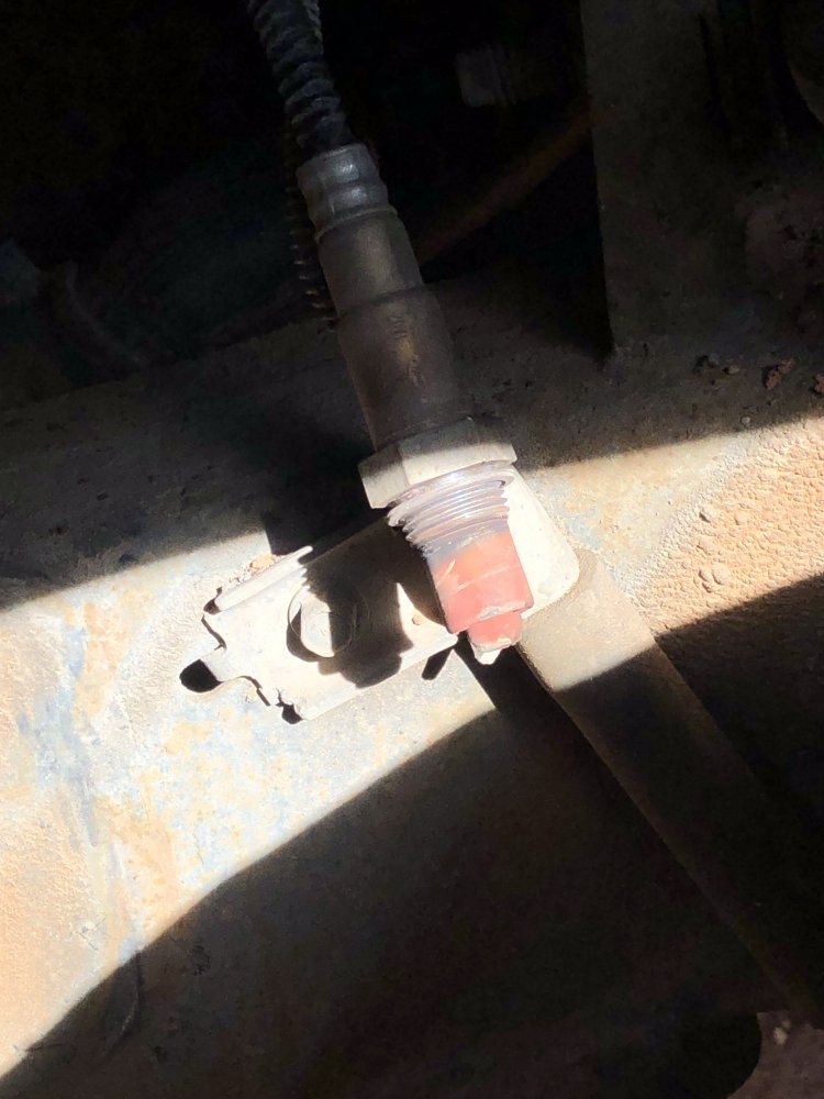

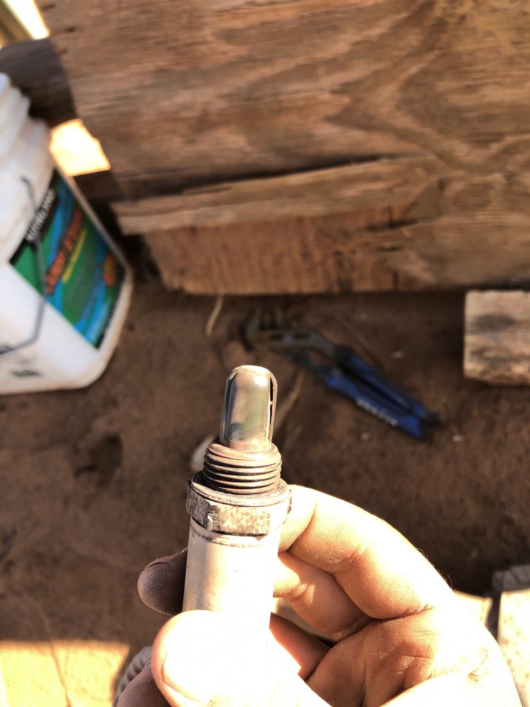

I can’t tell if all 3 are bad or if they’re alright

It's near impossible to tell by looking at any o2 sensors. The best way to know is to hook them up and run through the drive cycle governing o2 sensor tests. You can do this with a scan tool or by clearing the PCM and looking up the emissions self-test driving cycles for the rig you're testing with. If they work, your truck won't throw a code; if they don't work, your CEL will come on. Make sure you are running wide band sensors with wide band EECs and narrow band sensors in narrow band EECs or you'll throw codes regardless.
That said; the one at right looks to be in best condition.
What he said, you can't tell if an o2 sensor is good or bad by looking at it. There is a procedure for testing them off the vehicle that involves a blow torch and a multimeter...
Since you have them out, it won't hurt to clean them up a bit with some green scotch brite and spray them off with some break cleaner. Are you getting codes right now? If so, what are the codes? That will help us point you the direction where to go. One thing of note, when I have an O2 sensor code on my 2011, it turned out the driver's side catalytic converter was going bad. Research on the specific code on sites dedicated to Ford Rangers indicated it was a cat problem and not a senor problem. Also, just before the code was thrown, my gas mileage suddenly became much better than it normally would be. A big indicator something was up. I changed the cat, clear the code and the problem was fixed. I also chose not to go with an OEM cat but one from Rock Auto (Walker I think). It was much cheaper than what the OEM Ford one was and hasn't been a problem.
