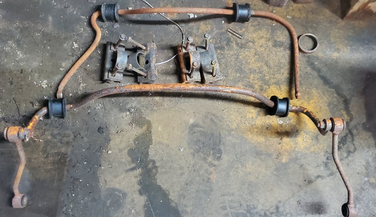

Random one I found while digging through parts. Top one I'm almost positive is a stock ranger one. Bottom one... tbh I can't remember what I pulled it off of.
I think its Ford.
Expo? Aftermarket?
Anyone recognize this sway bar?
Bottom kind of looks like Explorer, it is also wider would correlate with the wider frame of an Explorer.
If the bottom one is RBV, it's from an Explorer. Rangers and BIIs had shocks on opposite sides of the axle (1fwd, 1aft) and the bar was bent to clear the front one. Explorers had both shocks behind the axle and didn't have the bend for clearance.
Explorer would make the most sense... couldn't remember where I snagged it from. Must have come in with the expo 8.8 that's laying here.
Thank you!
Kind of, the sway bar was also behind the axle though. Bends look different than PJ's though.

F150?
I bent one to fit my race truck. Tho I don't remember details.
I'd day it looks a lot like an Explorer rear anti-sway bar.

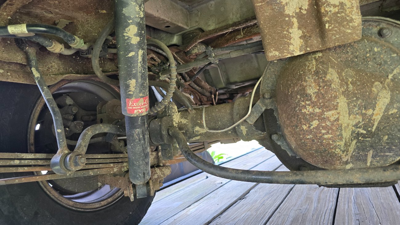

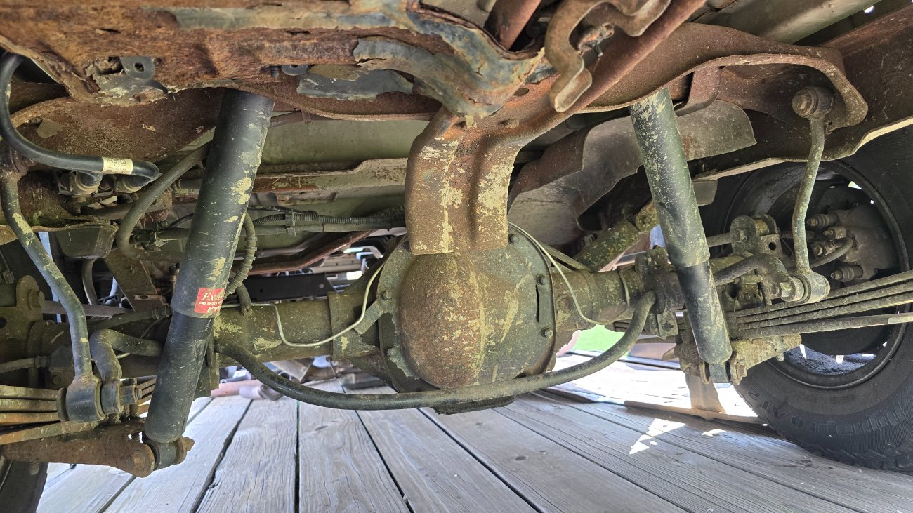

They do work well in an Explorer... but they are 5000lb pigs... the V8 ones do drive nice though with a shift kit, not as great towing a boat with a welded diff...
Hm. Wonder if it'll fit in the 2011... probably not with shock mounts.
shocks, like brakes, are optional... might be a highly preferred option :).
Plus anything will fit if you use it just wrong enough... add a welder, some duct tape and some baling twine and you can make almost anything work...
They work but the mounts are welded onto the axle.
For shocks I think you can use two of one side of the Explorer leaf backing plates and run the shocks there instead of to the axle.
