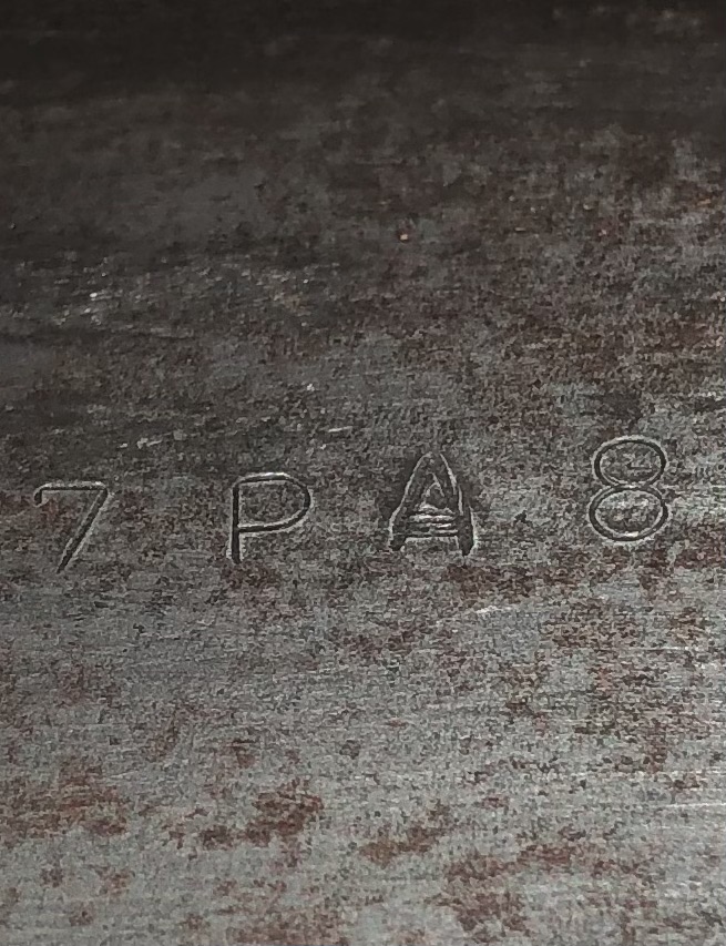

I ordered a punch set off Amazon which arrived the next day. A video on YouTube of a UK Ranger showed the numbers, and it really just looks like it was done with a stamp kit. I think the key thing is to get the numbers very straight in line and evenly spaced. Then to disguise it to make it look old, which should be easy because there was enough crap and thin undercoating to say to them that it was buried under the undercoating, and I had to strip it away to find the numbers. Of course, the other thing is to make sure you get the alphanumeric sequence correct!!!
I'm going to practice with some random numbers on other parts of the frame first and then make a jig to ensure I get them straight and even. I'll let you know how it goes from end to end.

Well . . . IT WORKED!! :ROFLMAO:
Even despite me messing up the final number a bit! I used a piece of aluminum angle, a piece of aluminum bar and 3 clamps. The angle piece helped me keep things in a straight line and the stamp shaft 90 degrees to the frame and straight on. The bar helped me keep it horizontally oriented and from moving with repeated hammerings to get the number/letter to show up enough. I moved the bar along the angle the width of a stamp shaft each time that I finished a digit or letter, so that they would be evenly spaced. I carefully laid out the stamps in the correct order and orientation and checked it multiple times throughout the entire process to ensure I got it correctly matching.
The Ficha Technica said it was located on the right frame member. The challenge came in that there was little room to swing a hammer anywhere to make the stamps very deep. So, I had to do it on the side of the frame just under the passenger seat where I know it appears on UK vehicles. That was the only place I had just enough room to swing, and it was marginal. But I was able to get the digits at least deep enough to hold some paint. Unfortunately, the jig moved on me before I realized it on the final digit. I was able to recover, but barely. It just looked like I messed it up with the scraper trying to find the numbers. 🤥
I scraped right down to bare metal before starting which turned out the best anyway due the shallowness of the depressions. That also gave me the excuse to say why we couldn't find it the first time (due to buildup of paint, undercoating and dirt). Then I sprayed black paint over the numbers, waited about 5 min for it to partially dry, then wiped off the excess with a paper towel dampened with solvent. The result looked somewhat convincing.
