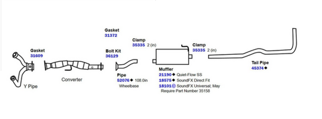

Seems to me that factory-style y pipes are available for Rangers but only for 4.0l trucks and 3.0l trucks after '98. I can't seem to find anything that says it fits a '95 3.0l. If anyone could point me in the right direction, I'd appreciate it. Or tell me that a 4.0l y-pipe will fit fine or that one for a '94 will fit fine. The y-pipe on my truck was butchered by the previous owner so he could delete the cat and weld in a flowmaster. I prefer things to be stock and enjoy having cleaner, quieter exhaust with working O2 sensors.
Looks like the cat is separate from the y-pipe. I don't see it readily available so this may be a junkyard item.

Yeah the cat bolts to a flange at the back of the pipe which is why mine is shot. I suppose I could cut the entire flange off and simply weld them together but I'd really prefer a bolted connection.
