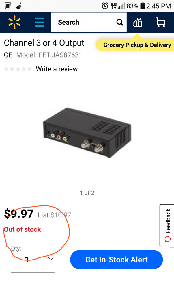

If you only have coax input then you need an RF modulator, takes Composite Video/audio and puts it on channel 3 or 4 so TV tuner can display it
Seen here: https://www.walmart.com/ip/GE-87631-RF-Modulator-W-Selectable-Channel-3-or-4-Output/17473923
An old VCR can often be used as a channel 3/4 modulator if it has yellow/red/white inputs on the back
You stll need the HDMI to composite converter
Link shows as out if stock....must be a lot of people out there with old tv's getting ready....lol.
