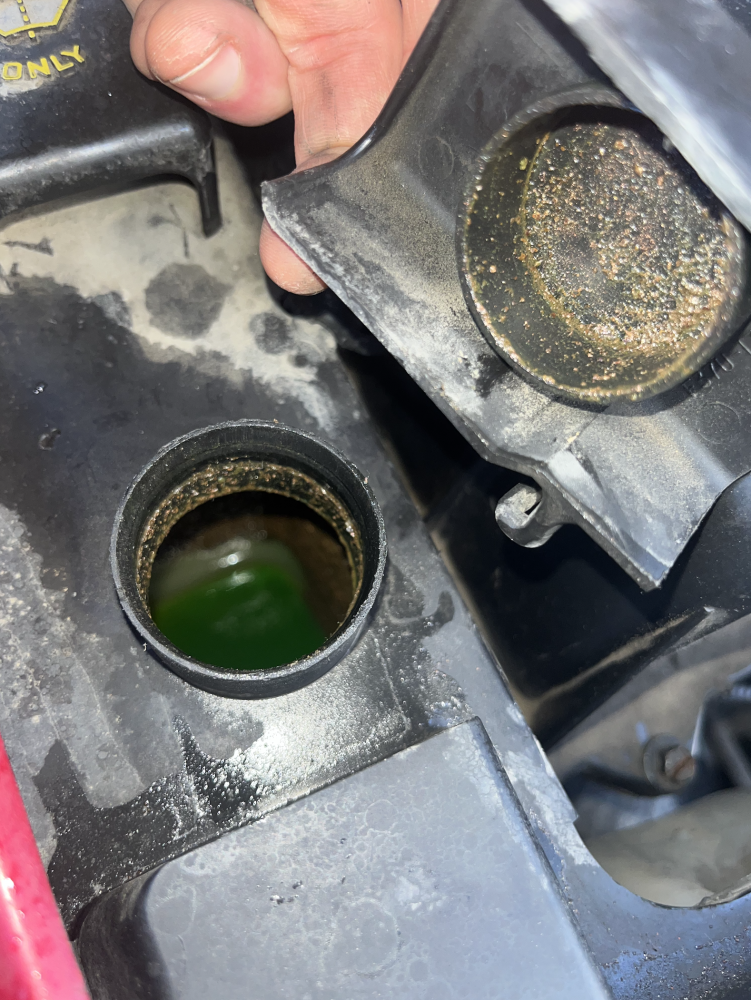

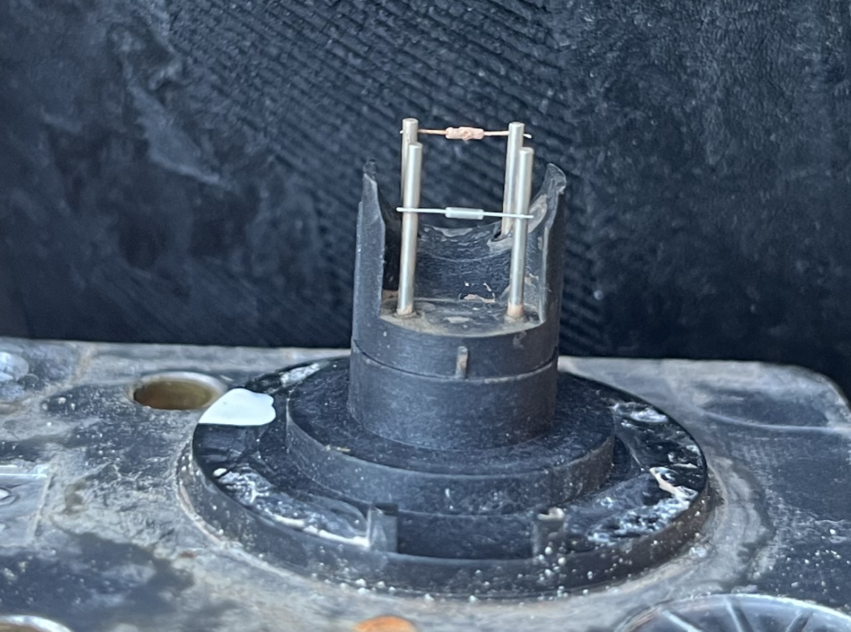

Just purchased a '93 Ranger with minimal history and maintenance. There's a lot of ticking from the engine, maybe bad lifters, that have quieted down ~20% after two rounds of seafoam in crankcase/fuel/intake. I've also replaced the air filter (there was a large crack in the top of the air filter housing on the clean side that I've taped up, let me know if you have a spare you want to sell me!). And I just cleaned out the MAF sensor with MAF cleaner, although that may need to be replaced (see MAF sensor picture attached).

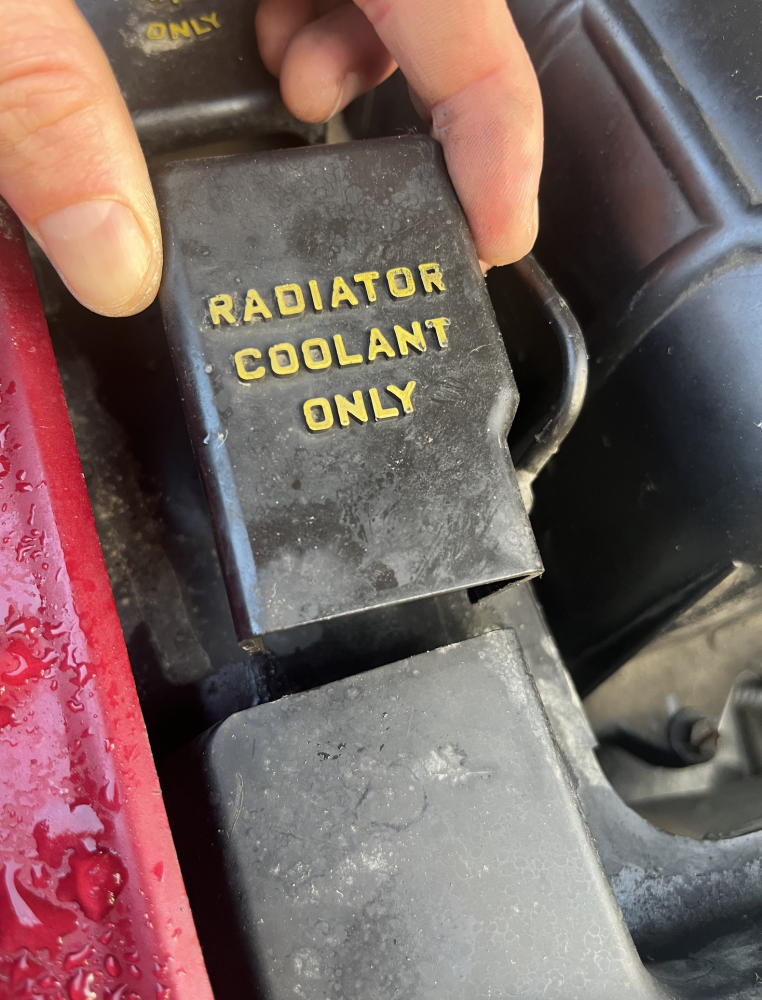

Next up I checked the coolant, and there's a lot of sludge above the coolant level. I imagine a coolant flush is next on my list.
Before I get that started, based on my pictures and descriptions, any tips/advice you'd have about flushing or other suggestions you'd have? Trying my best to keep this thing alive as a noob! Learning a lot. This forum is amazing for people trying to learn.

With so much build up inside, I'm guessing it would be useful to use radiator flush? And likely flush many times with distilled water? Watching some YouTube videos now for learning.
I have a brass garden hose nozzle like the ones below. You can take one of the heater hoses off, take the lower radiator hose off, and then stick that brass nozzle up in the end of the heater hose. Turn it on a little bit, it will run the water through the heater core, through the engine block, and out the lower hose.
Once that is clean, you can put the nozzle in the top of the radiator with cap off and flush it out. If it is really dirty, I recommend you refill with water and drive it, and then flush it again. Of course you can't do this if it's below freezing where you live. Whoops I just looked, you live in alaska so you can't run the pure water.
If it turns out really dirty, you may have to wait till it warms up to give it multiple flushes.

Don't let it freeze if you run pure water in it to flush it out. That's the main thing. Keep in mind that if you do flush with water, even if you drain & refill, you don't get all the water out of the block so it's really important to refill with coolant, run it a while, and use an antifreeze tester to see what the freezing temp of your coolant ends up being. If it's too far on the "water" side of things, you can drain some out of the rad and refill with non-diluted coolant and test again. Repeat until you get it where you want it.

One thing that I like to do when flushing a coolant system, is to pop off the lower radiator hose for the draining of the system.
Yes, it is messier, but the larger and quicker dumping of the water flush pulls a lot more crap with it compared to the dribble out of the radiator petcock.

I have tried flushing radiators. If it has a lot of build up, find a radiator shop that can power flush it. My local shop charges about $35 to do it. It looks like a carwash hand wand and it will blow what looks like mud out of it. That is you you have bad build up in it.
