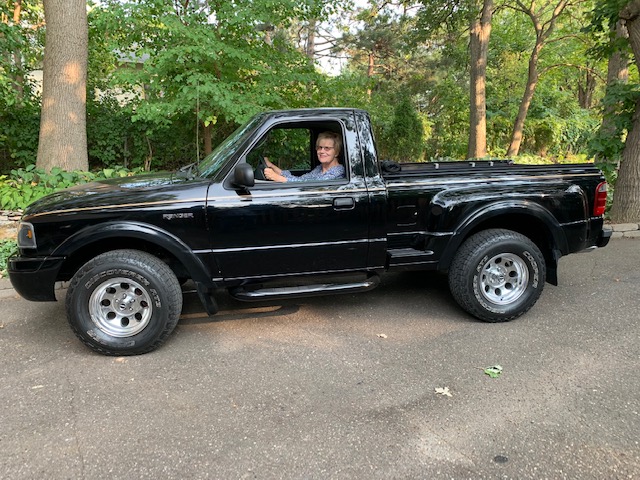

Actually this explains a lot. Thank you. I've been wondering about this ever since I bought the Ranger. But I should also say, that mine is the Edge package which looks as though it was intended for off road driving. Those looks are a little deceiving, however. Mine does not have 4WD. So I've made a few minor changes to improve handling on the street, lowering the rear end by 1" and the front by 3/4." Sometimes what Ford has given us can be improved or adapted to serve our purposes better.
Improving on Ford is something of a hobby for me. After 20 years on the road, mine is overdue for new shocks. I will be looking around for aftermarket options which might upgrade stock.
It looks good! Since you're not 4x4 with it, lowering for the street makes sense. It lowers the c/g which can only be good, for street, as long as nothing is rubbing you should be good to go.

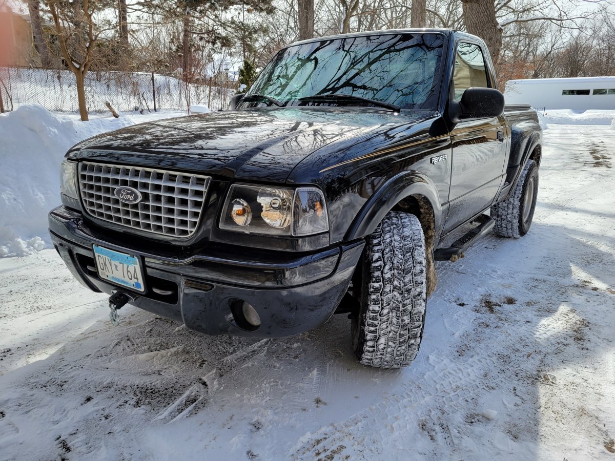

I might be wrong but these tires seem to be larger than stock. The fronts especially stick out further even than the factory fender flares.

I just checked. For what it's worth, the original tire for that era was P225/70R15
225/70-15 was typical for 4 cylinder, or coil spring front suspension. and they were usually on 6" wheels.
torsion bar & 4wd had bigger tires and wider wheels.
what does the door sticker say?
Oh I don't know. I don't have a door sticker. The door jamb had been repainted. I don't really care anyway. The OEM tire size I mentioned above was for torsion bars and XLTs.
I got new wheels and bigger tires when I bought it two years ago.
yes on mine the 265/75R15 steel belted with white outline letters is oem, Ford says so ("Research Team") also Oasis report says so.
I'm missing door sticker too and have all the info to re-create it except the spring codes and front/rear grosses and reserves.
But the spare is 235/75R15 that's normal, the larger tire doesn't fit under the truck, at least Ford says so also people have confirmed this.
What size is your spare that -might- infer what was oem size on your truck since chances are if they were oem 225's they wouldn't have put a 235 under neath, it'd be a 225 (probably) if that was oem size.
