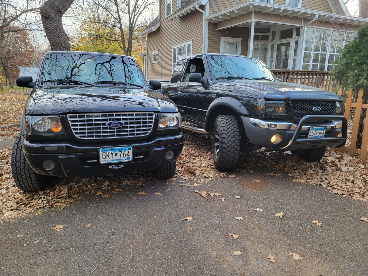

A 31" tire will fit in the spare carrier but only just. As the tread wears down over time, it's fitting better. But 31" with the cable lift style carrier is going to be the maximum you can stuff under there.
31" is good. In fact, it seems that many forum members are very happy with that number. I chose a smaller number only because my wife complained about how difficult it was for her to climb on board.
My friend chose to go in an entirely different direction, purchasing 17" wheels with spacers and Falken tires so big that they barely clear the fender wells. If I remember correctly he had to crank the torsion bars a little and also had to get out the grinder. I really like the look. It really grabs the road. The downside is that he cannot store a spare inside the well under the bed. So he's got a stock tire spare and 4WD.
My truck is raised but looks small next to his.
Opinions vary on tire and wheel size. I think 31" is the perfect balance for the size of the Ranger as far as a "big" tire for general and off road driving but that is my opinion. If I still had the '98, I would have stuck to the factory 225/70R14 as close possible since it was a four banger with RWD. Everyone is different and has different tastes and uses for their trucks. I prefer the utilitarian side of things, others want a bit of show in some form or another.
Now, I did have to "lift" the truck to get those 31" tires to work. In 2008, they dropped the ride height of the 4X4 and Edge style trucks for better fuel economy numbers. I had to install torsion keys and axle blocks from a 2007 Ranger to eliminate most of the rubbing issues. Otherwise, 30" would have been the limit or just put up with the tires rubbing on the fender liners.

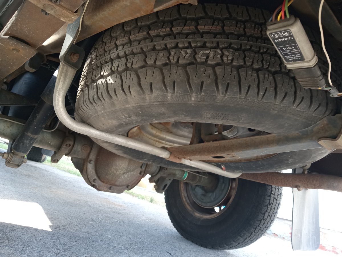

Turns out there's no way a 31" tire will fit in my tire carrier. Right now it has the oem 225/75(or 70)R15. The transverse carrier bar is actually pressing into the sidewall of the tire. So the issue isn't so much the diameter of the spare (I have a little clearance there), it's the width of the tire; a 265/75R15 would never fit, not even close. So the shop manual is right, there's a max size that fits and it's in there now.
Trying to change to 265 would add about 1.5" in section width so no way it would fit (diameter aside) because there's already less than zero clearance.
Even if you slotted the transverse bar (or make a new bigger one)
Another question about tires...
to add width there, it looks like at the rear mount there's nothing you could do to make it bigger absent altering something. It probably could be done but it would take messing with it, assuming it's possible.
That was why I was careful to specify the cable winch carrier. I suspected the type shown above would have a tighter fit but was not sure about that and I didn't know what year that style of carrier stopped being used.
So, it seems if you are going to go with a full service spare, you will need to bed mount or tailgate mount it.
