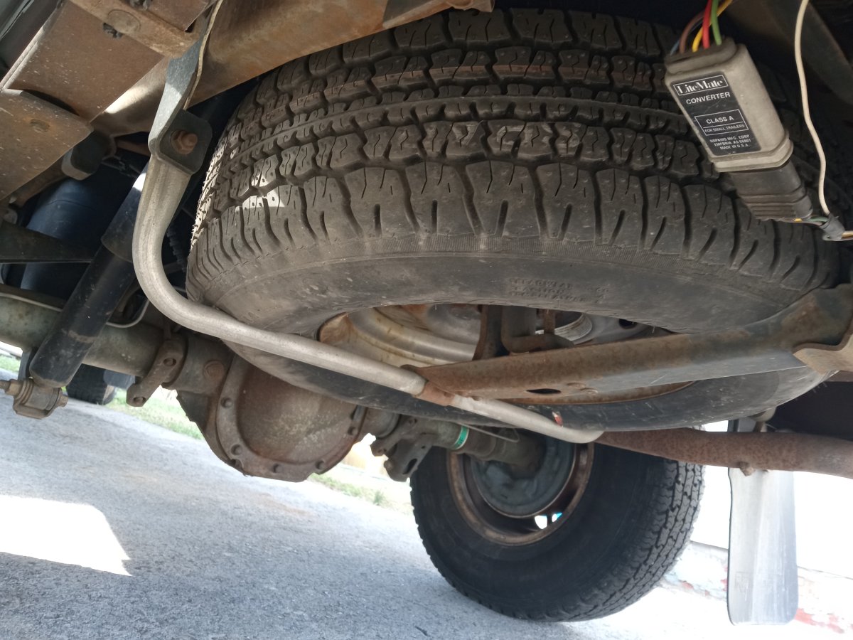

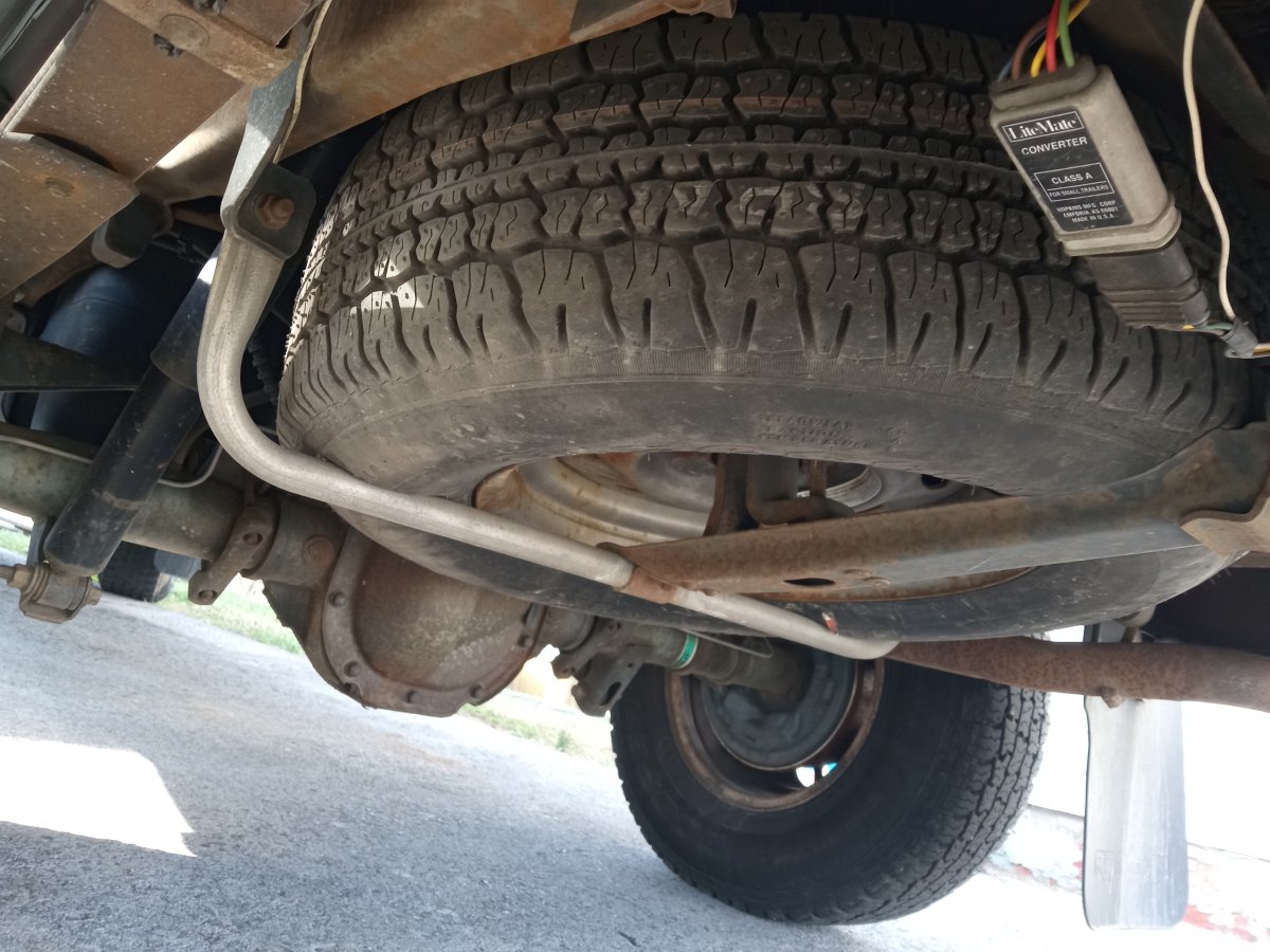

Turns out there's no way a 31" tire will fit in my tire carrier. Right now it has the oem 225/75(or 70)R15. The transverse carrier bar is actually pressing into the sidewall of the tire. So the issue isn't so much the diameter of the spare (I have a little clearance there), it's the width of the tire; a 265/75R15 would never fit, not even close. So the shop manual is right, there's a max size that fits and it's in there now.
Trying to change to 265 would add about 1.5" in section width so no way it would fit (diameter aside) because there's already less than zero clearance.
Even if you slotted the transverse bar (or make a new bigger one)View attachment 89394 to add width there, it looks like at the rear mount there's nothing you could do to make it bigger absent altering something. It probably could be done but it would take messing with it, assuming it's possible.

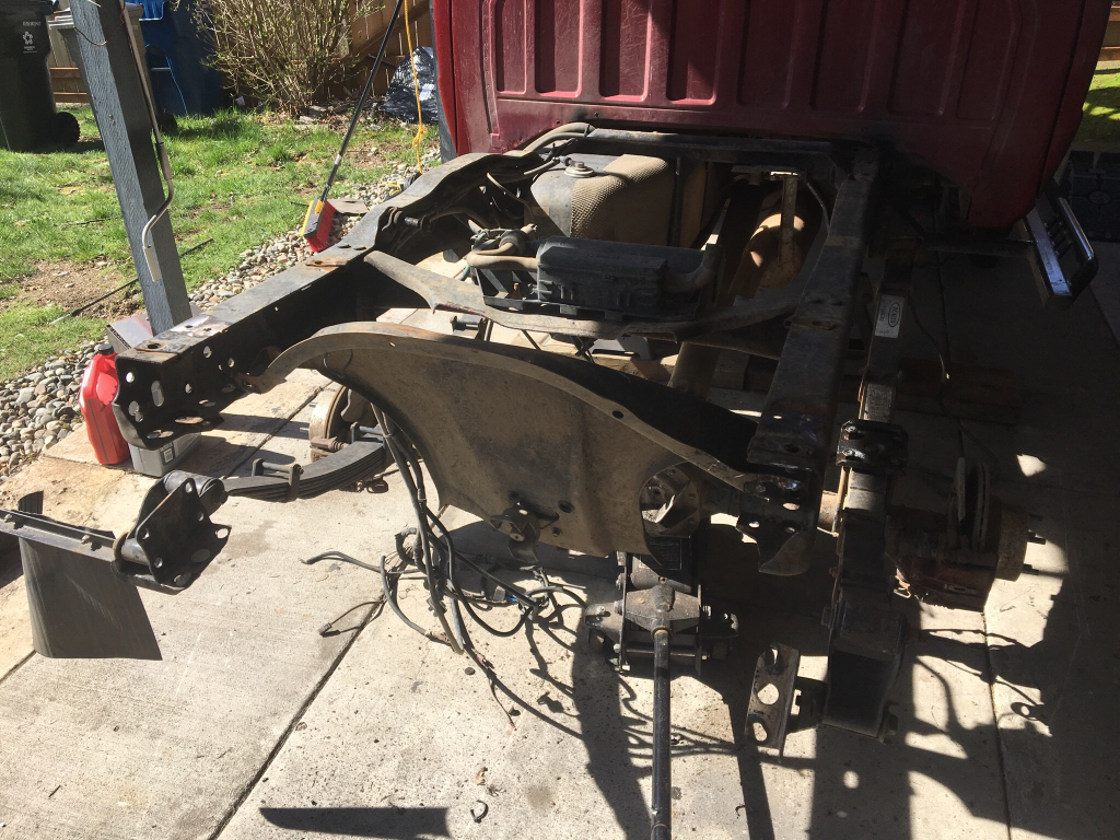

Here are a couple internet pictures to give you an idea what the newer carrier looks like. It mounts to the frame cross members and may require pulling the bed to install one. Assuming the cross members are shaped the same.
Carrier removed
Another question about tires...
Unit installed
Illustrated drawing of the unit installed (not great but gets the idea across)
This is a wonderful idea! I would have clicked LIKE more than once. We just might take this project on come summer. It's not hard to pull the bed and make the mod.

Considering this it is riveted into the frame and replaces trhe rear crossmember from the previous generation, I would say that it is an integral part of the frame. At least as much so as any other frame crossmember. To swap it into an earlier model you're looking at replacing the rear crossmember, possibly the one forward of that too. I don't know differences in frame dimensions. I know the lengths changed, but I din;t know about the width or height. I don't think that they changed in any way that would maatter for this, but it is possible that one would have to narrow the winch assembly to fit. Definitely doable, and I'm pretty certain that I've seen it done before.

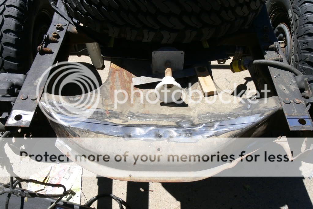

At my largest I ran a 32x11.5R15 and still had the factory spare under the rear. If you're calling his tires ginormous on 17" wheels I think they'd be a fair bit bigger than my 32s were. I don't care how much cutting you do, it isn't likely to fit under the bed with the stock frame rails in place.
Your buddy's best bet will be a tailgate carrier or in bed carrier, either way it's probably going to be custom. Find a way to secure it, pack around it, and be prepared to move everything to get to it. Or, if you need the whole bed space, leave the spare at home and commit to carrying a patch kit and a air compressor, heck that's what a lot of vehicles come with instead of a spare now. That's probably what I'll be doing with one or two of mine in the future, namely the 85 Ranger and the 68 F-100.
235 85 16 can fit under my ranger gen 1 chassis. but that is with all custom crossmembers. thats like 31 inches if i am remembering right....and it barely fits....i only did that because i had to have all of the bed space...and was running the road on 33's.

that should allow the 31-32 in tire. the later frame iirc is 1 inch wider inside at the bottom of the rails then the gen 1 chassis.
i have full width axles and my shocks are on the outside of the frame.
I tried a 31 in my stock carrier, no way it would fit.

I was looking at the pic of my spare, and looks to me like there's still printing on the tread - I think it was never used (or it's a new replacement which I kind of doubt). I would have thought the rubber would not last 25 years? It looks ok I don't see cracks etc in it.
If it was never used maybe I want to make sure I can get it out of there if I ever needed it.
