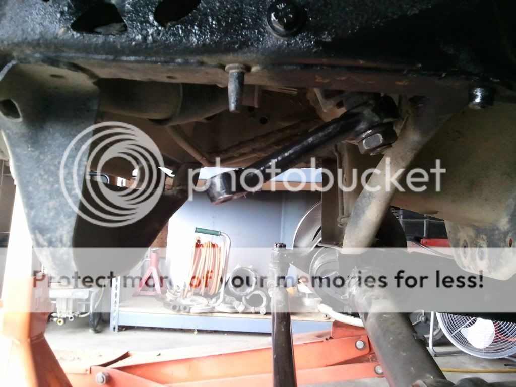

Well my drop pitman arm is about 6" center to center not 7" like I thought. All I could find at the U-Pull-It was 5.5 and 6 , straight or like 2" drop . Ended up getting a 6" straight one . Then drilled it out to 5/8" and reamed for the draglink end.

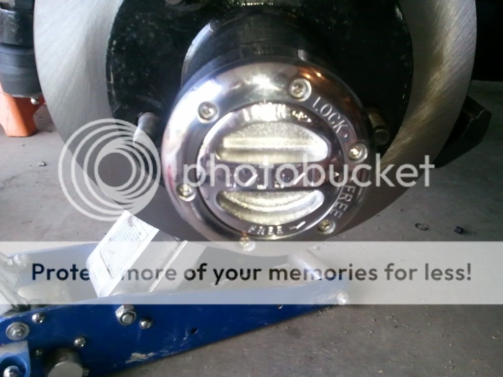

Added some Mile Marker Premium Stainless lockouts.

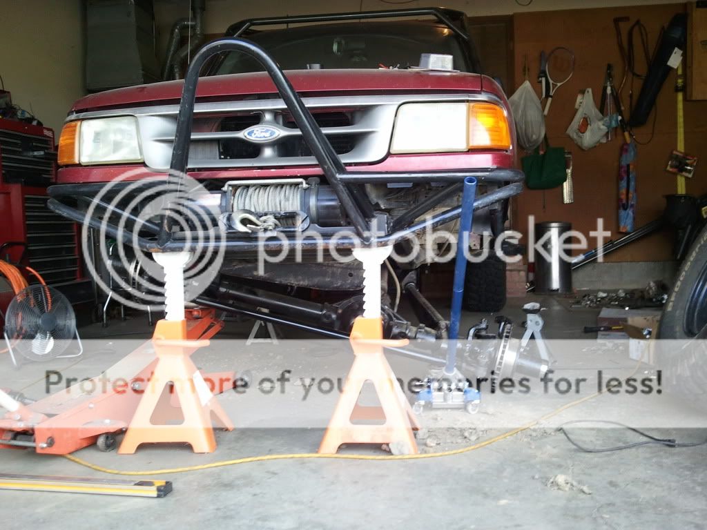

Some more posing:D

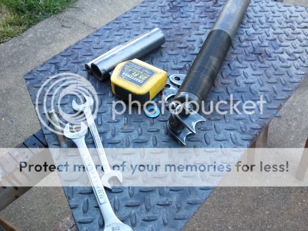

Man I'm slowing down, couldn't even get the coilovers mounted. Got it ready to tack up but still need to reinforce with some more tube and gussets. Also need to make the mounts for the bottoms.

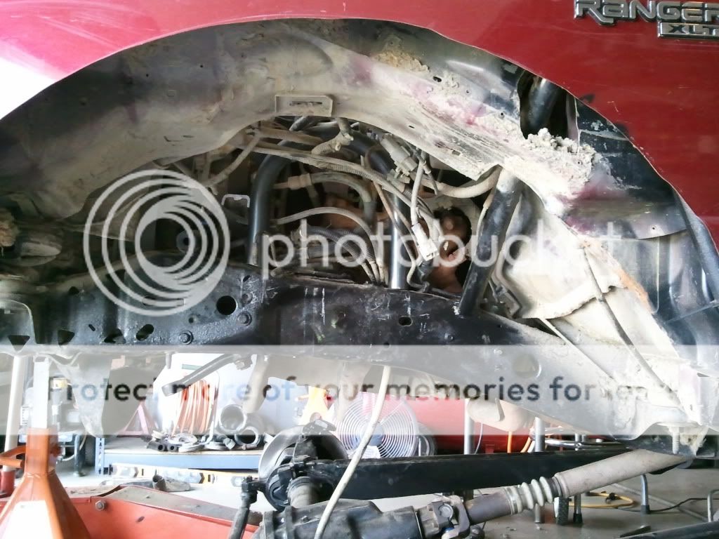

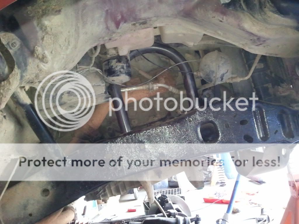

There are pics in the build thread. It was easier than i thought it was going to be. Just relocated the battery and intake. If you really want me to, i will snap some pics for you today after work
