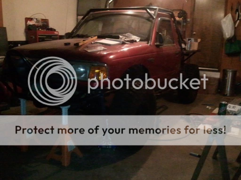

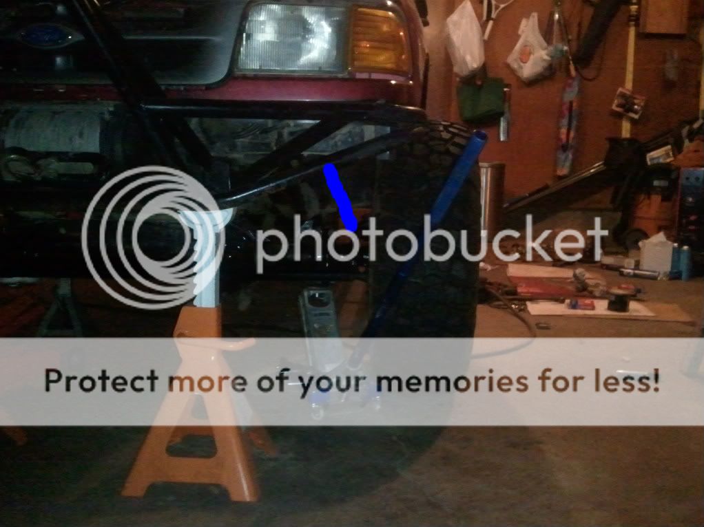

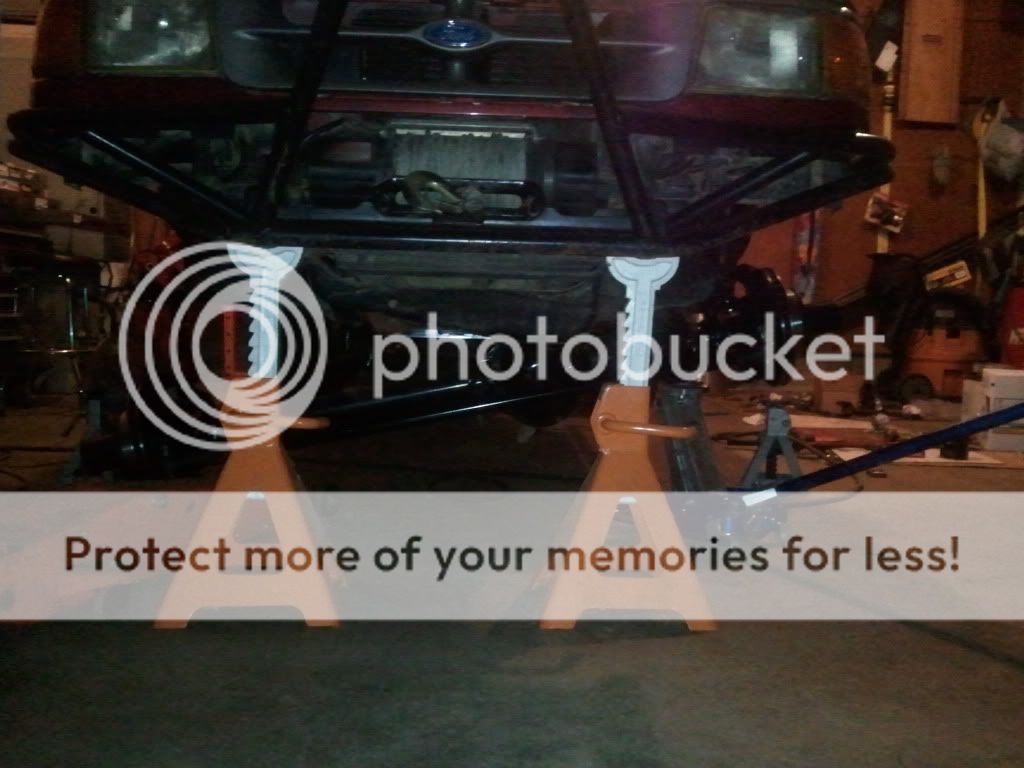

Measured some more tonight and looks like 20-25 degrees in off the inner c would work well. But might need higher rate springs .
Also looks like it needs a longer pitman arm with less drop. Anybody know what years f150 and bronco pitman arms work on a ranger box?

Lookin good. Any particular reason for the relatively large angle? Do you need them to be tipped in that much to clear the tire at full articulation?
Everything I have seen says lean them in at least 15 and 20-25 would give me a little more travel.

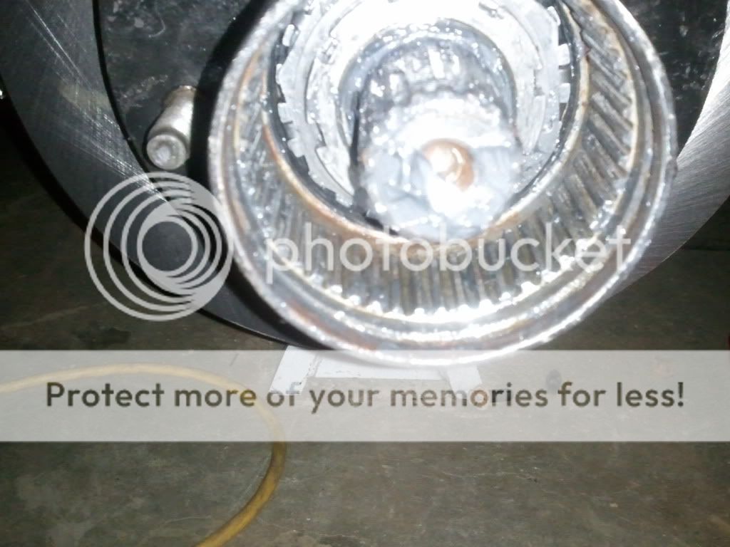

Not much got done tonight. Breather hooked up and a new spicer 5-153x (1310) u-joint got installed.
