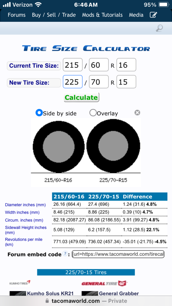

unless your jumping the truck, bouncing off curbs or concrete parking stops I doubt your steel wheels are bent. Ive had issues with the stock escape wheels (alloy) holding air over time so I bought 4 new steel rims that were normally meant to be the spare on the gen 1’s. They hold air fine. The biggest advantage you get from a alloy wheel is heat transfer from the brakes. My ‘94 2.3 2wd performs best with 225/70/15’s and is running a 4.10 rear end, Ive ran 235/75/15’s and it is noticeably lower on power with them, 21 mpg is the best Ive seen but im fine with that. Right now Im running fwd hhr rims with spacers/adaptors that correct for the positive offset, size is 215/60/16 which is just a little smaller diameter than the 225/70/15’s. Im only running them because I had them and that car is no longer on the road. Spent around $120 on the adapter/spacers. By the time you spend on everything (tires/rims/adaptors) that would of bought quite a bit of fuel. My winter wheels are horribly ugly.
