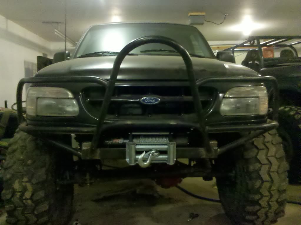

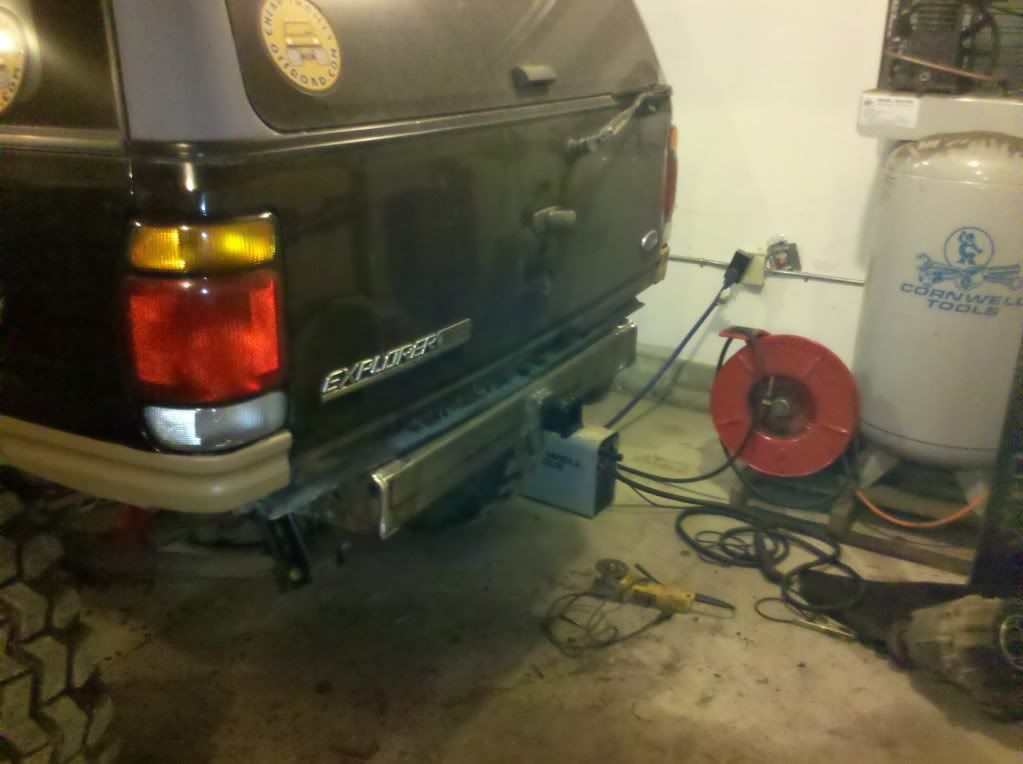

It was brought back to me for some bumper/recovery point work....
I beleive they want to add some tube work off the new crossmember to protect the corners eventually

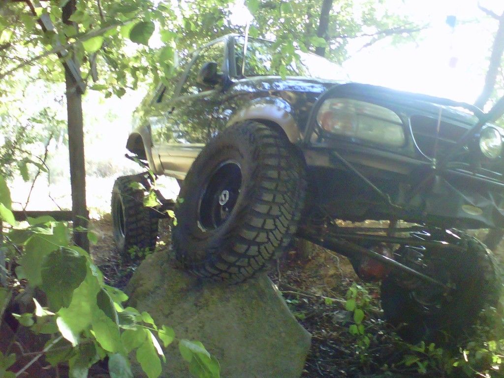

Hoping to get some video/action shots of it today finally lol.

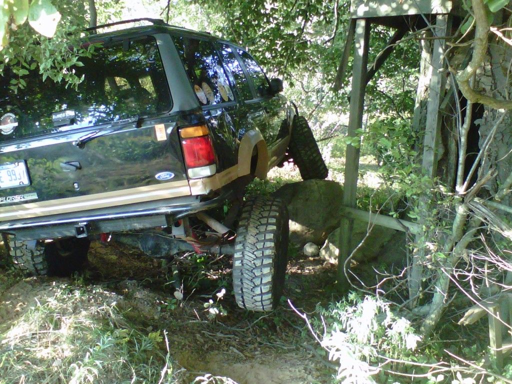

I picked this rig up a little while ago. here's it fully flexed out

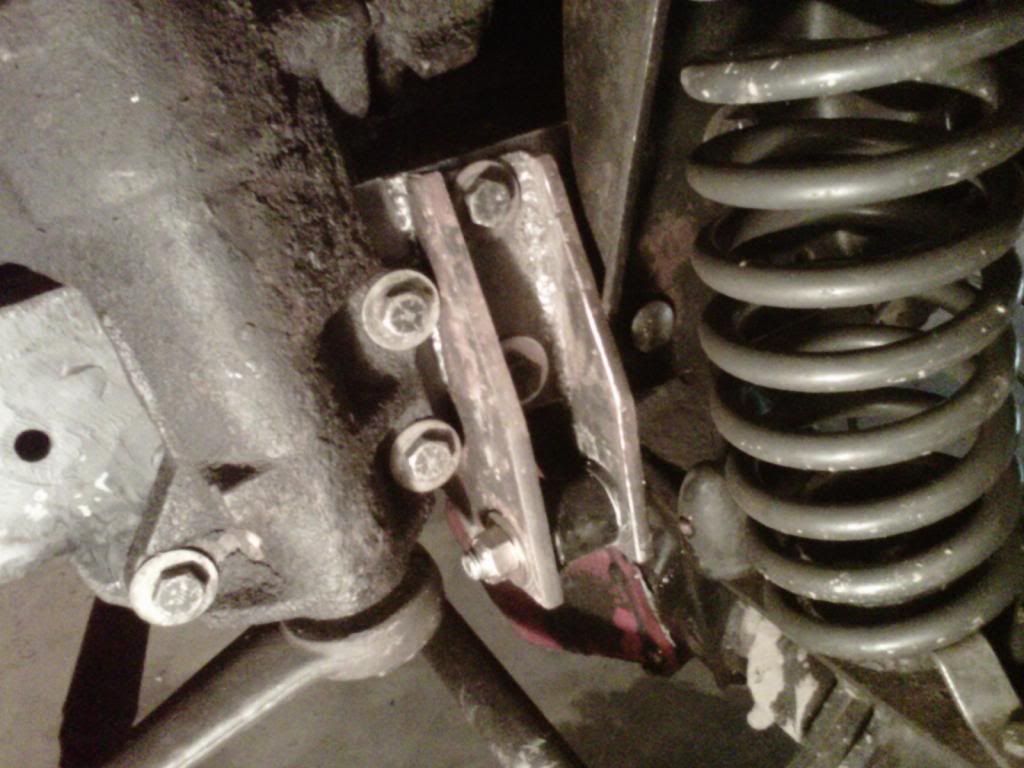

did some up grades to the explorer the past couple of months. i broke the steering gear box so when i had it off realized that the frame was starting to buckle on the drivers side. i ended up plating both sides of the frame rail.

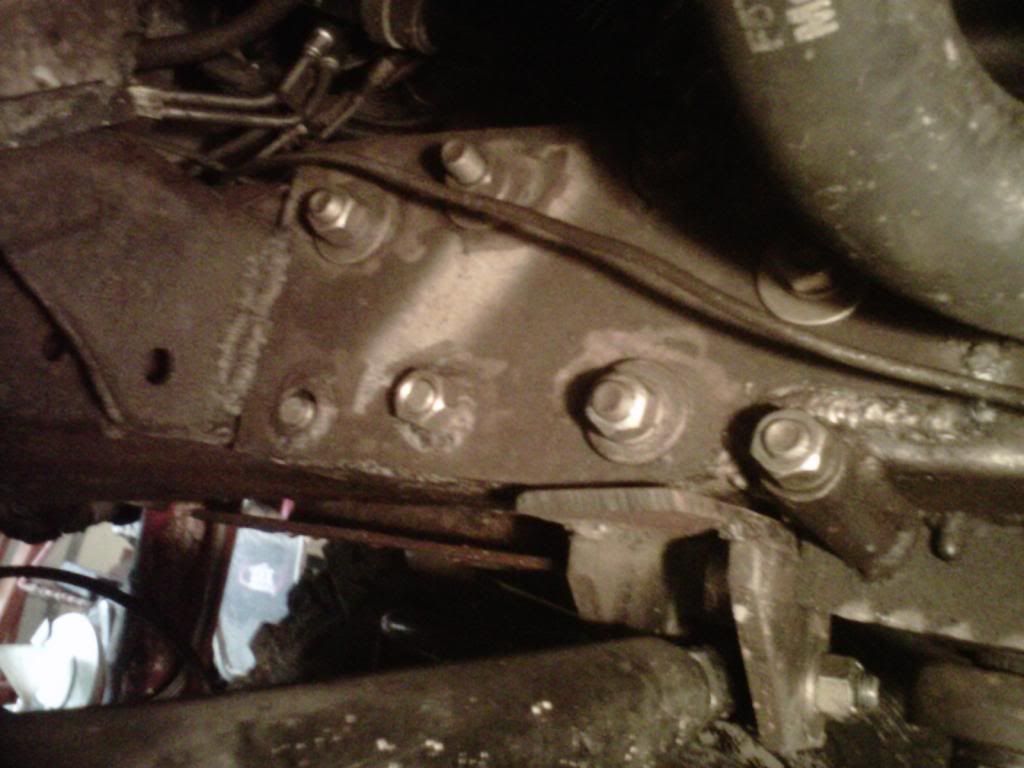

The factory track bar mount was cracking so i built a new one- shouldn't have a problem its 3/16 plate. also had to get an adjustable track bar

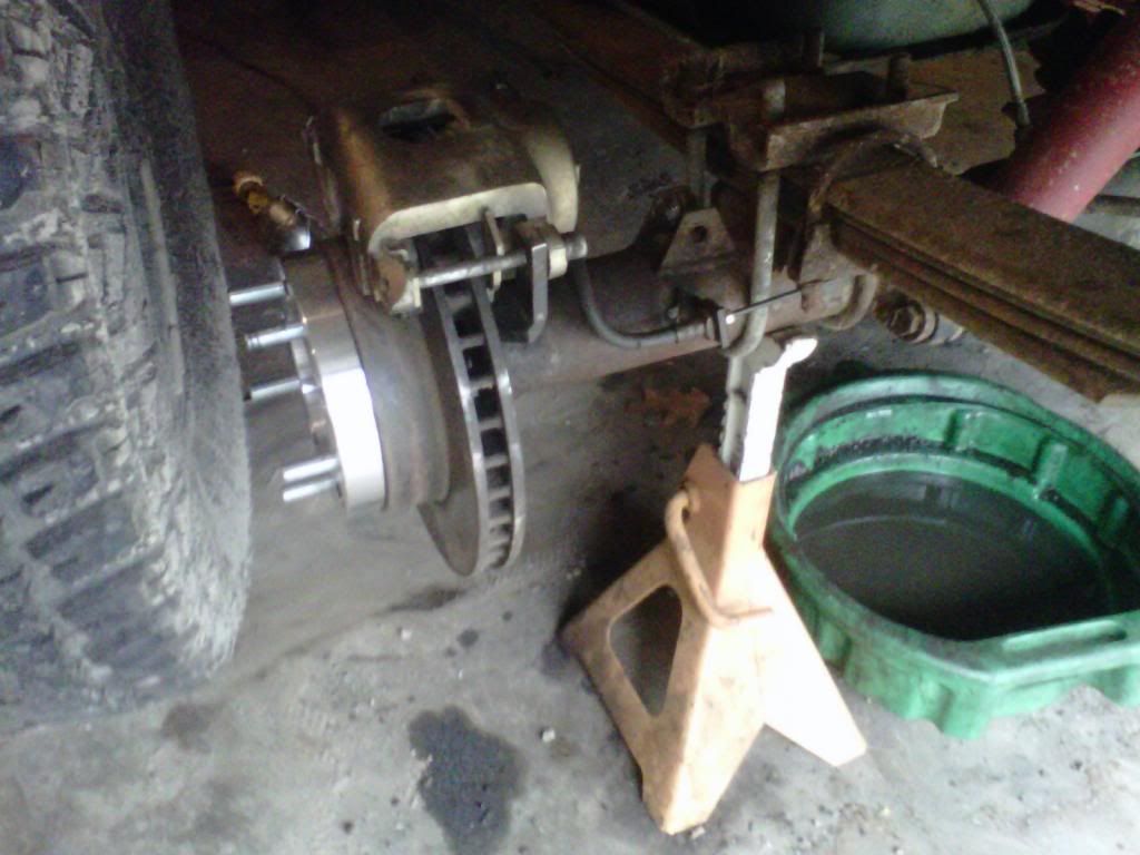

some how the 9 inch 3rd member cracked and it was blowing oil out of it so i bought a axle that was set up the same for spool and gears and swapped it in. it had disc brakes so i also installed them. i had to get one inch wheel spacers because of how the wheels were made.
