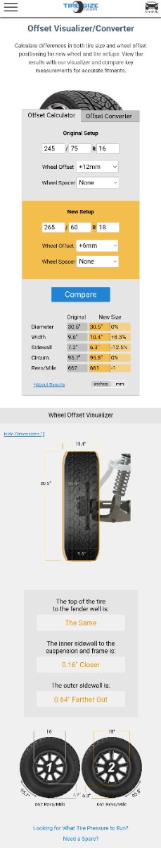

Well, thanks to the tips from yall, I'm starting to learn some crap.
Found these, which are the exact look I like:
Price point sucks. However, according to the internet:
Another annoying wheel/tire discussion
Apparently this would allow me to run a 265x60R18, which is close to what I already have, just wider. There also seems to be a *ton* of options for 18in rims as well.
