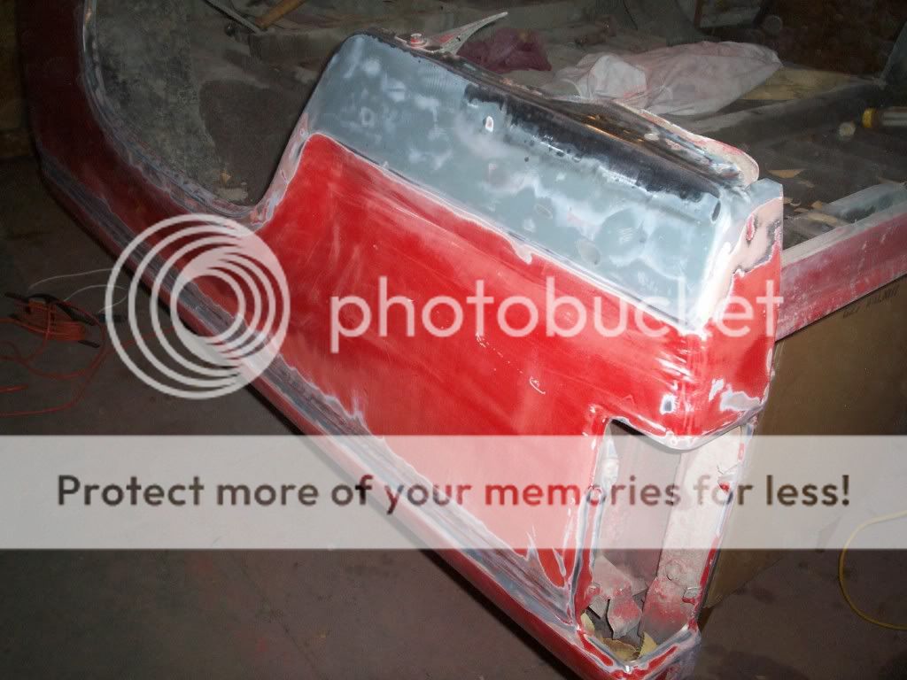

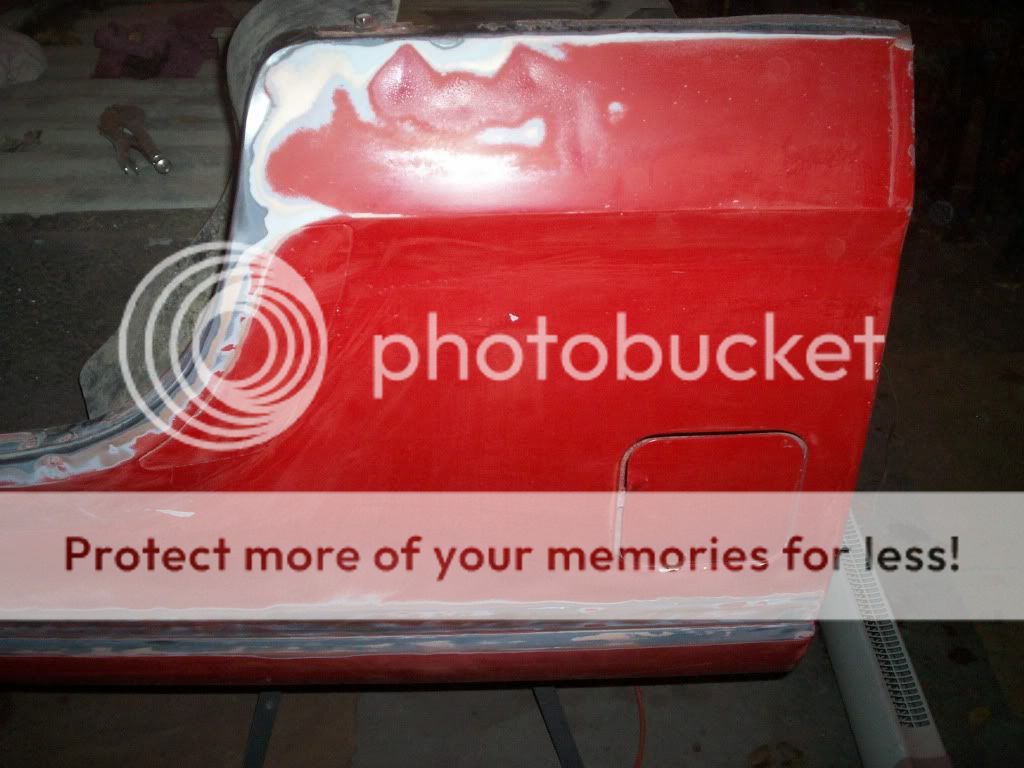

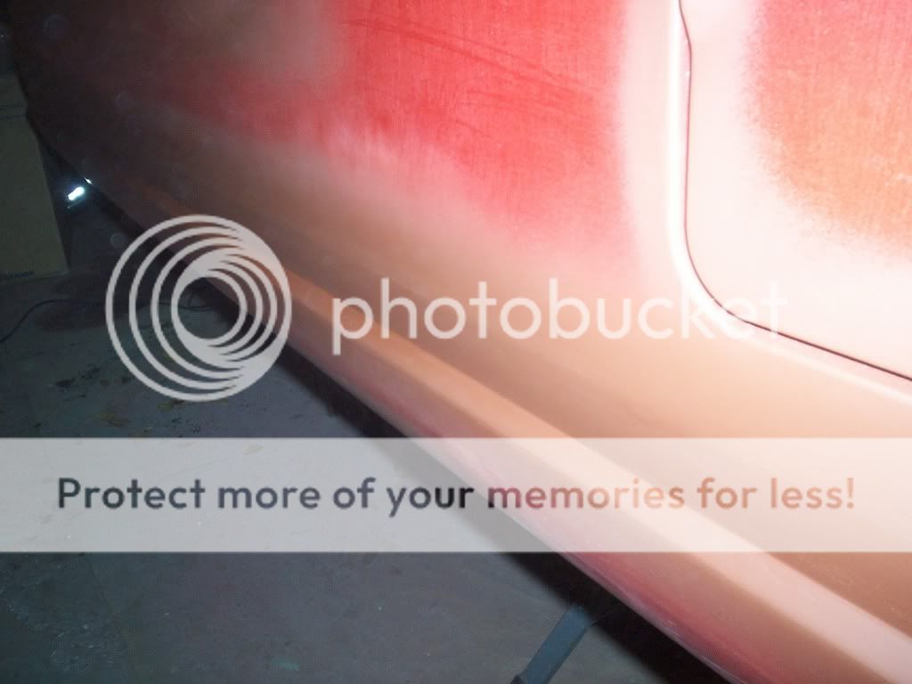

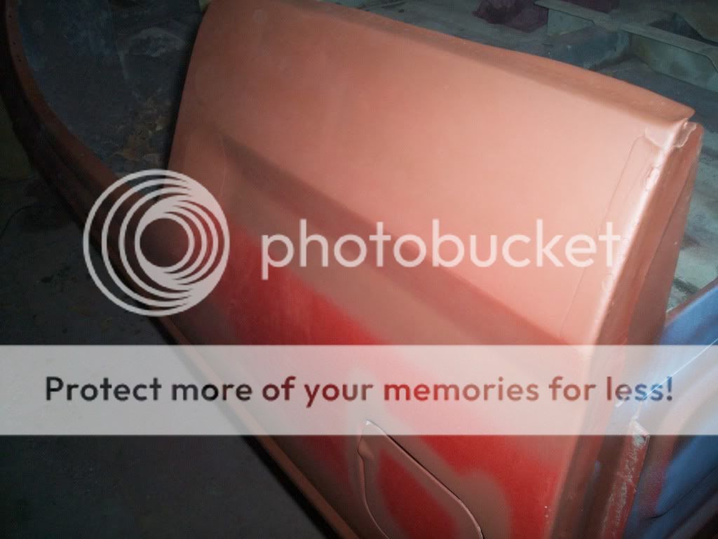

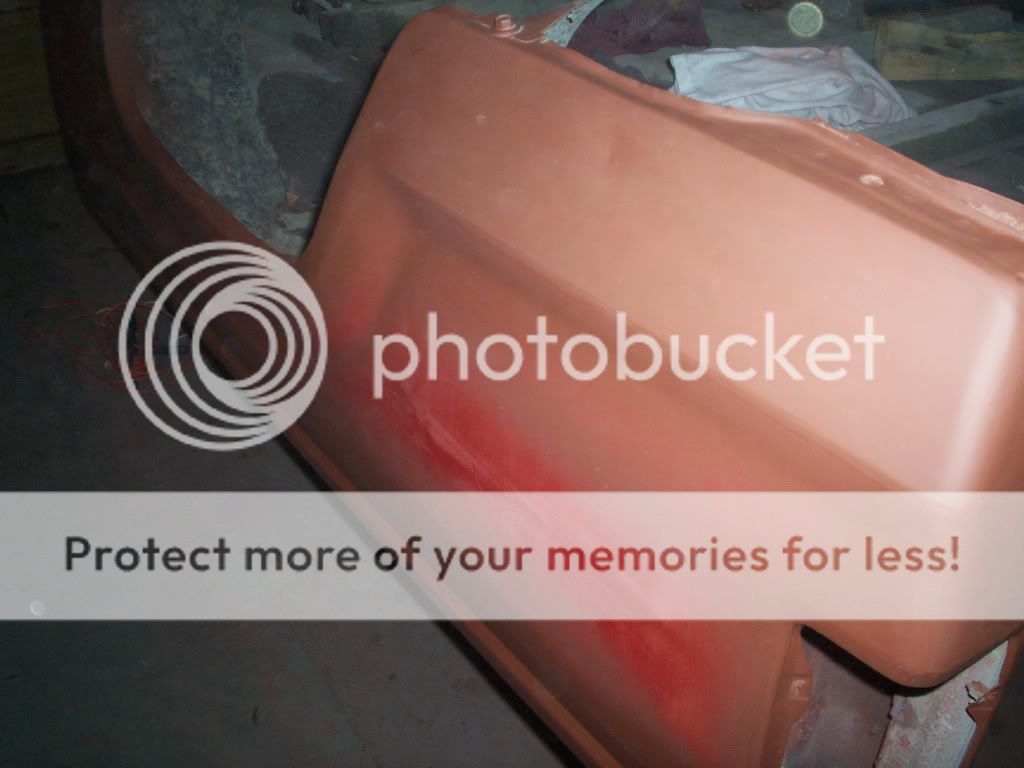

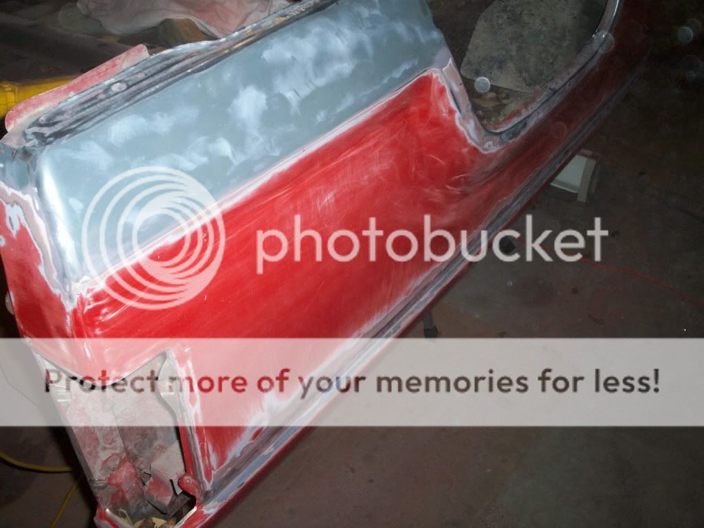

Well, got around to doing some painting today. Brought the box into the garage, sanded 'er down (by hand, I might add!) and slung some paint. All rattle can work, too. So far, just pictures of finished sanding and primer, none of the process nor finished paint product as it is still drying.
This good enough prep work, multi?!

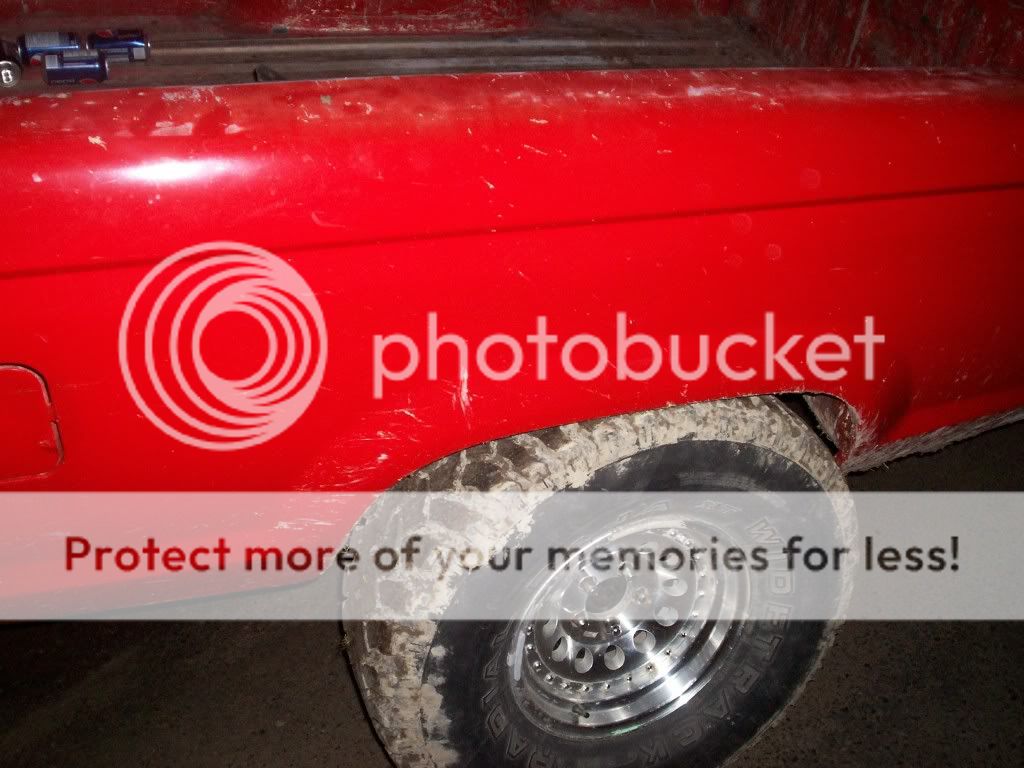

Now some primer action!
Will have some finished product pictures up today or tomorrow. Love having a heater in the garage, and nice mild weather!
you might want to go back over a couple spots, there is a i can see too of the clear protective decals that you painted over, might want to peel the sticker off :P
Yeah, I left those on there, just roughed 'em up and painted over them. With no mud flaps it kicks up a bunch of rocks and this just helps to prevent rock chips and then corrosion due to rock chips.

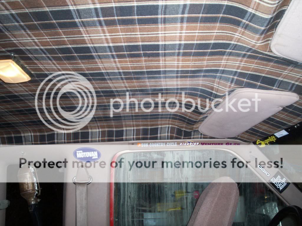

Well, made some headway in the last few days. Got the box painted up (no pictures as of yet), got a couple bucket seats and a center console, got a new rear window in and made my headliner custom! Here's a few pics of some stuff.

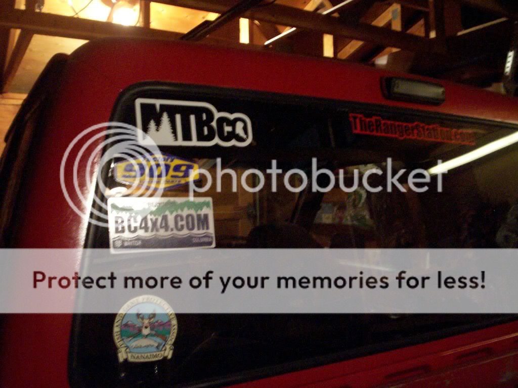

Window:
Yeah, I'm reppin' TRS. =]
Ooooh, custom!
No pictures yet of the buckets and console, as I am in the process of trying to recover the cloth armrest in the same material as the headliner.

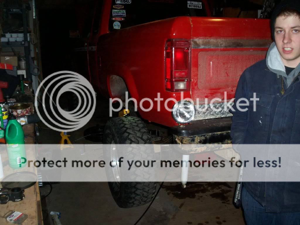

Well... a little update for all you following this... got the truck back together, took it apart again and put in some 4.56 gears! Also had to put the 3" lift block back under the springs to get 'er level. SO much travel now, though! Also swapped in an Explorer 8.8, so let me know what y'all think! Still need to repaint the cab/tailgate. Haha.

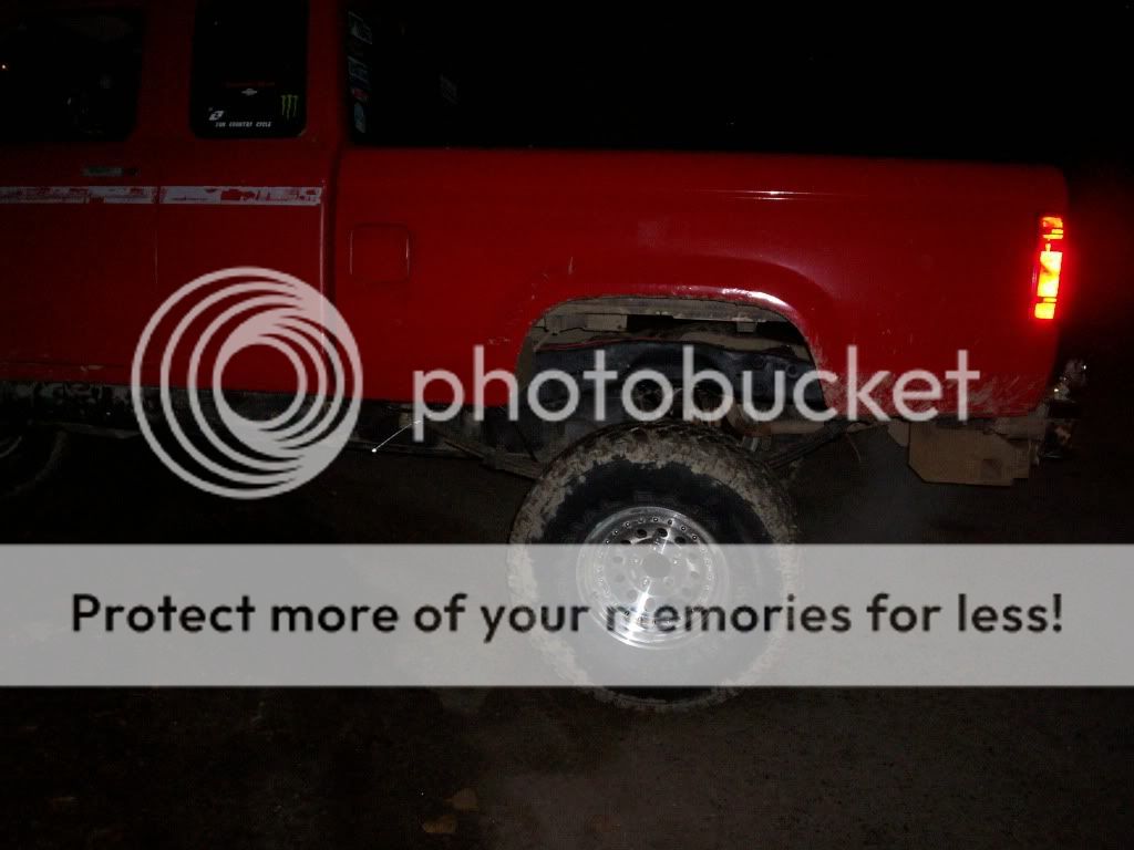

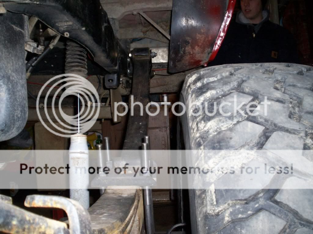

Ran out of jack with a 2' long piece of 6"x6" lumber testing the drop travel! As you can see, it's up almost level with my buddies head. Holy dang! :icon_surprised:
There's what the leaves look like at full-ish droop.
FLEEEEEEXXXXXXXXXXX.
STUUUUUUUUUUUUUUFFFFFFFFFED.

Just scanned through your build looks good. But I was curious to why you decided to go with a the shackle flip instead of leaving it the way they are stock. you could get more lift out of the back with leaving the shackle mount the way they come factory with those longer shackles you have.
Yep, you're right, I could have gotten more lift with the Chev 63" springs for sure. I flipped them mainly due to the amount of drop travel you get from a flipped shackle. With the flipped shackle, you gain more articulation than lift, which is exactly what I was going for. I knew with the long shackle I'd be losing buttloads of lift, which is why I got the springs re-arched. I don't want the truck to be any higher than it is now, so this worked out perfect. Thanks for your input man, I appreciate it!
that is some good info right there i never would of looked at it that way. since both my ranger and the b2 im building had them the other way. Im going to have to look into that now since im working on a new project that im not so much worried about a ton of lift but id like quite a bit of flex.
