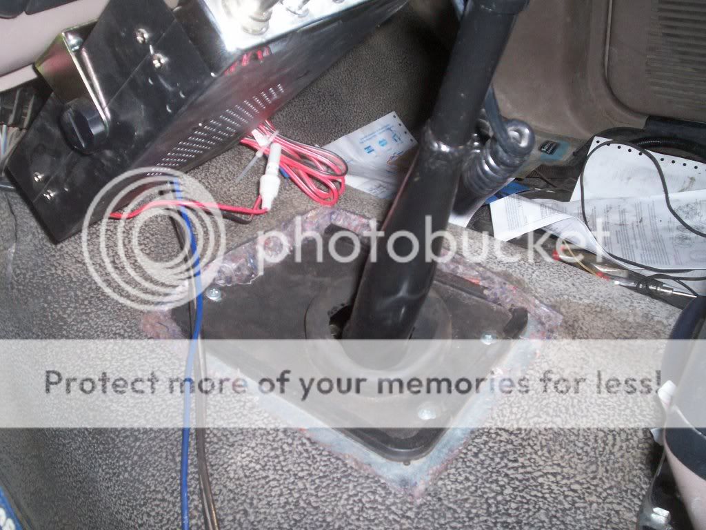

Here is the rough cutout in the floor covering. Got the floor plate from the Explorer I pulled the tranny from. Having a 3" BL, that rubber bit doesn't quite fit proper so I had to trim it. Also, the boot doesn't fit in the stock location, but I'll show you my solution to that when I get it finished!

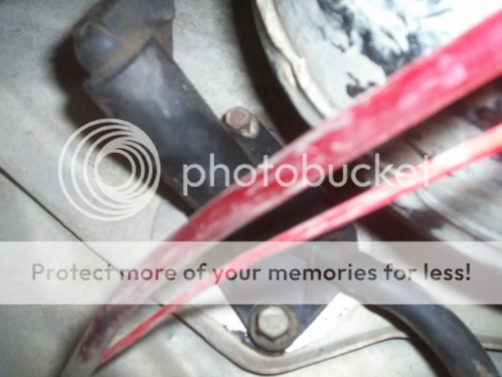

Right here, on an auto rig, there is a little cap covering this hole. Simple. The two bolts are a ROYAL pain to get at... but they are 10mm and I used a buttload of extensions to get at them. Normally the inner fender is in the way, but for some reason mine wasn't and this slid in perfect.

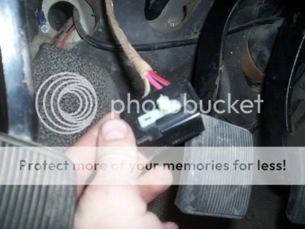

Clutch interlock wiring. This is tucked up in the wire harness just behind the e-brake assembly. Note the cap on mine... that is to bypass the clutch interlock switch as an auto machine doesn't have a clutch. I left this in place as I had to drive w/o a clutch for a few days. :annoyed:

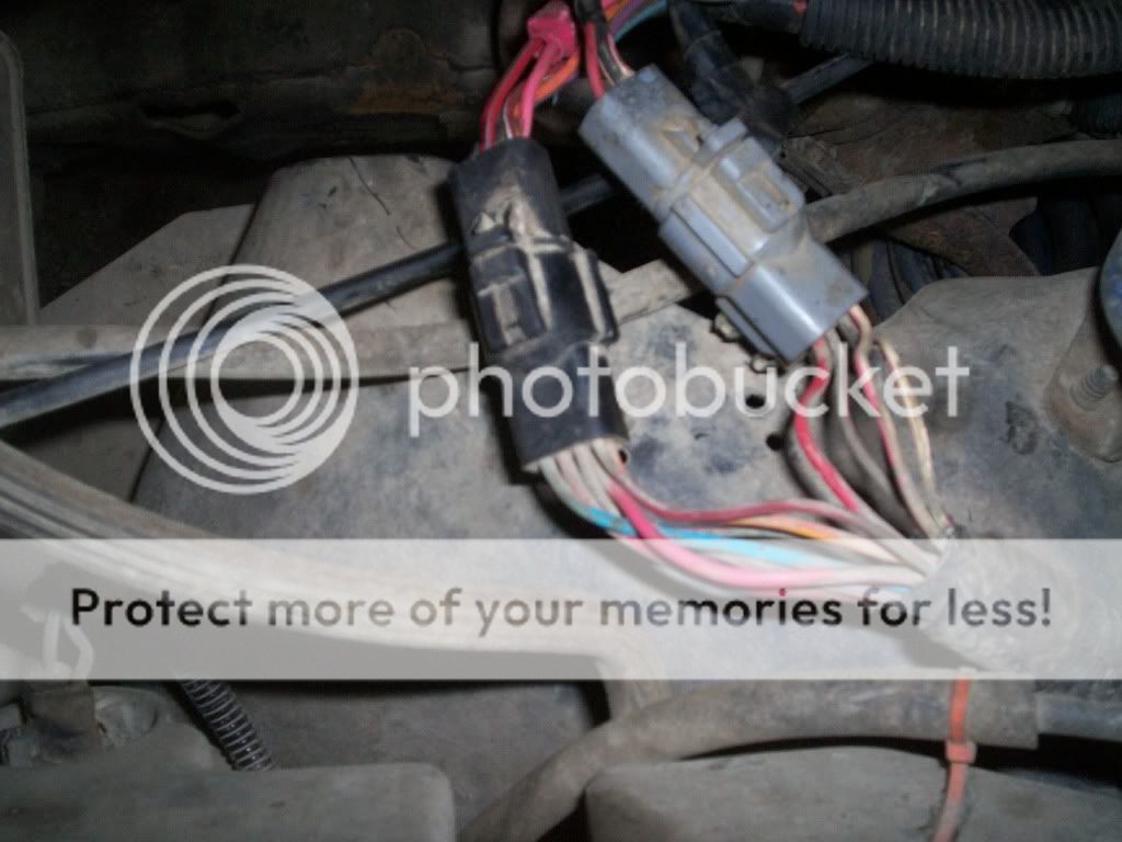

Here's the wiring harness(es) that you'll be looking for to jump the Neutral Safety Switch in order to start your truck after the swap. They are just below the coolant/bug juice jug on the driver side inner fender.

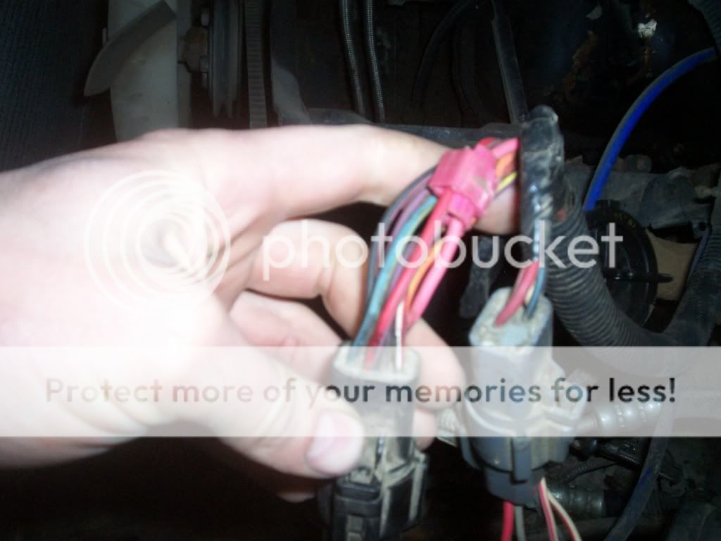

And finally, here's the two wires you need to jump in order to bypass the NSS and start your truck. Simple! Red and light blue wire jumps to the solid pink wire!

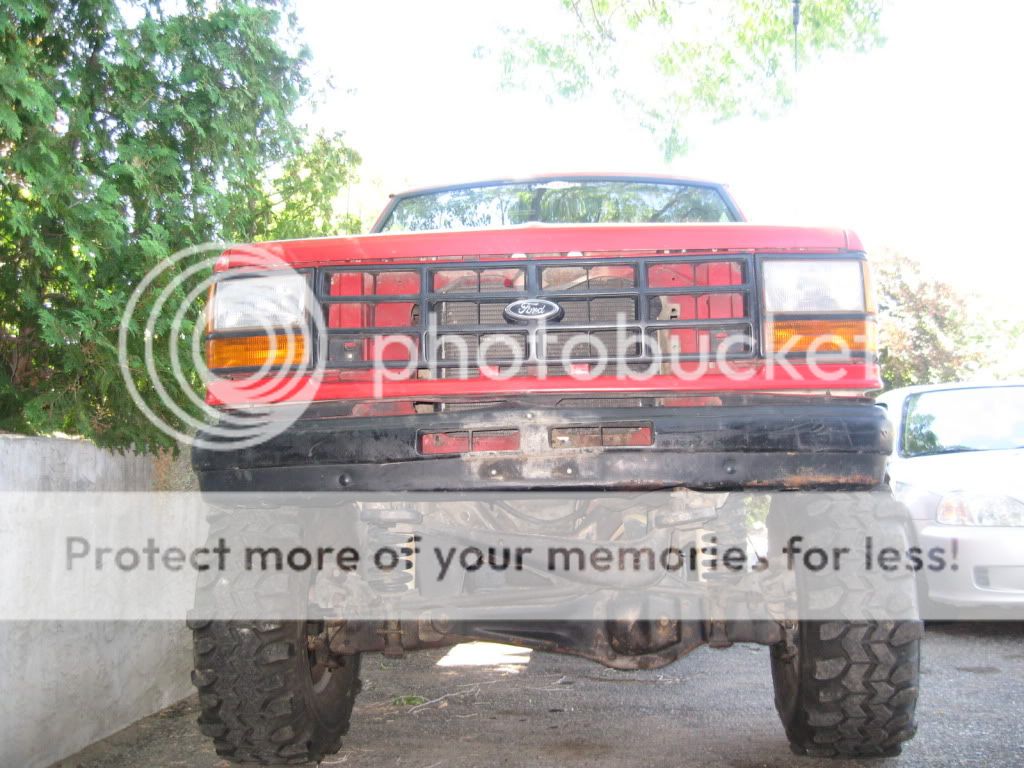

Got a couple new pics... new tires minus one... got my spare Baja Claw on 'er... stupid nails. :annoyed:
Andres629's 92 build
niceeee....i love me some swampers
They are awesome! Can't believe I waited so long to get some. My next set will be LTB's I think.
