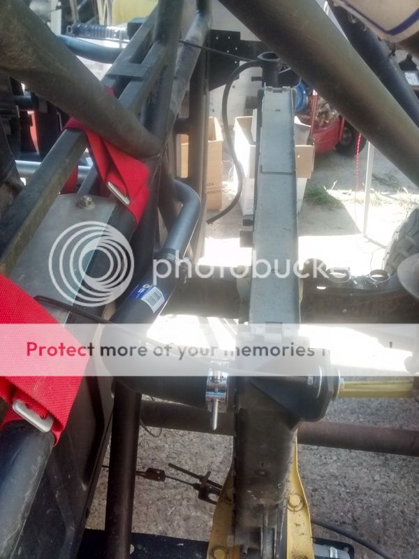

Here is the final rad position I chose. I put a fairly hard 3/8" strip of rubber between the rad and the cross-member. I then screwed the bottom of the rad to the cross-member to hold it from moving. I then used a couple of long "bolts" that are used to hold wire drums together. I bent the end and threaded it thru a hole then connected the end to the rad Still to come is a piece that will connect the side of the rad tanks to the frame, hopefully preventing the rad from moving up or down while going over jumps or when landing. The rad I took out of the front has a noticable bow along the bottom, because it was supported at the tanks only.;

Here's the modified thermostat housing with a wheel rim inflation air valve at the top. This is to get rid of trapped air as this is the highest point at the front of the truck. These work great, I've used one in the heater hose fill cap ever since I first r+r'd the motor on this truck years ago. They are rated to 65 psi. I use it for pressure testing before I fill with rad fluid. I found leaks at every joint...glad I did this instead of losing fluid.;

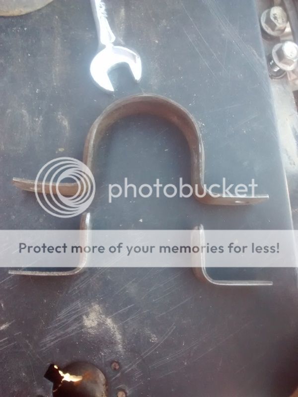

Some brackets I modified to hold the tubes from rattling in the firewall holes I drilled. I use hose-clamps to hold them to the tube and screw the clamp to the firewall;

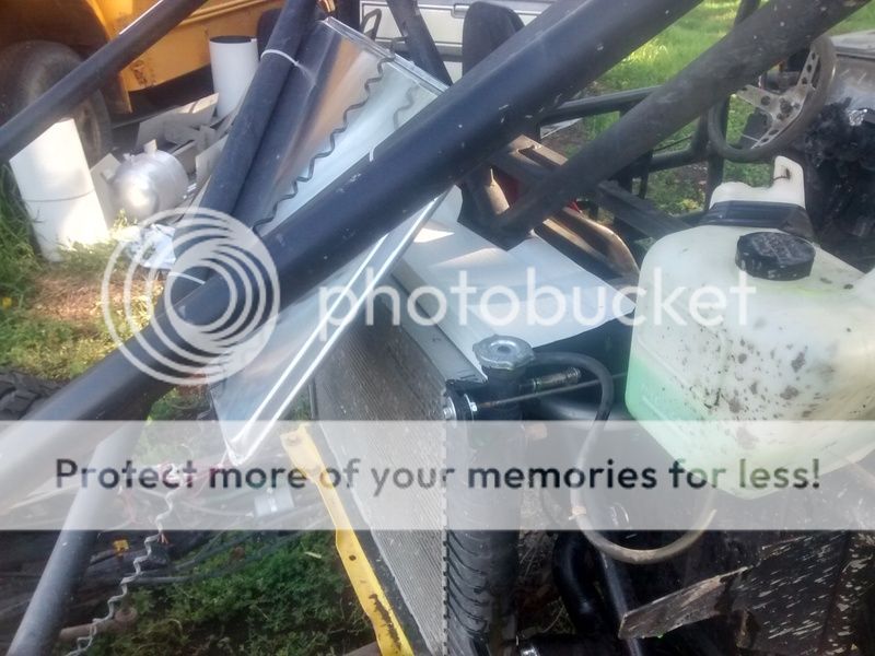

Still to do is mount the overflow tank, fabricate a shroud and mount electric fans and associated wiring and switches.
I haywired the overflow tank temporarily. Got the fans mounted. Its been holding 14 psi for the last 1/2 hour. Things are looking up. If I can get it back together there's a race I can enter this weekend. Wish me luck....

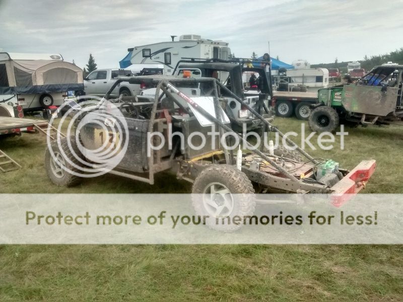

A few pics of the truck;

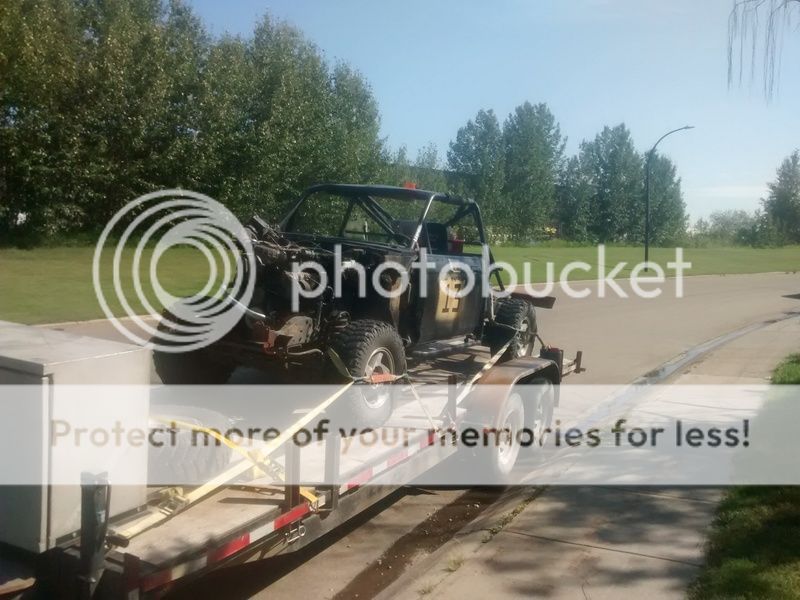

On the trailer;

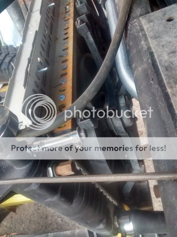

Got the fans installed. These are the ones I was using with the chrysler rad I had in the front previously;
alwaysFlOoReD's race truck
Used some battery hold down pieces;
And the finished product, well, finished for this race. I have the fans pulling towards the cab. I watched mythbusters awhile back and they showed how the airflow circled down behind the cab. I'm trying to use that to feed the rad. I blocked the top airspace between the rad and cab with some flashing, and then used a cookie sheet attached the the roll cage down bars to help direct airflow to in front of the rad.;
Later I'll fabricate some more ducting to direct the airflow a little better and to help protact the rad from wheel flung mud. At the same time I'll build it to protect myself from the same mud that hits my left shoulder and helmet.
